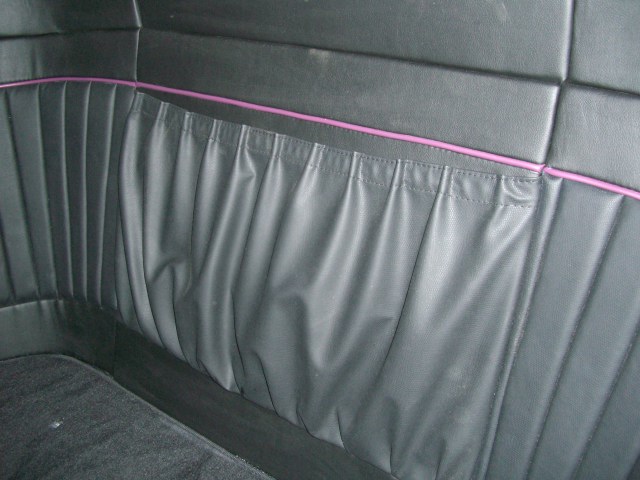

  11. brady1929
    Joined: Sep 30, 2006
    Posts: 9,274
    brady1929
  12. Thanks I will do my own looks killer.
