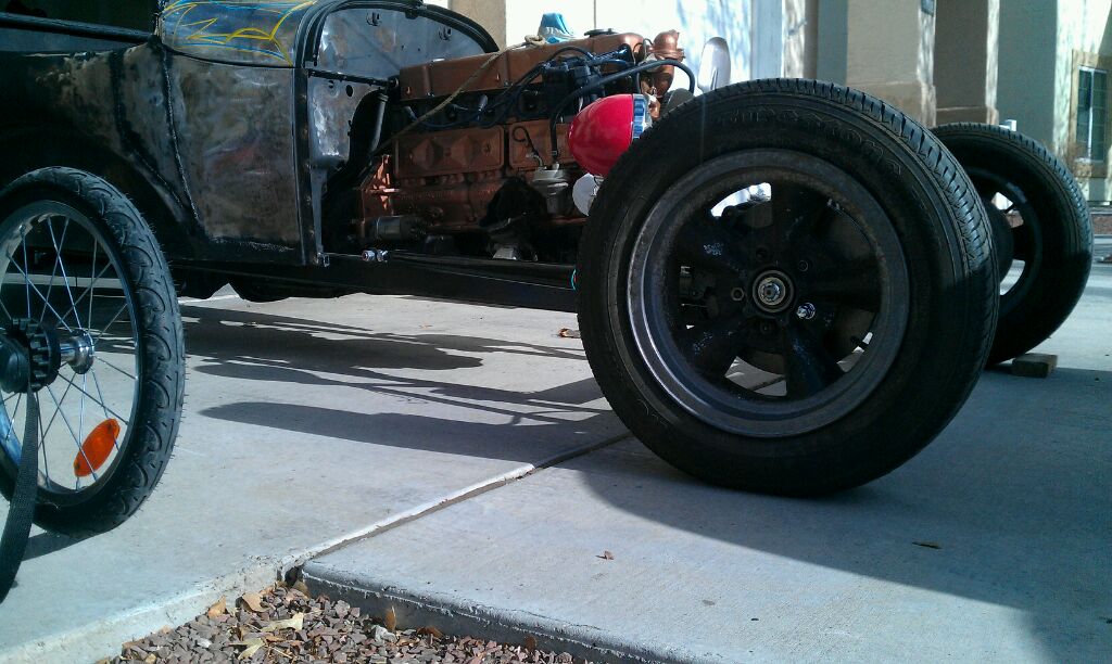

  6. powmia
    Joined: Oct 4, 2009
    Posts: 126
    powmia
    I think I'm good on clearance now...making mounts isn't the most fun but it looks better.

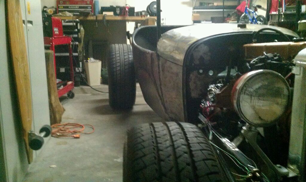

  7. powmia
    Joined: Oct 4, 2009
    Posts: 126
    powmia
    Sent from my DROID device using the TJJ mobile app

    My two cents your going to have carb. problems enless you are going to bring up the back
  9. The pan looks better now, but check where your fan will be. I had to go electric because the fan was higher than my radiator

    I like it. I even like the rake on the body in the first pictures. A couple of things can make it or break it though. Make it ugly or look right. First the windshield has to lean back some. Strait up or forward is ugly. Second the headlights need to be pretty much in line with the grill shell. Too far forward Ugly. Too far back Ugly. Details, Ugly or right. Well you asked.
    Hopefully I'm the only UGLY thing in the picture.
  11. powmia
    Joined: Oct 4, 2009
    Posts: 126
    powmia
    Thanks for the responses guys! The trans will be coming up another inch and a half to solve the carb problems. I will be doing an electric fan, any suggestions on the slimmest one out there? And Steel Rebel, good point, definitely going for the right amount of ugly...still trying to figure out the windshield situation, right now the posts are just 1x1 steel tubing, so with the right stantions they will be leaning back, and now that I raised the motor the headlights will be mounted in line with the radiator. Tear it apart guys thats what Im looking for, it's my first scratch build and I want it done right. Thanks.

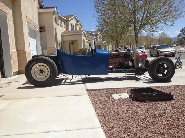

  12. powmia
    Joined: Oct 4, 2009
    Posts: 126
    powmia
    Fixed dome stuff today. Finished the trans mount, raised the radiator and moved the head lights forward. Also made the body mounts so here's how its going to sit.

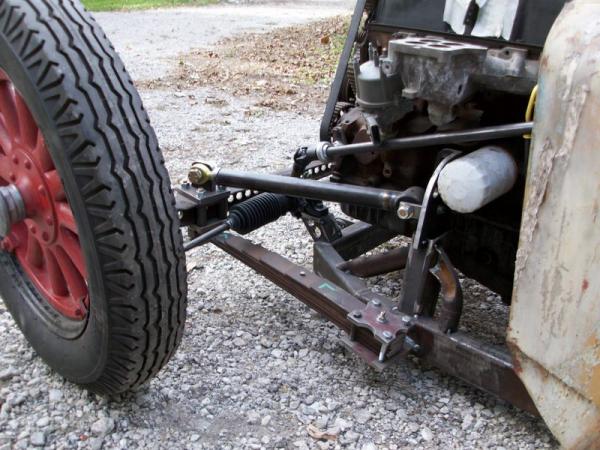

  14. kennkat
    Joined: Aug 25, 2011
    Posts: 1,385
    kennkat
    I completely agree, This has been mentioned in a couple of posts here. One guy mentioned that he had a single long "third link" that went "right up to the transmission..." This is WELL WORTH doing... It works WELL. Back in about '76 0r '77 I worked on a 1963 Chevy NHRA Super Stocker that among other "Stocker Trix" (like Mopar 8 3/4 side, spider gears & axles in the GM 10 bolt) Had this type of "Traction Bar" and it worked well... Although that was a "coil car' I know of one Very Notable 1960's Willys Pickup Gasser that ran Quarter Elliptics & the Long single traction bar/"Torque Arm" suspension. The Red '41 Willys that Panella's ran quite successfully with that exact setup...
    Edited -(the Panella truck had "watts linkage" to locate the Pont diff) Ken

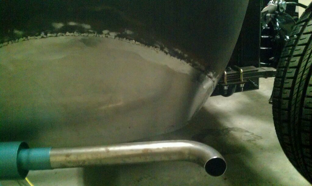

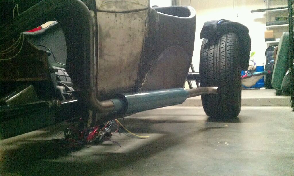

    It's been a while since I updated the build. Filled in the wheel wells, fast Eddie here in albuquerque does killer sheetmetal work. The exhaust is getting close, just need one bend made. Cranked the inline for the first time though! Wiring is done, just floors, driveshaft steering and brakes left! And still under 5k on the build...it can be done.
