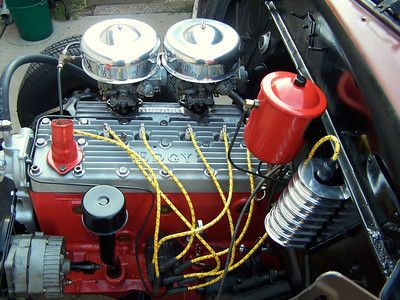

    If you decide to keep it, your flat 6 will be as safe & reliable as you make it. Mine is capable of going anywhere, anytime. It's no race car by any stretch, but it pulls up the mountains roads just fine. It'll cruise on the highway with & past traffic.
    I had the cam re-ground & tappets re-surfaced, Edgy aluminum head, H.E.I. distributor, Offy twin carb manifold, Langly cast iron header with dual exhaust sporting twin porter steel packs. A T-5 makes a Highway Star out of it.
    I didn't do it all at once, but one piece at a time made it do-able over time. At one point I was going to swap in a later engine, etc., but stuck to the flatty... and I'm glad now that I did!

    Here's one just like mine, but you can see it better since the front body clip is off. Also, I have a heater on my car so it's hard to see the details. Full on Flatty.jpg Full House Flatty.jpg

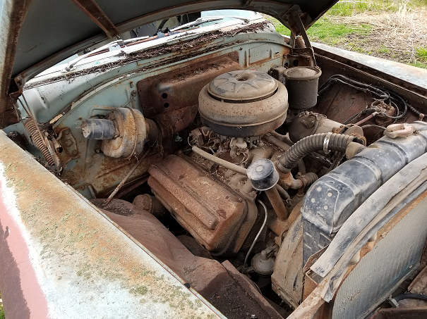

    Here is another picture of my project "Casper". I love this car and can't wait to get it going.

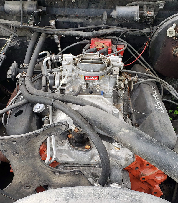

    This is the 360 magnum that was built and put in a Ramcharger for a couple of years. In the process of pulling it out now and will be cleaning it up before install. I just bought a new cam for it and will be pulling the heads off to have them reworked a little before install. I am wanting to find a way to make it look more vintage and would like to use the Cadillac air filter.
    AND this is the motor I want to put in this car some day when I have the money to go through and rebuild it. I am hoping to some day adapt my AX15 to it. Currently this 331 hemi is locked up tighter than a crabs ass and will need a full rebuild. I can't wait to do it but it is probably 10 years down the road.

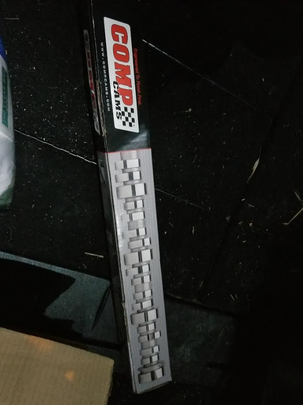

    My new cam came in. It is a custom grind cam for the magnum motor ground on a LA cam core so I can still run a mechanical fuel pump.

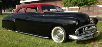

    Well Tony I tackled a Inspiration for you...Sometimes less is more and even as subtle as this looks there is a fair amount of effort getting it there...I will post another in this weeks Art Show but here's one hot off Stogy's Virtual World...

    That is awesome, thank you very much for doing that. I do like the look as far as not getting crazy. I like seeing others vision of the car as it gives me a lot of ideas. You never really see these done so it is super cool to see what you have done.

    Oh I have complete confidence you will get this thing there...and yeah you can throw another roof on it but it loses part of it's identity...That's an option of course but I really like the tweaking of the original Roof in this case...
    The Ugly Duckling turned into a Swan...;)
    I look forward to seeing what the others come up with...Did you check out Rytangs Desoto thread...extreme makover but it just highlights options and your Vintage throwback mind is what governs that...Look forward to your journey with it...
    That Hemi would be a very fitting attachment to this Beauty in the making at some point in its resurrection...
