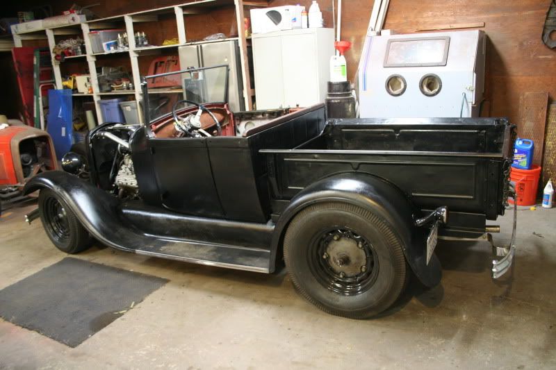

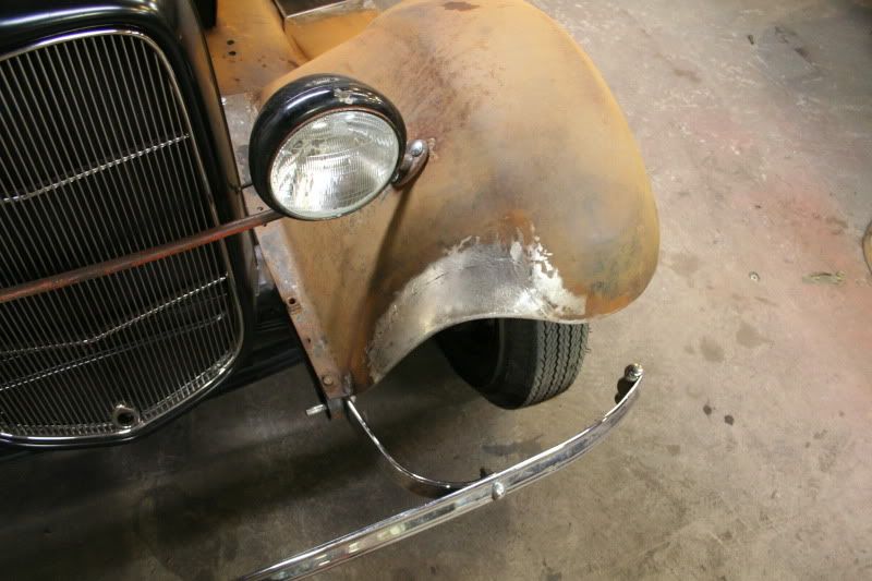

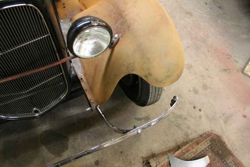

    The latest update is that I gave myself Tendonitis aka "golfers elbow" rolling out the last panels for the trunk area. So I guess I would have "wheelers elbow". I decided against my will to not give myself permanent damage and rest my arm. I used the last couple of weeks to finish up my RPU, and I tried really hard to stay away from the English wheel and little power hammer. I did however make some small filler panels for the 29 rpu fenders. I then found out it takes a very long time for Tendonitis to heal so screw it, I&#8217;m going to start back on the car this week. I received my intake today for the sportscar and it is Awesome!<p>[​IMG]
