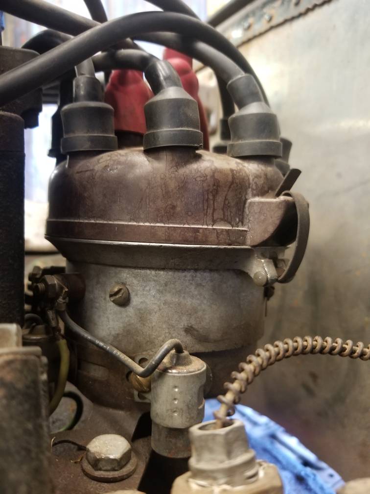

    My luck has run out. A big old crack developed in the cap on the DuCoil I'm running on the 31 Cabriolet. I know how rare they are and I'm hoping that maybe I can talk someone out of useable one. Or two. I'm willing to trade cash, machine work or my soul.....

    Use a small drill bit or a dremel tool and drill along the crack to remove any carbon and fill it with epoxy. We save worse things than that. Even if you had to open up a line all the way through to the outer surface, you could save it.

    An evening of web surfing has me believing I can save this one.

    Yes, no doubt it can be saved this way. Let me know if you'd be interested in a very appropriate epoxy material that you might not run across in the general marketplace. I don't sell it, but I use it in my business to great advantage on many materials. PM for info.

    I went for it last night. Used a tiny little carbide burr in a pencil grinder to vee out the crack and filled it on with regular old slow setting JB weld. I'm going to leave it cure for a couple of days before trying it on the car but it went much better than I expected. The Bakelite is very brittle but didn't seem to mind being ground on. I put quite a bit of epoxy with the reasoning that if some is good, more is better and it shouldn't interfere with rotor travel, plus, I can always grind it back a little if need be. I'll update once 'the glue dries' and hopefully the car doesnt misfire all over the dammed place!

    Just got it all put back together and fired it up. Seems to be working like a champion. I'll road test it tonight or tomorrow and see how it goes.
