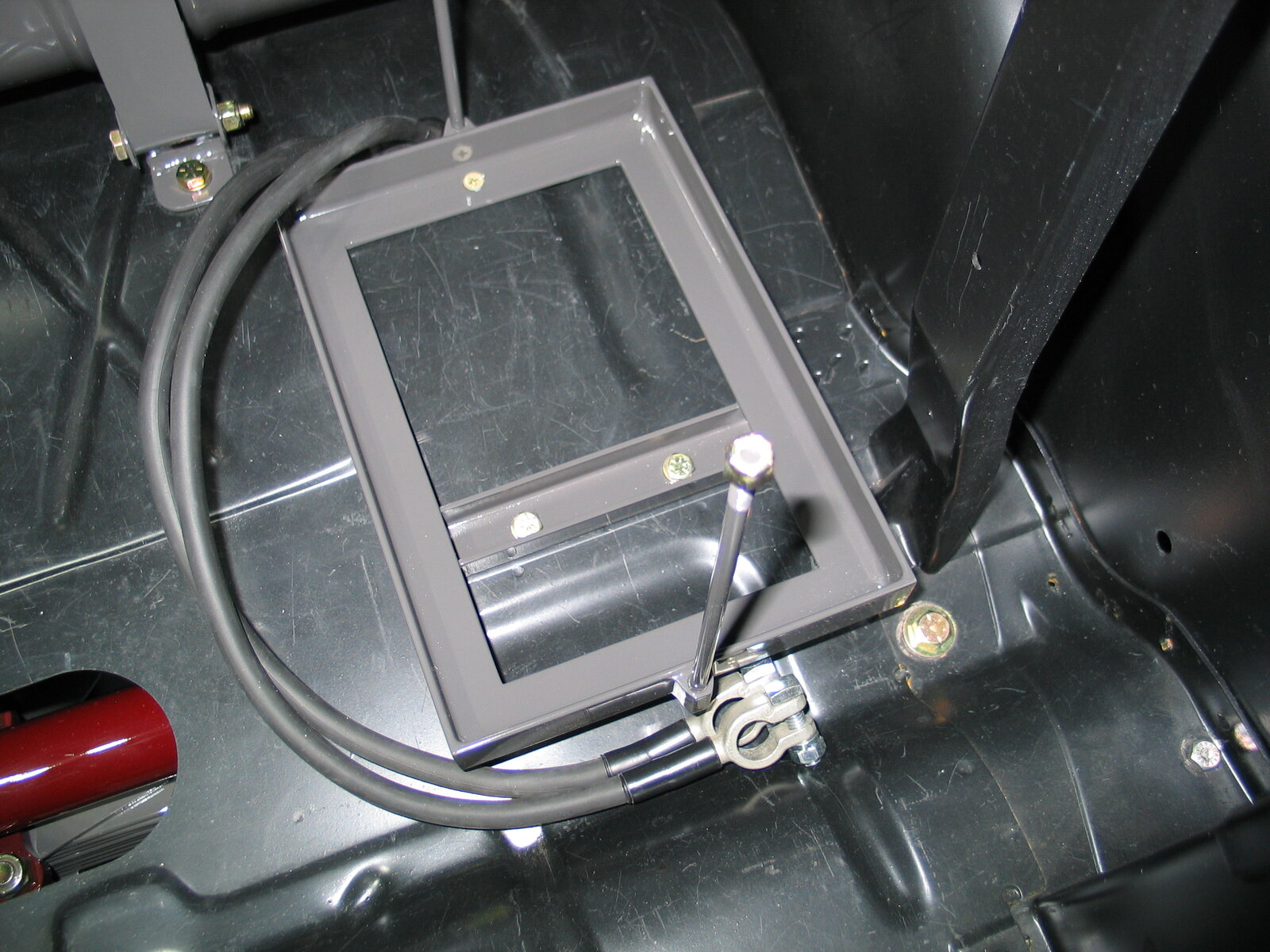

    Battery tray is welded up. Nylon rear frame / body mount installed. Licence plate bracket painted... IMG_4603.JPG IMG_4604.JPG IMG_4594.JPG IMG_4595.JPG IMG_4597.JPG IMG_4598.JPG IMG_4605.JPG IMG_4599.JPG IMG_4601.JPG IMG_4602.JPG

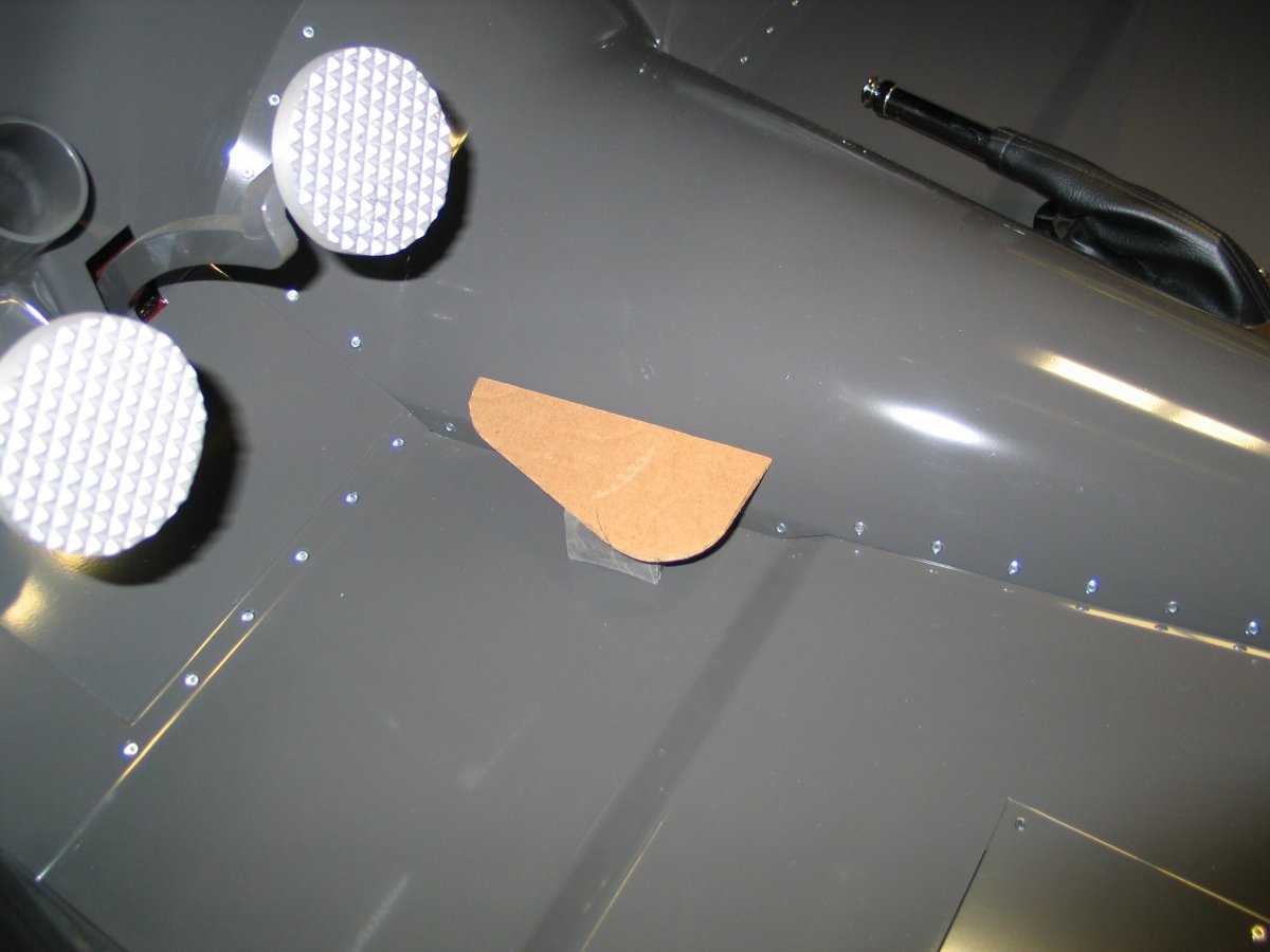

    Wiring is completed and dash is in place. Need to build a platform to sit my foot on to comfortably work the throttle... IMG_4660.JPG IMG_4661.JPG IMG_4665.JPG IMG_4662.JPG IMG_4669.JPG IMG_4673.JPG

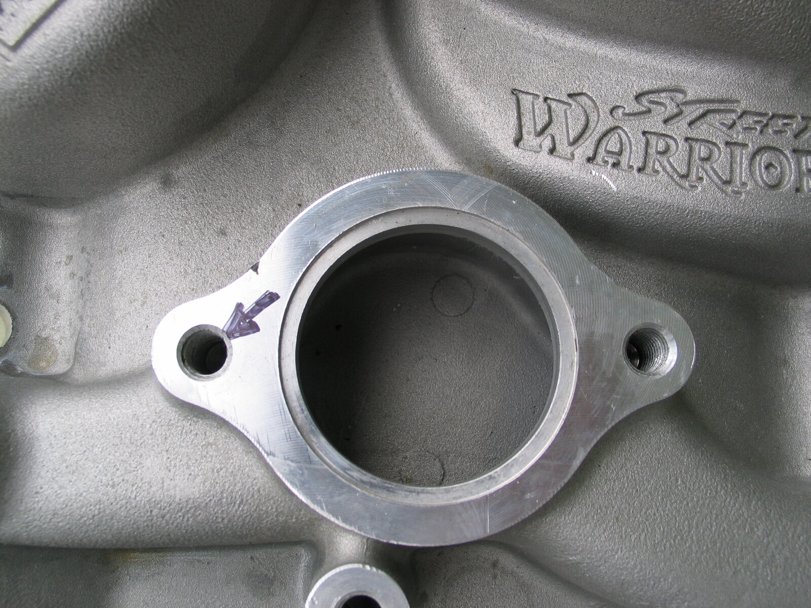

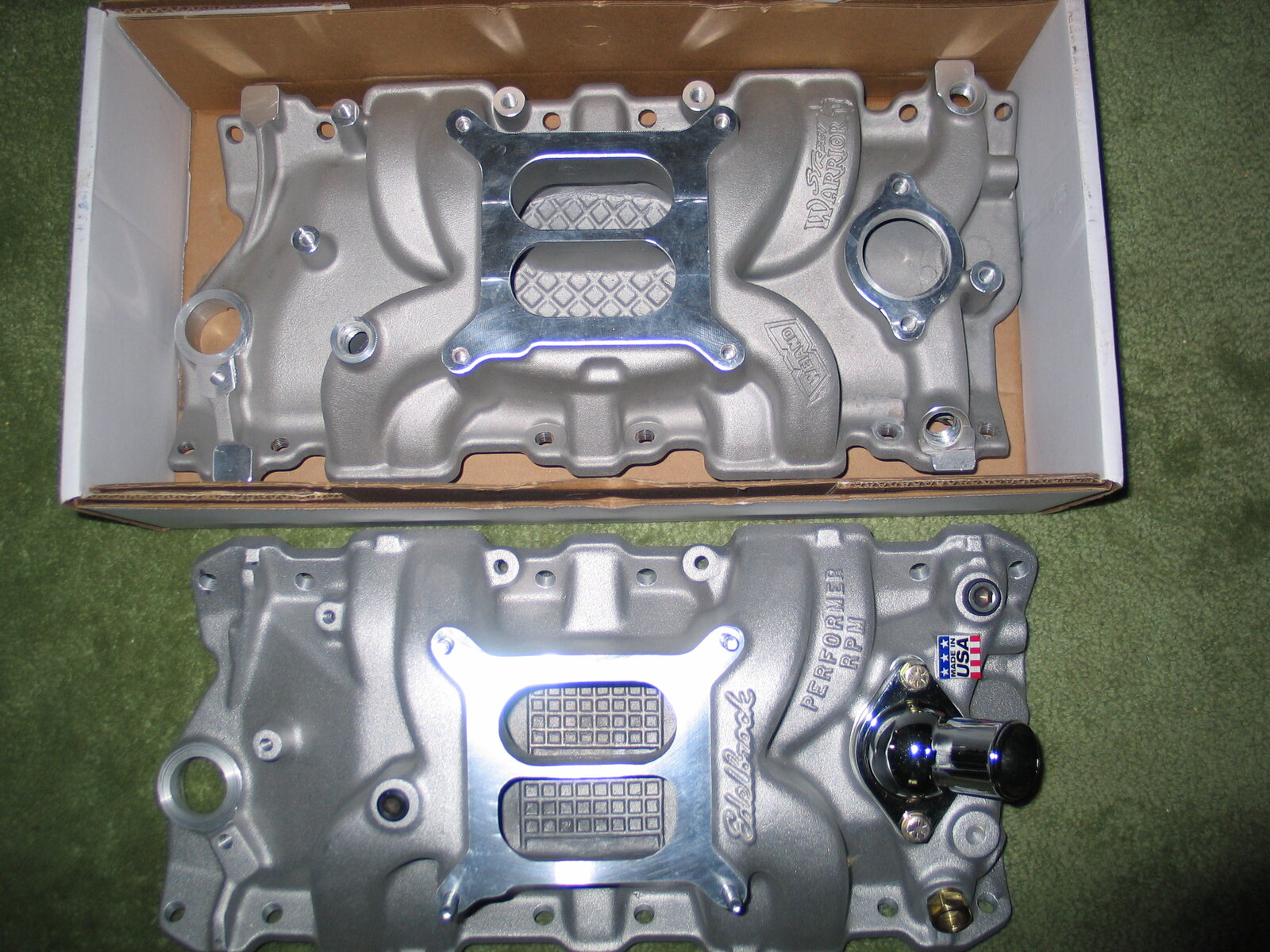

    Why do it once when you can do it twice at twice the price... My brand new never ran Weiand intake manifold has a crack or pinhole inside the thermostat housing letting coolant seep up through the threaded portion. No warranty because I had it sitting on the shelf for so long. Won't buy another Weiand so I purchased an Edelbrock replacement instead. Good thing is car is now home in my garage... IMG_4988.JPG IMG_4986.JPG IMG_4991.JPG IMG_4984.JPG IMG_4989.JPG IMG_4983.JPG
  5. I would try to repair the Weiand using JB Weld.
    Apply it on tip of finger from inside water jacket. If you can find the hole you should be able to patch it.
    When dry, use mouth to blow through bolt hole.
    Just my suggestion.

    Not even an option. If it doesn't fix the leak immediately or it starts leaking later on then I have to pull it all apart again. I've got better things to do than R&R it a third time.

    real shit after sales service where did you buy it.i would not use a bolt there rather a stud and locktight it in there with the strongest hydraulic sealant i can get all new metal should seal up allright.either that or silver solder a stud in there.id be standing at the counter making a lot of noise till i got another.

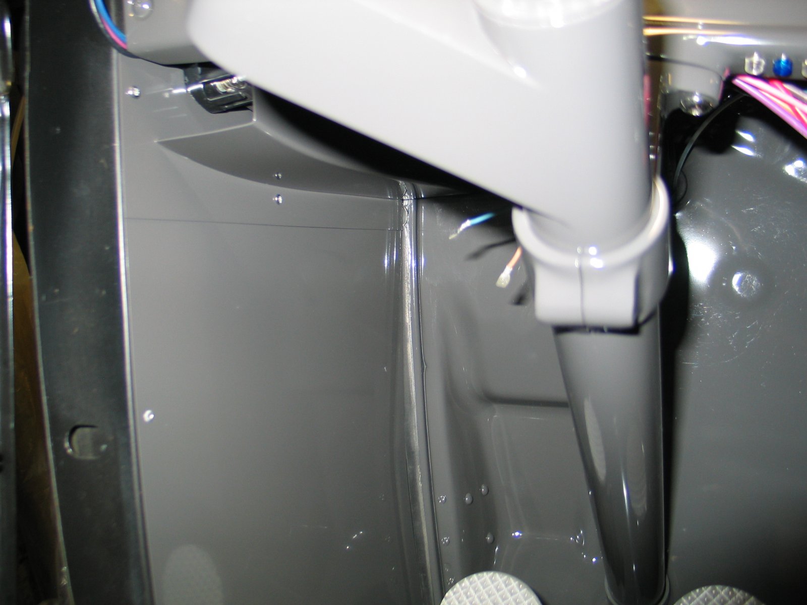

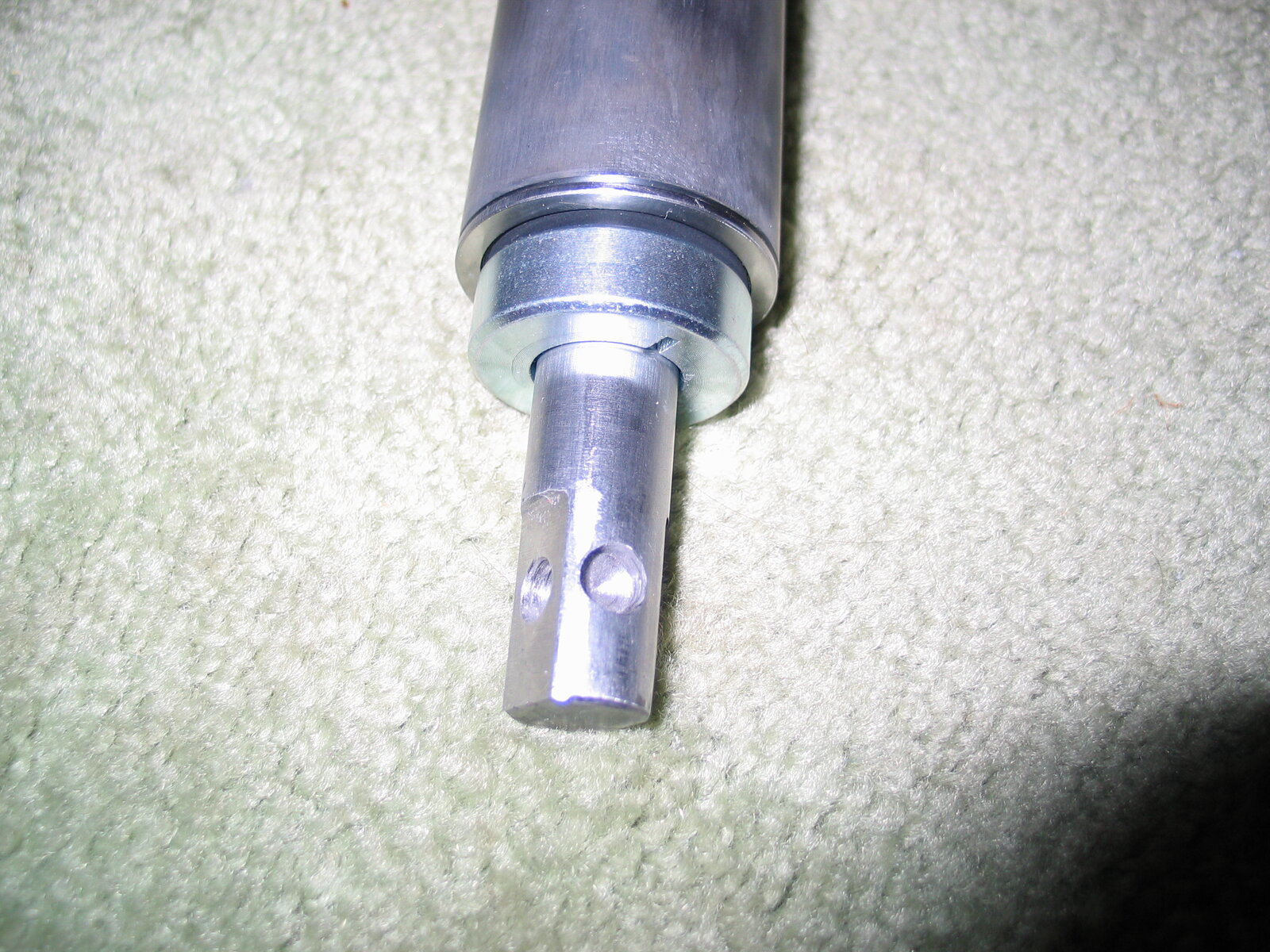

    Dale Snyder... Here are some photos of the column. The sleeve welded to the firewall has a 5/16" threaded hole in the side. There is a hole in the steering column so that I can install a short bolt to keep the column from swiveling or sliding up or down. IMG_5011.JPG IMG_5012.JPG IMG_5015.JPG

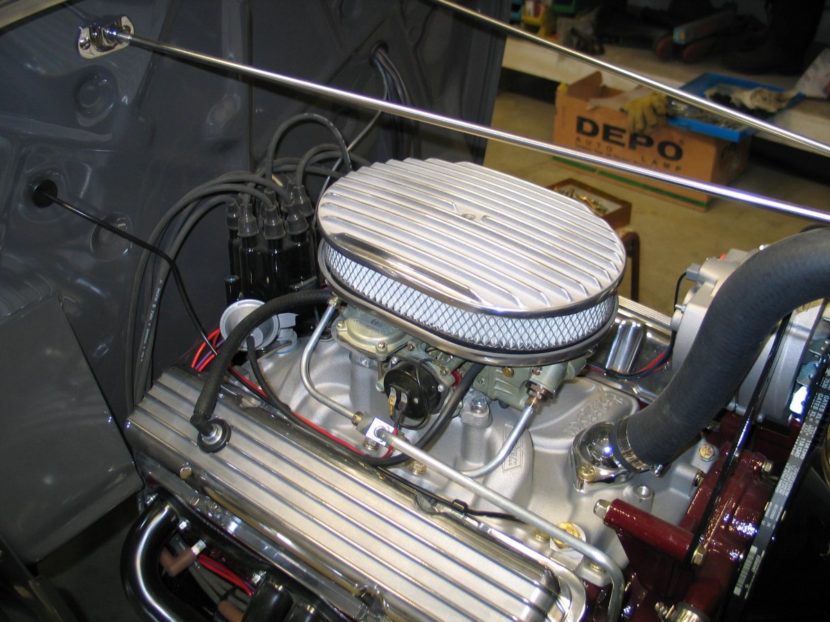

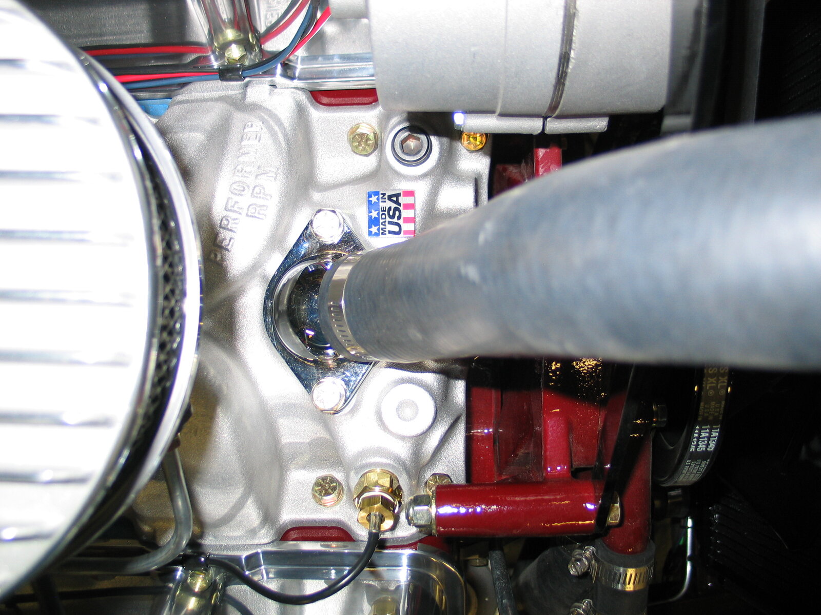

    IMG_5023.JPG IMG_5024.JPG IMG_5025.JPG IMG_5026.JPG IMG_5027.JPG IMG_5028.JPG IMG_5017.JPG IMG_5018.JPG Started an arm rest, stuff holder. Intake is all buttoned up...

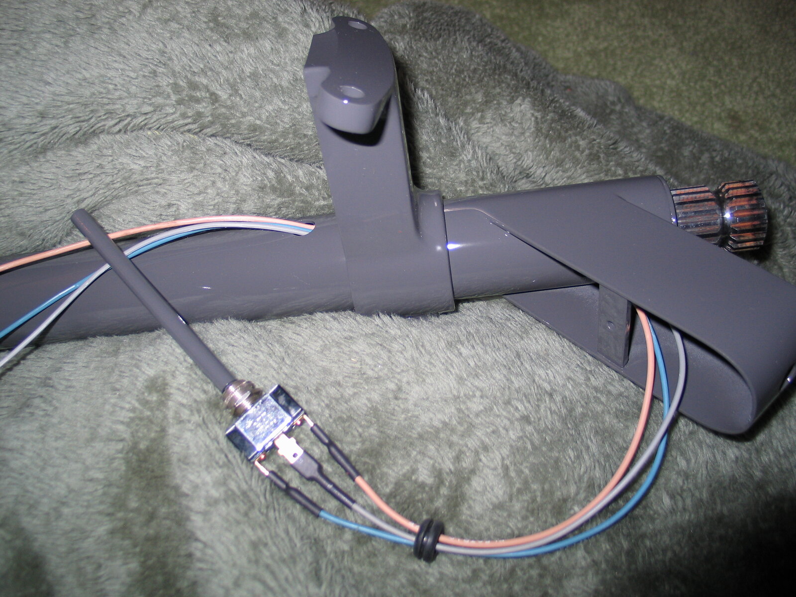

    Column is painted and battery tray is bolted in... IMG_5062.JPG IMG_5064.JPG IMG_5063.JPG

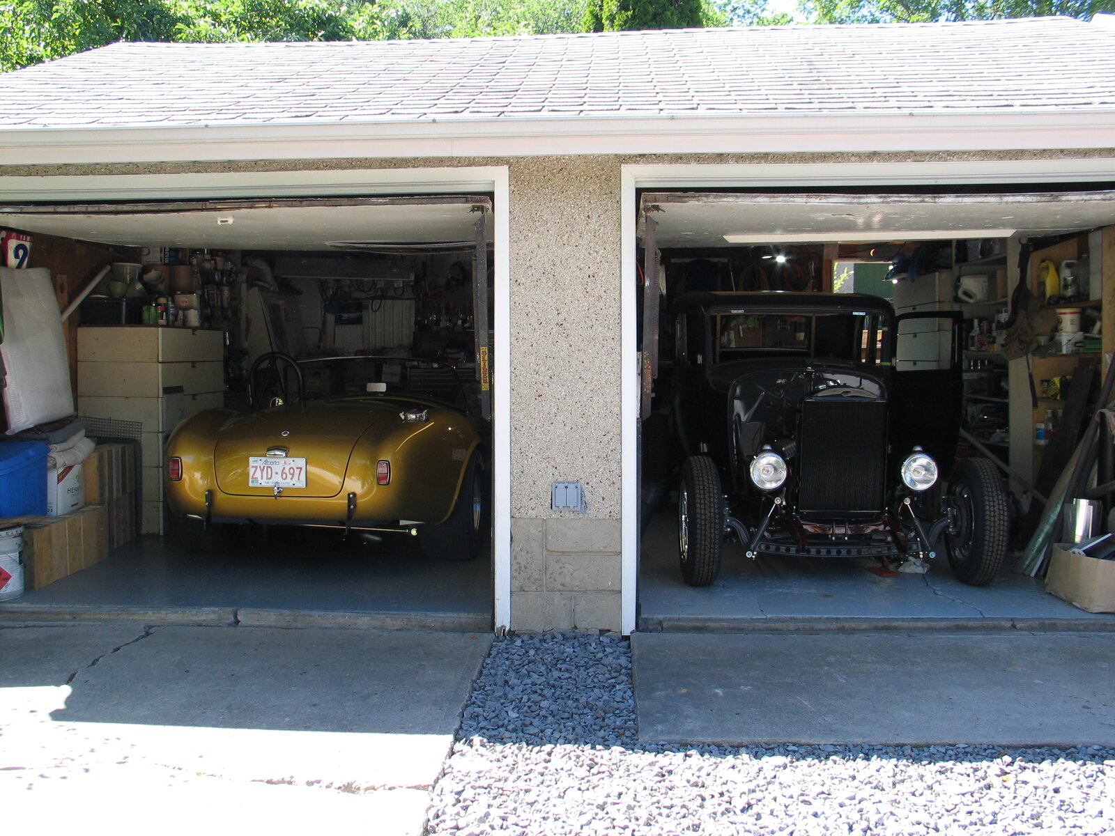

    Wiring is in for signal switch and column is in at last. First photo of the garage with both cars inside... IMG_5067.JPG IMG_5068.JPG IMG_5069.JPG IMG_5070.JPG IMG_5076.JPG IMG_5081.JPG IMG_5078.JPG IMG_5082.JPG IMG_5072.JPG IMG_5075.JPG IMG_5074.JPG

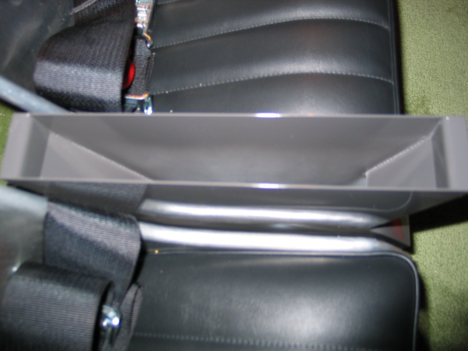

    Arm rest is painted and installed. Have to figure out covering the top... IMG_5084.JPG IMG_5102.JPG IMG_5103.JPG IMG_5110.JPG IMG_5109.JPG IMG_5111.JPG IMG_5113.JPG

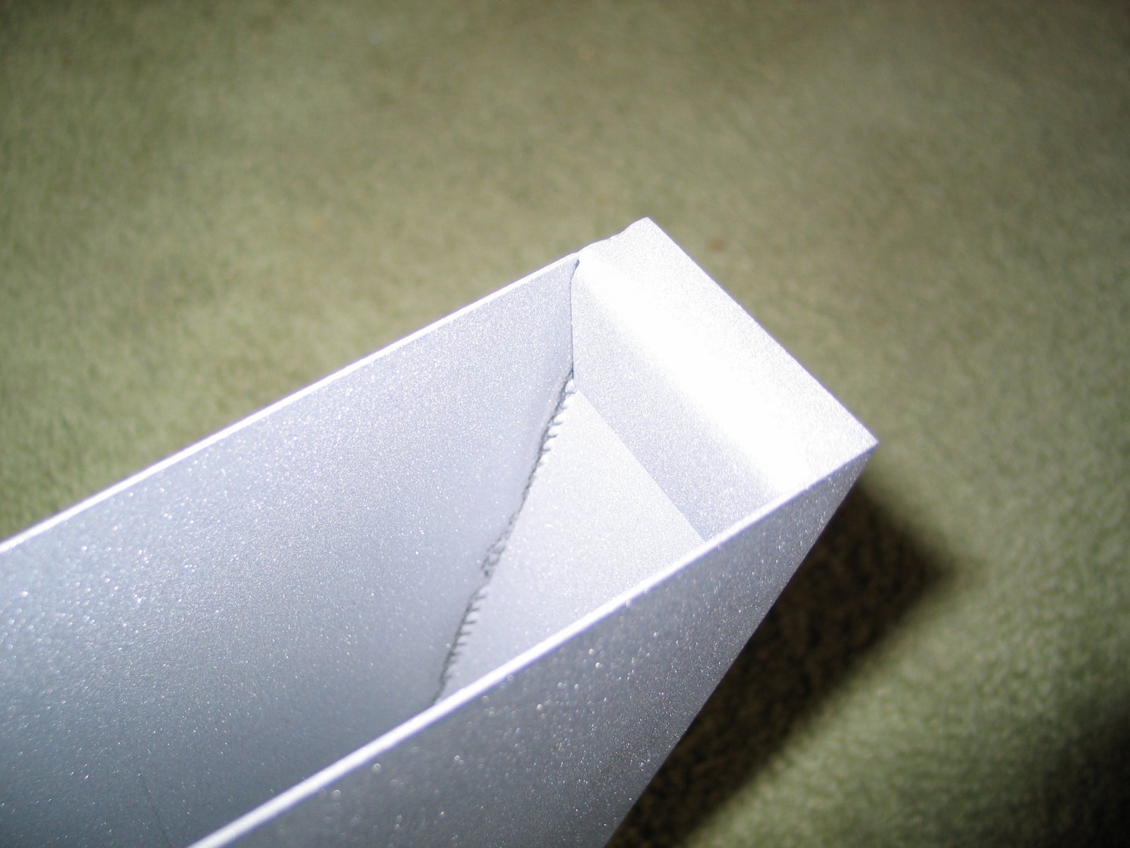

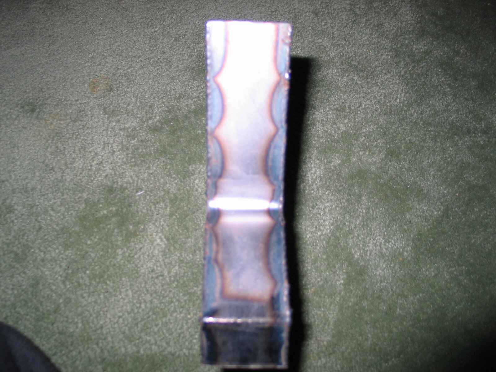

    IMG_5124.JPG IMG_5132.JPG IMG_5135.JPG IMG_5136.JPG IMG_5138.JPG IMG_3972.JPG IMG_3971.JPG View attachment 5118384 View attachment 5118385 I had to adjust this rear package tray 5/8" square tubing. The ends needed to be extended 5/8" so the end was flush so when I install the rear firewall panel the metal sits flush. I cut the tubing and added the extension then welded it back together. Ground, filled and painted. Even if it will never bee seen it still has to look nice...

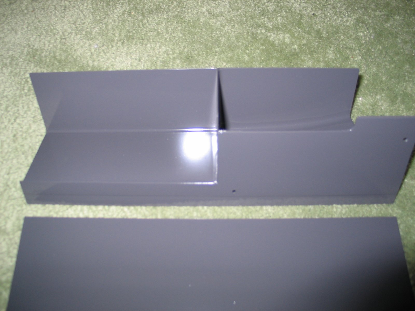

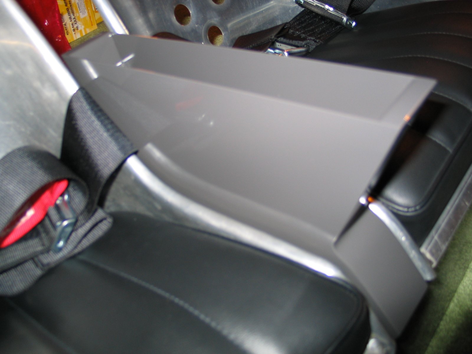

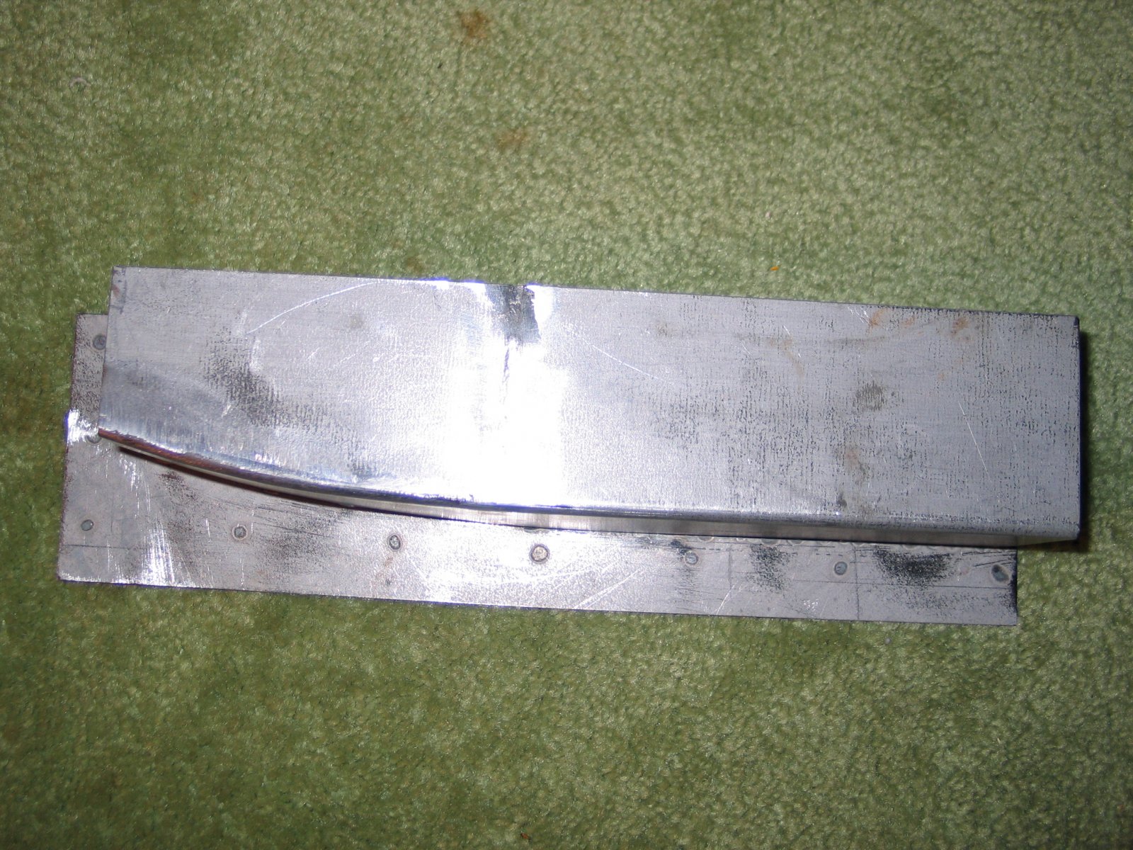

    Arm rest is finished. Driver side kick panel IMG_5144.JPG IMG_5146.JPG IMG_5150.JPG IMG_5148.JPG / electrical cover/ stuff holder is welded up. Sand blast and apply body filler to smooth out...

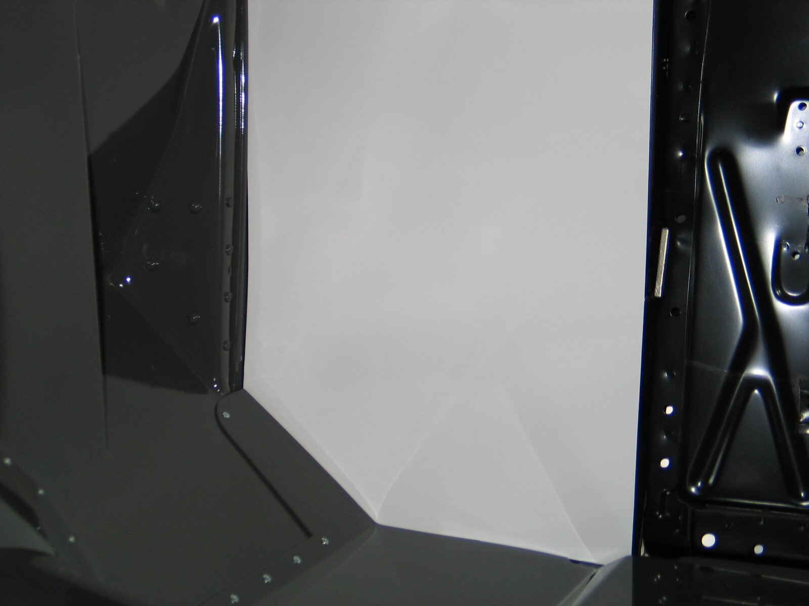

    Kick panels are painted and installed. Glued rubber strips to the back for sound deadening.
    IMG_5262.JPG IMG_5265.JPG IMG_5293.JPG IMG_5296.JPG IMG_5300.JPG IMG_5299.JPG IMG_5298.JPG

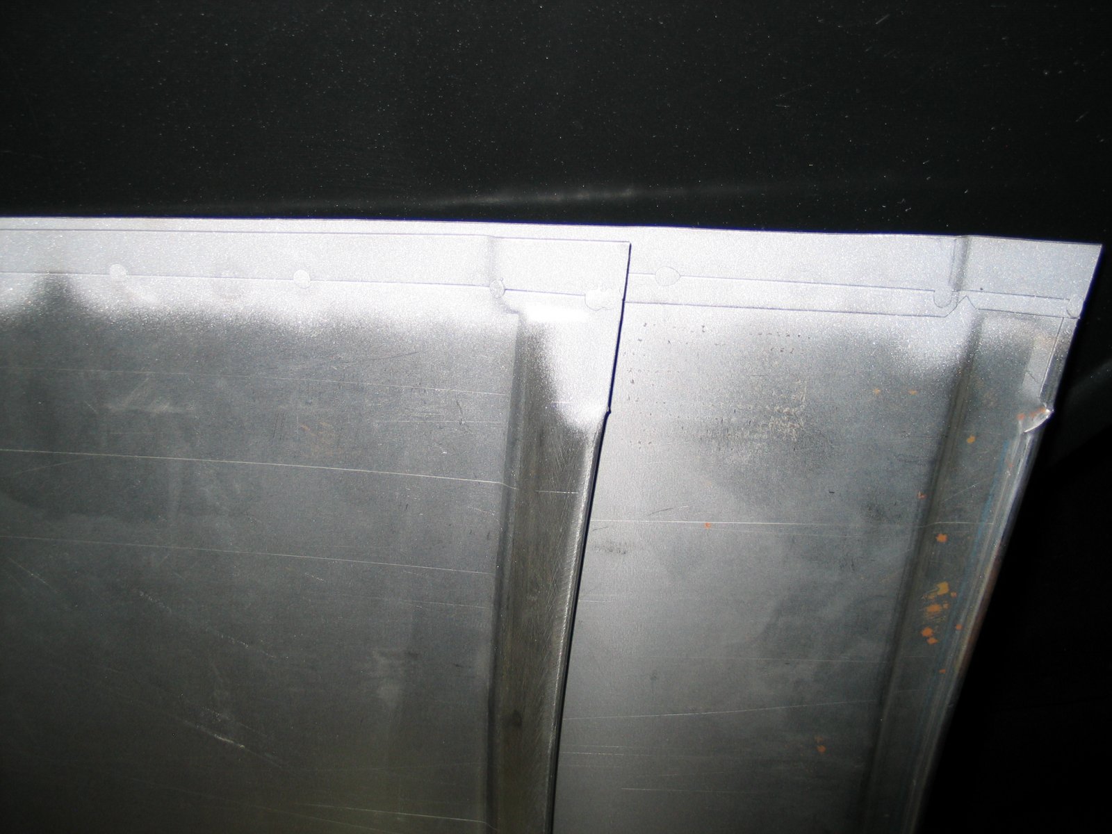

    IMG_5317.JPG IMG_5316.JPG IMG_5315.JPG IMG_5314.JPG Added a strip to the back of the hood sides. Will trim in a pie shape from 0 to 3/16" at the bottom to get consistent gap. Started header cap behind windshield.

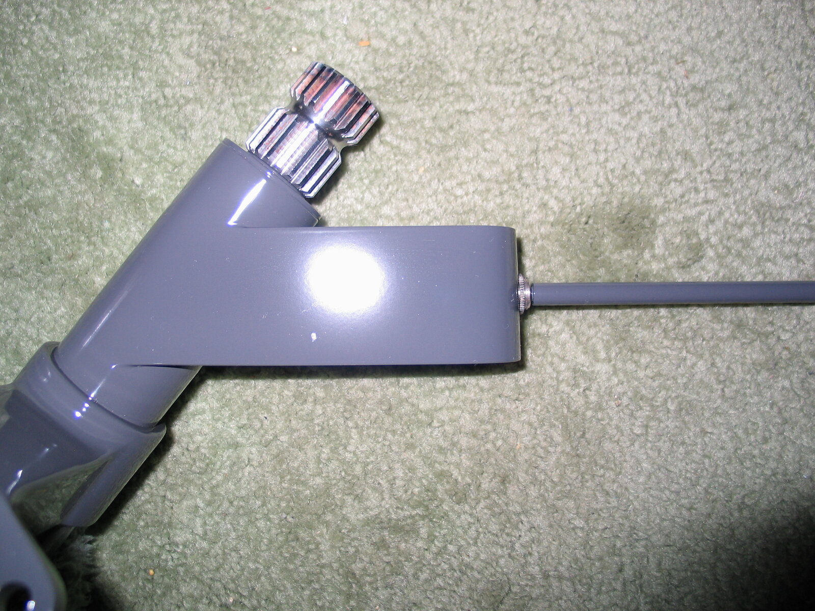

    I'm having the same problem with my build, exact same pedal set up and aluminum pads, had to move the brake pedal to the left by cutting the top off where the bolt goes through and weld that part to the arm, gave me almost 1 extra inch of foot space and still clears the column
