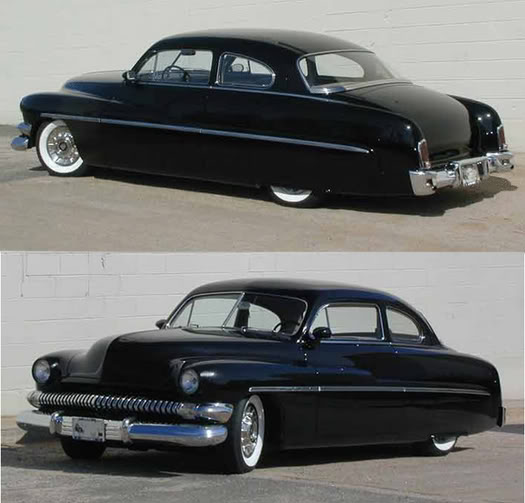

    Here's an old Boyd Coddington '51 Merc. chopper now in Napa.
    Normbc9
