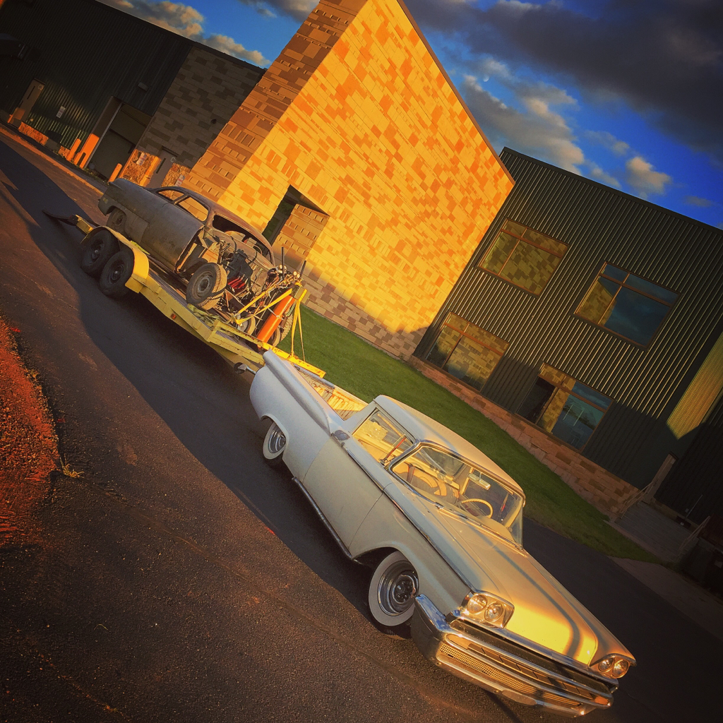

    It was the receiver setup- I think any of them would work you just need to narrow them to fit the frame of the 59 ford- I narrowed it and flipped the receiver so it fit really nice tucked up behind the bumper. I'll take some pics sometime and send them to ya. The torsion bar hitch is amazing.... no lie. First time I had one it was with a vintage camper and the ranchero pulled it like a dream with it hooked up... without it I couldn't pull it.

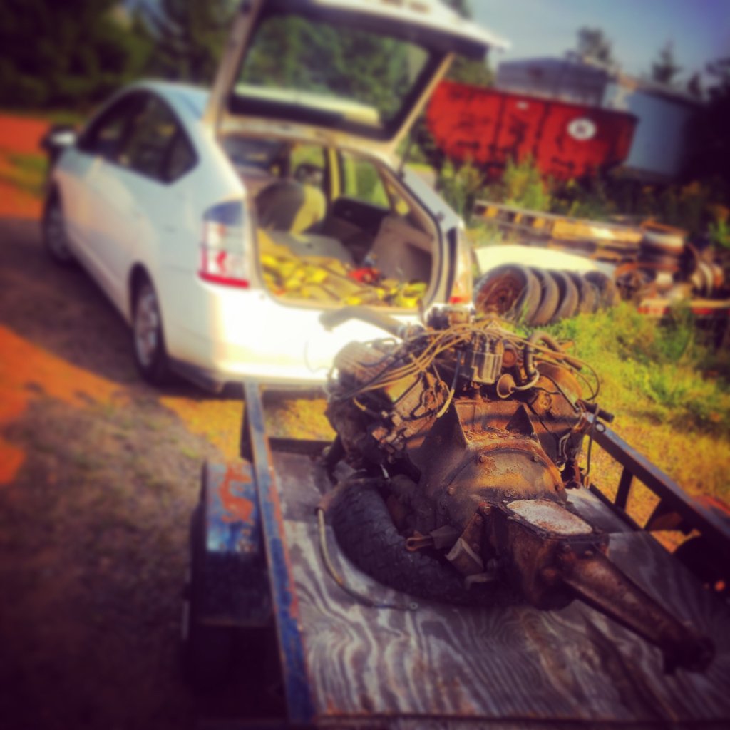

  3. Tuck, never seen such a long tail shaft housing on a selector before as that one! What is the plan for that tranny?

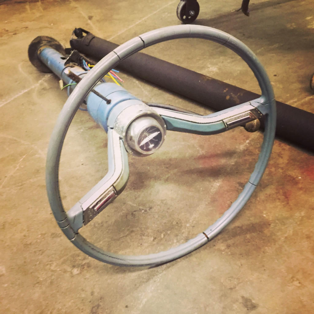

    Oh sweet steering wheel... I can just see the car finished and parked with poofy pillows of fluffy cotton and sparkly beveled mirrors.

    That long tail shaft makes it a commercial trans with different gear ratios. I have a theory that the trans was swapped but the drive shaft was too long because of the long tailshaft... I plan to get a roadmaster trans and do a top shift conversion. If anyone has a roadmaster top shift they would sell me let me know.
