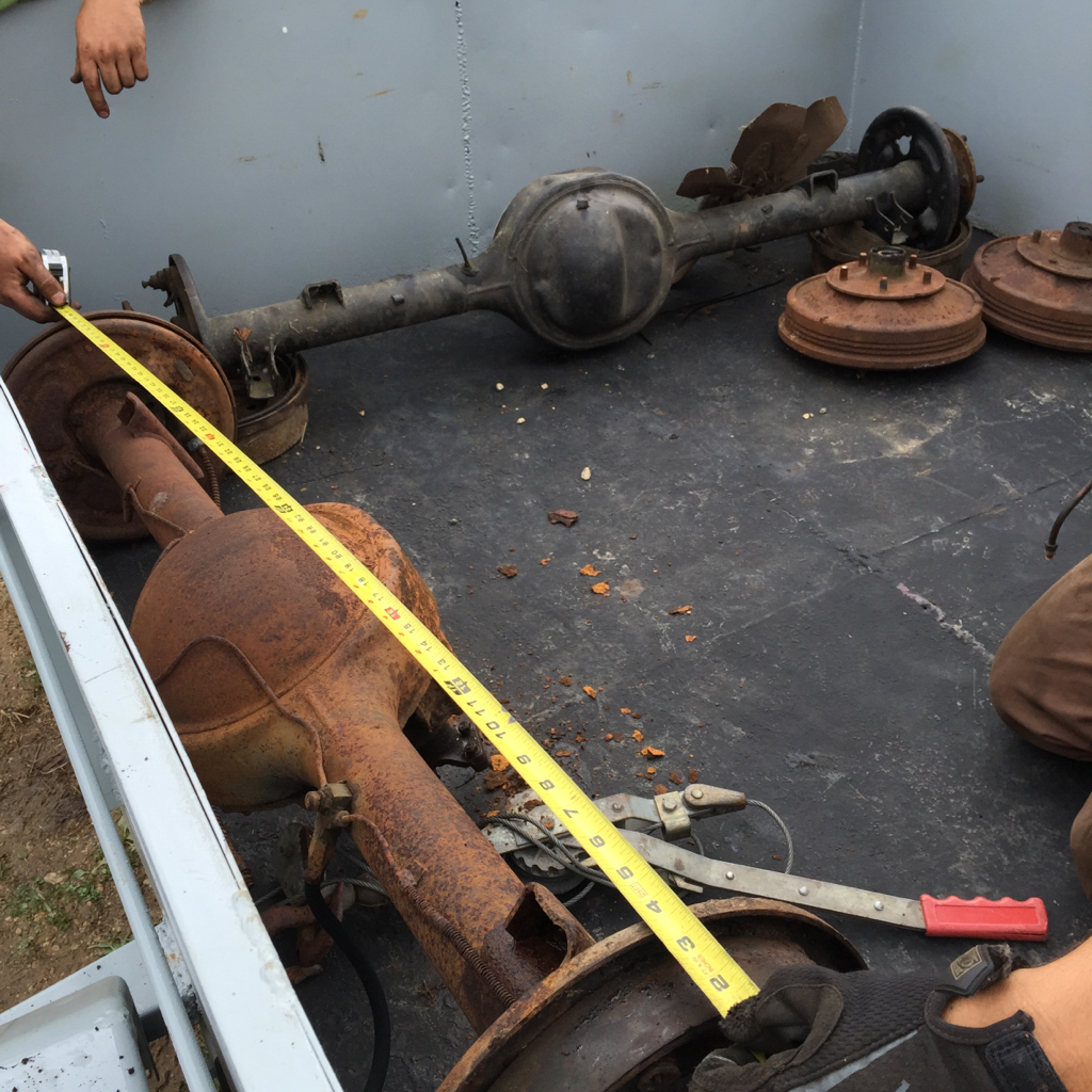

    In this pic the hubs drums and backing plates I pulled are in the corner- going to mate the hubs to Buick drums-
    Now- I have the option of putting in a narrow ford 9" or the 63 olds rear. I really like the olds rear and I have one I'm putting in my roadster... But it would rule to have a locker-
    The guy I bought the 9" rears from has a center section with a Detroit locker CHEAP...
    The other one is a bronco 9" similar width to the 57 ford- I bought two of these Broncos (one not pictured) because they were priced so cheap-
    So I have options I guess... Detroit locker 9" ford Or an olds rear-
    I could find a posi unit for the olds down the road but man they're getting spendy-

    If you are going to do 9", why not find a '66-earlier dimple back housing, and fill the dimples so it looks like an early smooth back housing?

    @Tuck what are the widths of the 9" vs the Olds?

    @-Brent- the 9"'s are 54 1/2" flange to flange- the olds is 55 1/2 flange to flange. One inch difference.

    @Tuck - I assume you're running the 5x5" on the back if you run the Olds?

    @-Brent- yeah I'm leaning towards running the olds and there are two good 15" 5x5 b/c steel wheels on the donor car.

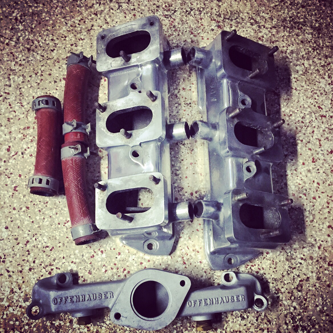

    Here's the actual carbs- (not the ones from my hemi ).
    I'm thinking of putting kits in these and running them. Carbs were in better shape than anticipated the bases are painted- butterfly's are clean- I'll pull the emulsion tubes and give them a good once over and let them buck-

    What the heck?
    How many SP tops do you have?

    @dmorago It's just the tops that make them look like this- carbs are standard Stromberg 97 or 48's.
    There were some flow tests done- the 97's no real improvement but there is a flow improvement running the 48 body! I think the key to using these is to run them on Stromberg 48's. They're more than a little hard to find though... I stumbled across a few but that's because of the horse shoe up my ass... (-; not everyone is into them.
    I'm running six on the drag star on my hemi- I still need to spend about 400 in parts to finish refinishing those carbs and the back part of the linkage- almost done restoring that intake- all the small parts are done. Will have this finished this winter!
