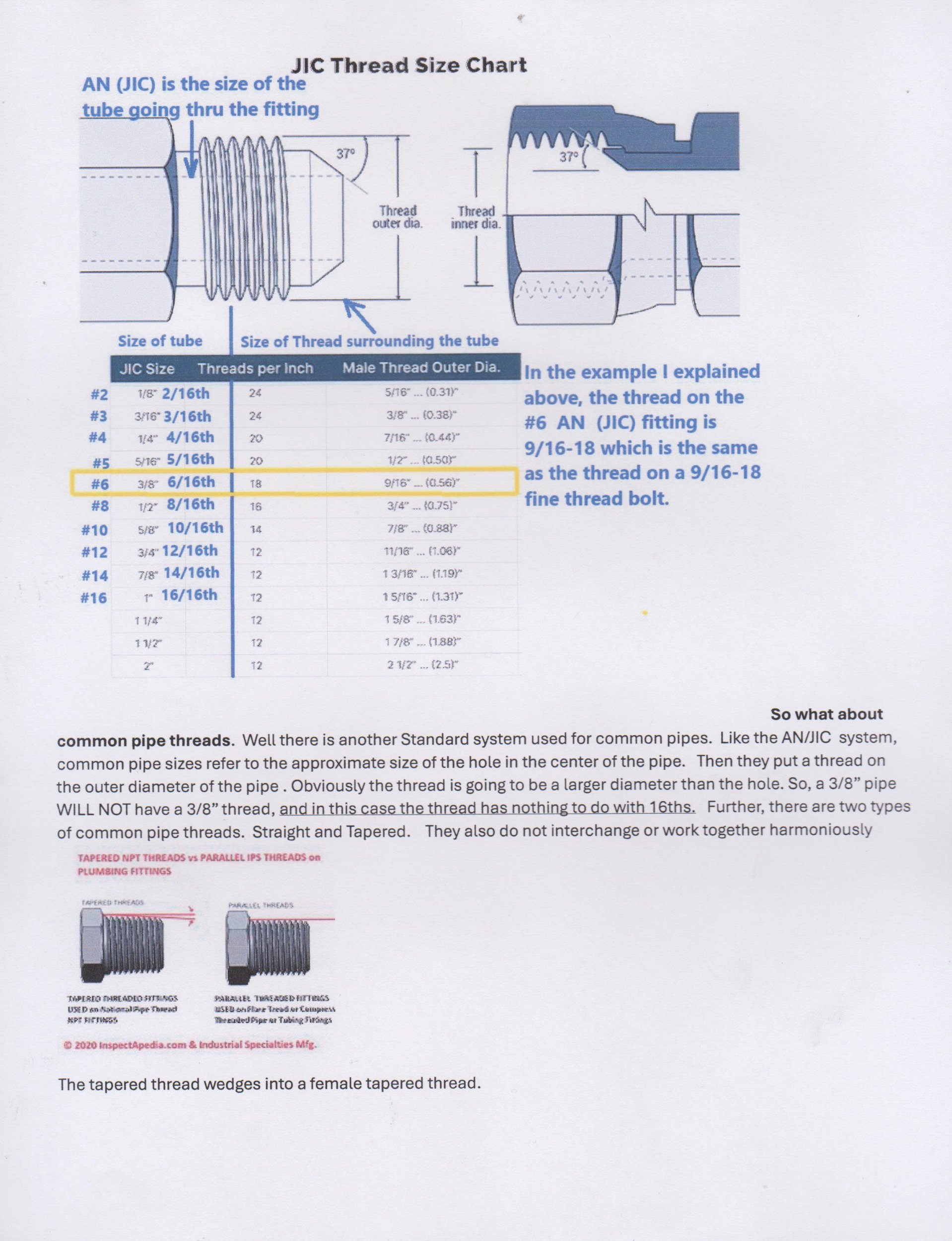

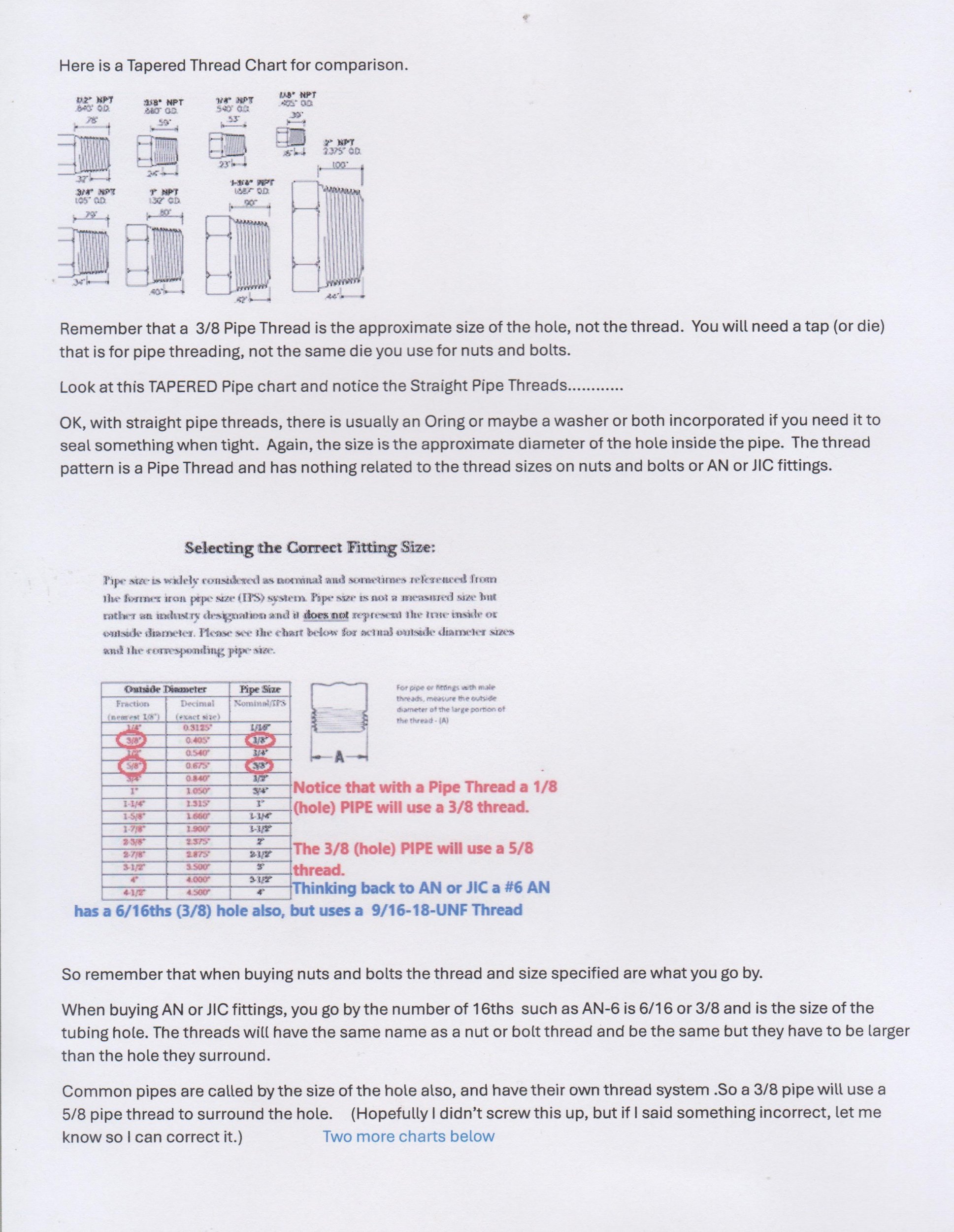

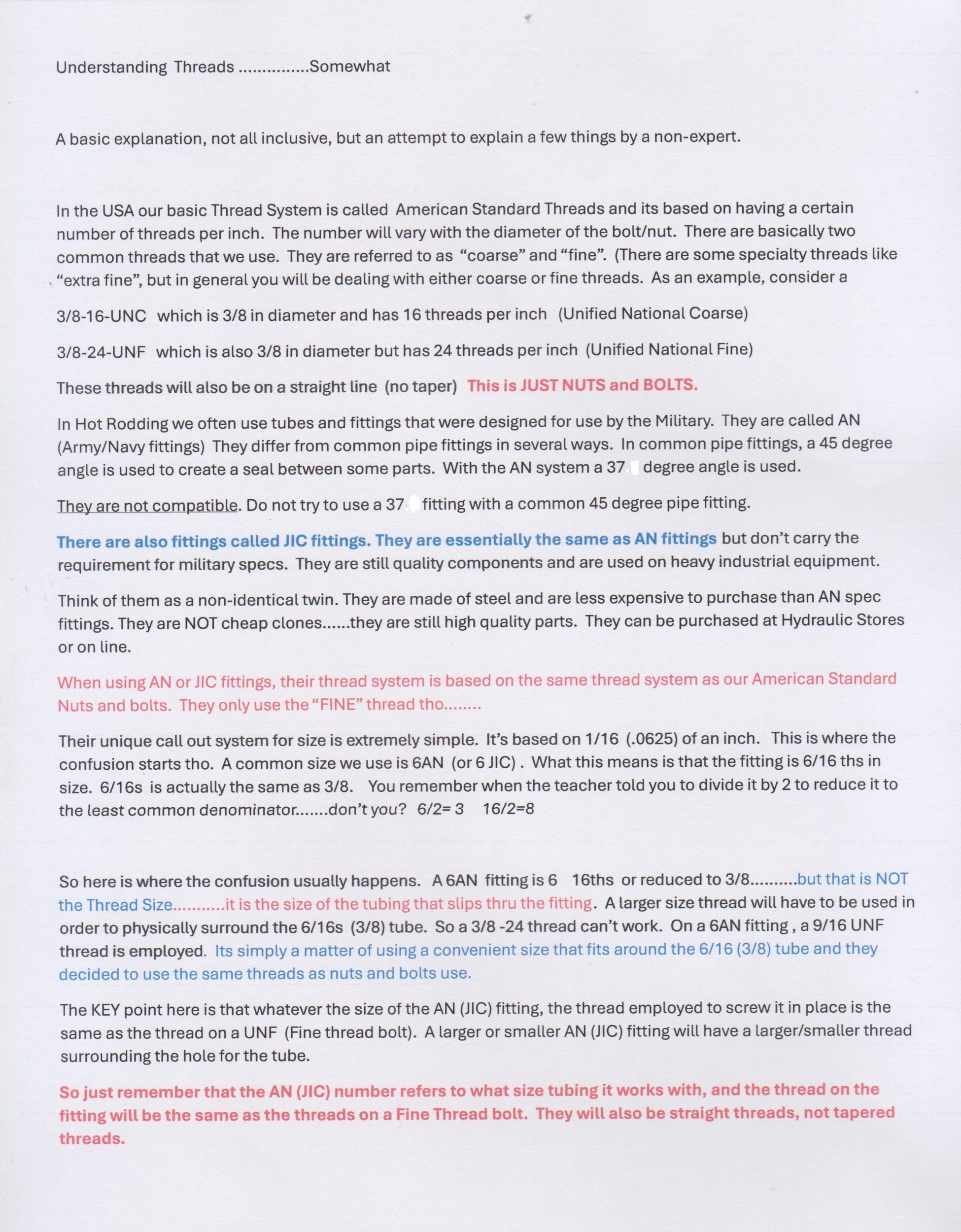

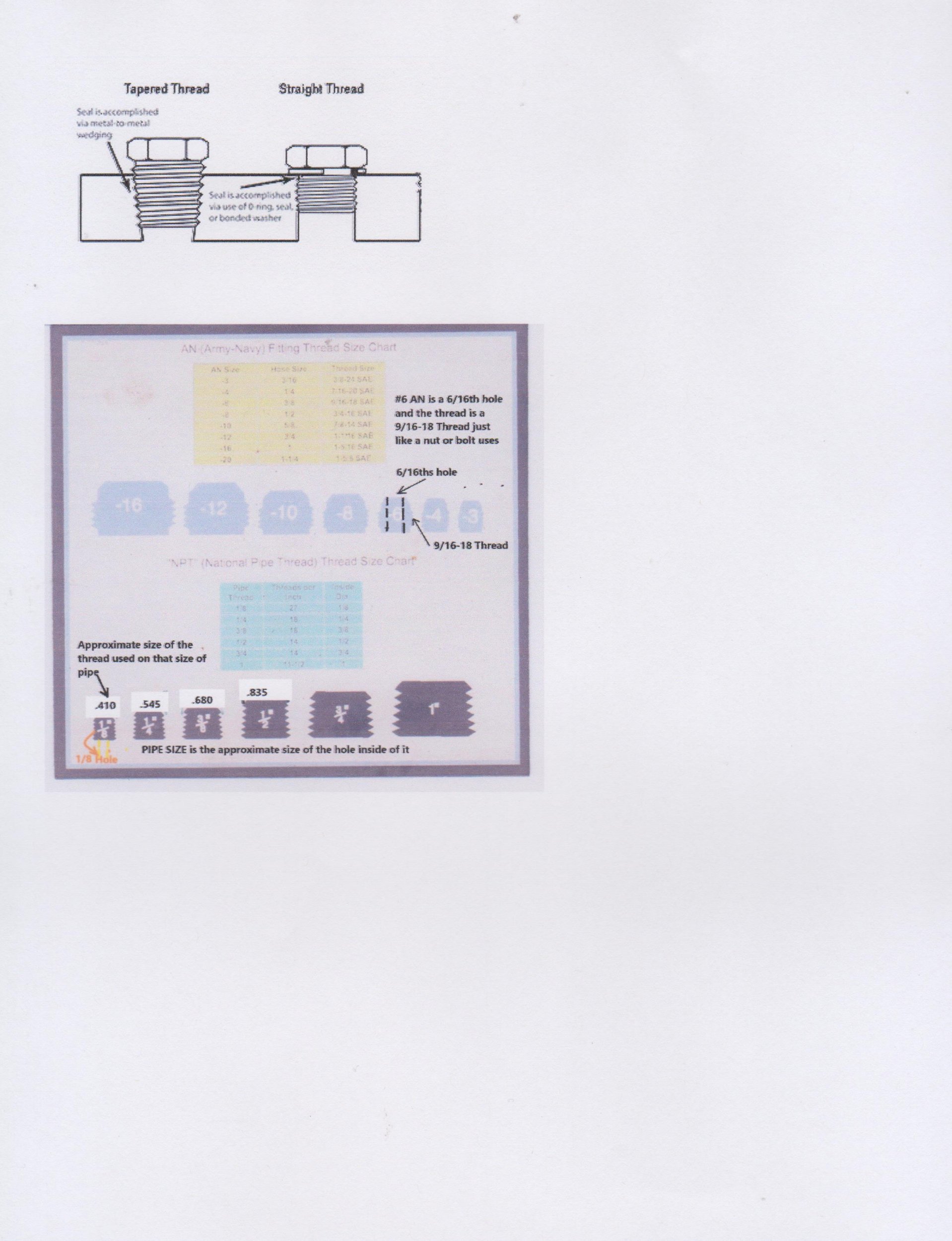

    I have been sorting through fittings I have and trying to put them in some sort of organized grouping. They are mostly AN type fittings, but many of them are also "adapter" fittings that combine two types of thread systems. I have a pretty good understanding (IMHO) but admit that sometimes I still have to check some of them out. It occurred to me that many people have little understanding of our American thread systems, so I decided I would try to explain the basics of the different American thread systems in a manner that would hopefully help others to get a basic understanding of them. Hopefully I didn't screw it up trying to get it explained (to the best of my knowledge) in a fashion that might help some others. So here it is..........
    EDIT CORRECTION.......I referred to AN as meaning Army Navy and it should have been Air Force Navy as @DDDenny reminded me below. Just a brain fart from a frazzled old brain......but the correct AN is Air Force/Navy.:)
    Some of the charts or kinda small, so click on them and see if they enlarge.
    EDIT
    There is a line on page 3 that says "Look at this TAPERED Pipe Chart and notice the Straight Pipe Threads. While editing I put that in the wrong place. It should have been on page 2 above and sjust below the picture of two fittings. It should have said "Compare the tapered and the straight fittings"

  6. DDDenny
    Posts: 21,114
    Pretty sure the AN callout equates to Air Corps/Navy.

  10. ekimneirbo
    Joined: Apr 29, 2017
    Posts: 4,974
    ekimneirbo
    You'd be correct.......thanks for pointing that out...............its just one of those things that my old brain forgot.:)
    I'll make the correction.

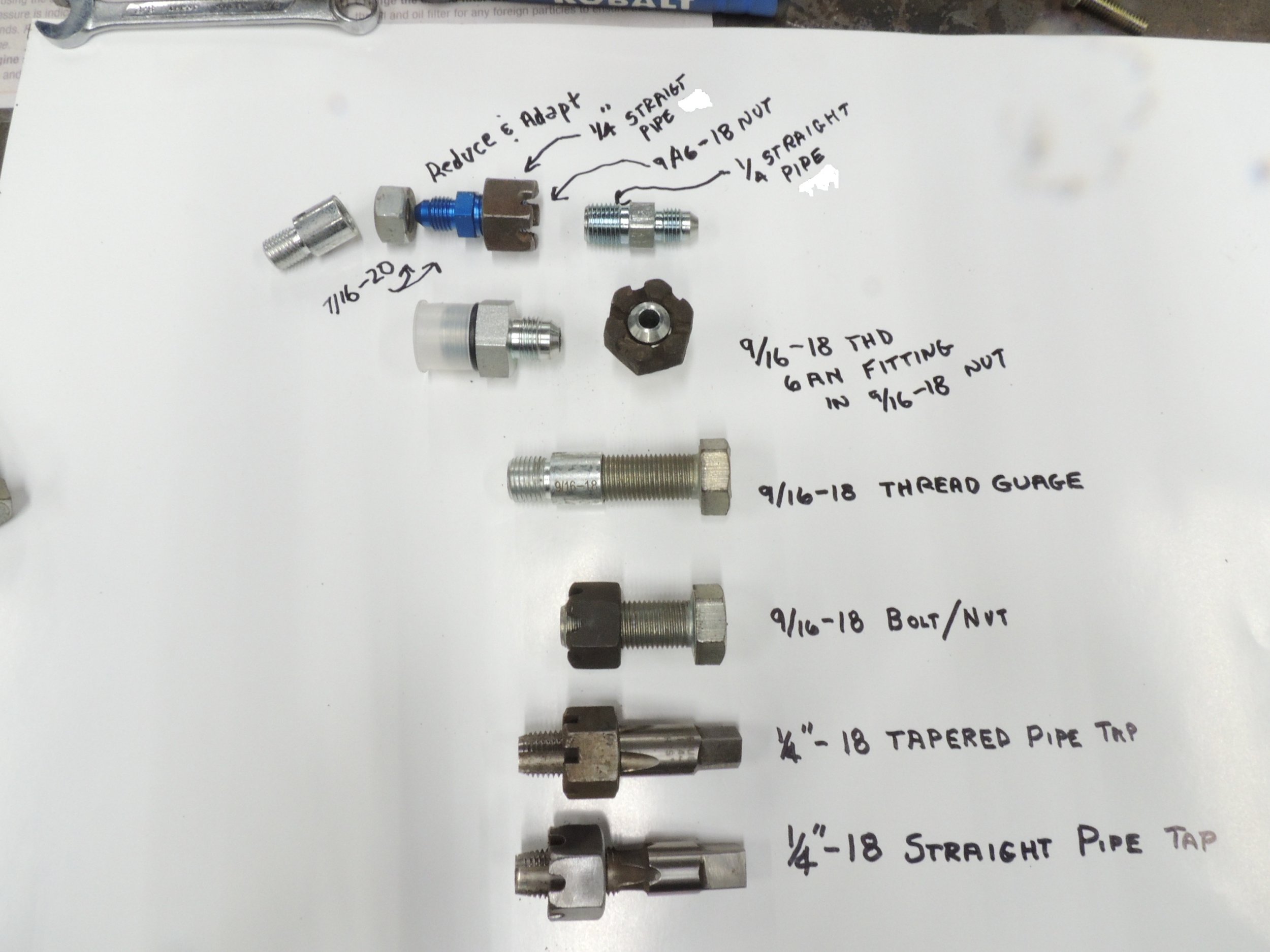

  20. ekimneirbo
    Posts: 4,974
    ekimneirbo
    That's actually a really good source of info. I'd suggest that Hambers print a copy, especially the chart about AN thread size and put it in the drawer where they keep their threading and fitting stuff................
    Would like to clarify one thing.
    "Note that AN threads are different for bolts and fittings. In bolts the number refers to the diameter of the bolt whereas in fittings it refers to the OD of the tube and thereby have different threads.
    For example, AN6
    bolt has a 3/8 -24 thread.
    whereas an -6AN
    fitting has a 9/16-18 thread."
    That is a correct statement but people should realize that whether a 3/8-24 Thread is being used or a 9/16-18 thread is used.........the thread itself is "essentially" the same whether they are on a bolt or on a fitting. 3/8-24 is 3/8-24 and 9/16-18 is 9/16-18 . It's the AN designation that has a different meaning between nuts/bolts ...........and fittings.
    Even a a common Straight Pipe thread which is a different thing altogether uses the same thread sizes ...............but its a similar situation to the AN explanation. In a common pipe the designation 3/8 pipe refers to the approximate size of the hole in the pipe, not the external thread. So a 3/8 pipe could have a 9/16-18 thread on it.
    Where the common pipe varies is that most of the time when using that common pipe, they also have a "tapered thread" in addition to the straight thread version. The tapered thread is the more common type. So while it may also have a 9/16-18 thread on it outside, the taper makes it incompatible with straight threads of any other fitting.
    Here is a picture to show what I mean. Look at the silver fitting at the top. It"s left side is 1/4 STRAIGHT PIPE. Has nothing to do with the AN (JIC) system, but the thread on it is a 9/16-18 and it screws into a 9/16-18 nut.
    The Blue fitting screwed into the nut has 9/16-18 threads but its left end has 7/16-20 threads and they screw into a 7/16-20 nut and a thread gage.
    The two pipe taps in the lower part of the picture should say 1/4 inch pipe tap.......9/16-18 thread.
