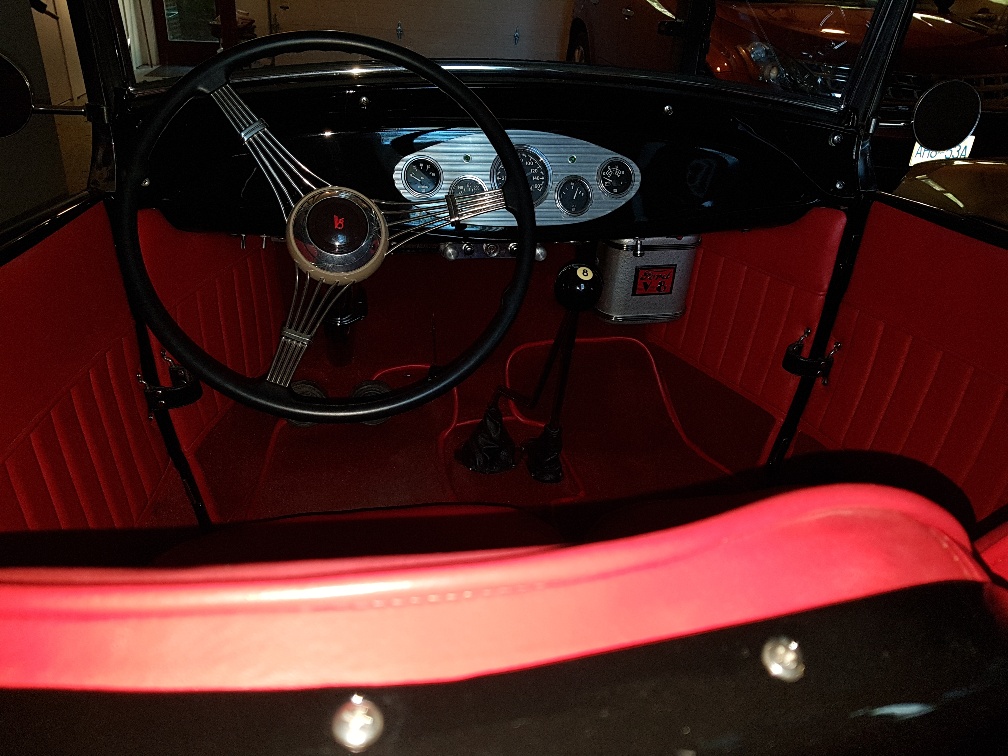

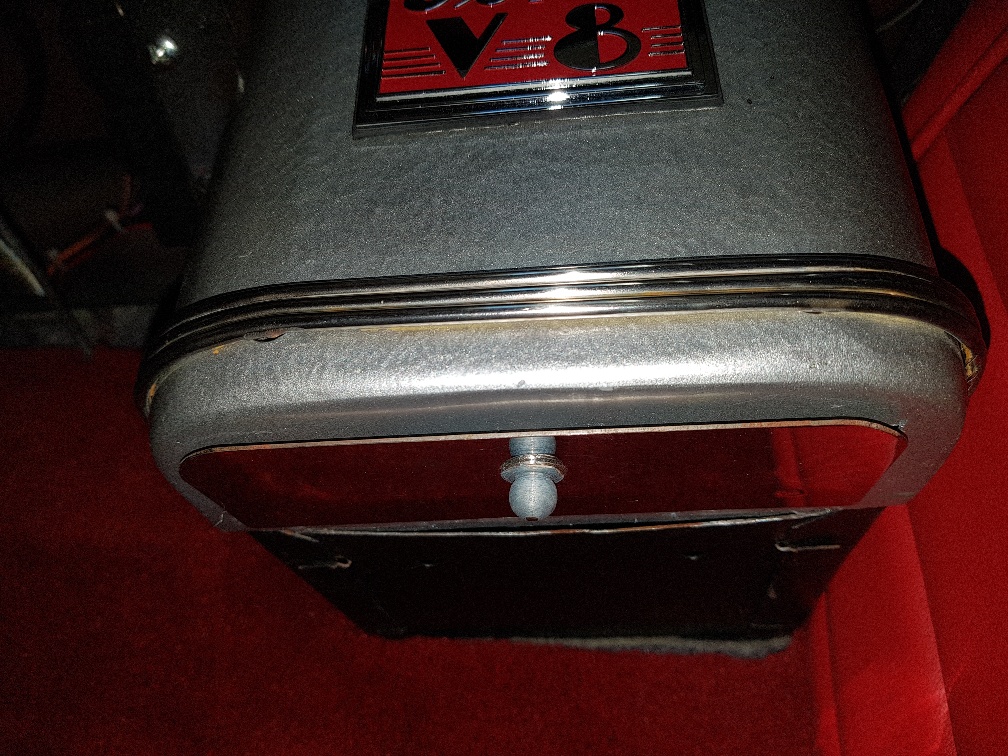

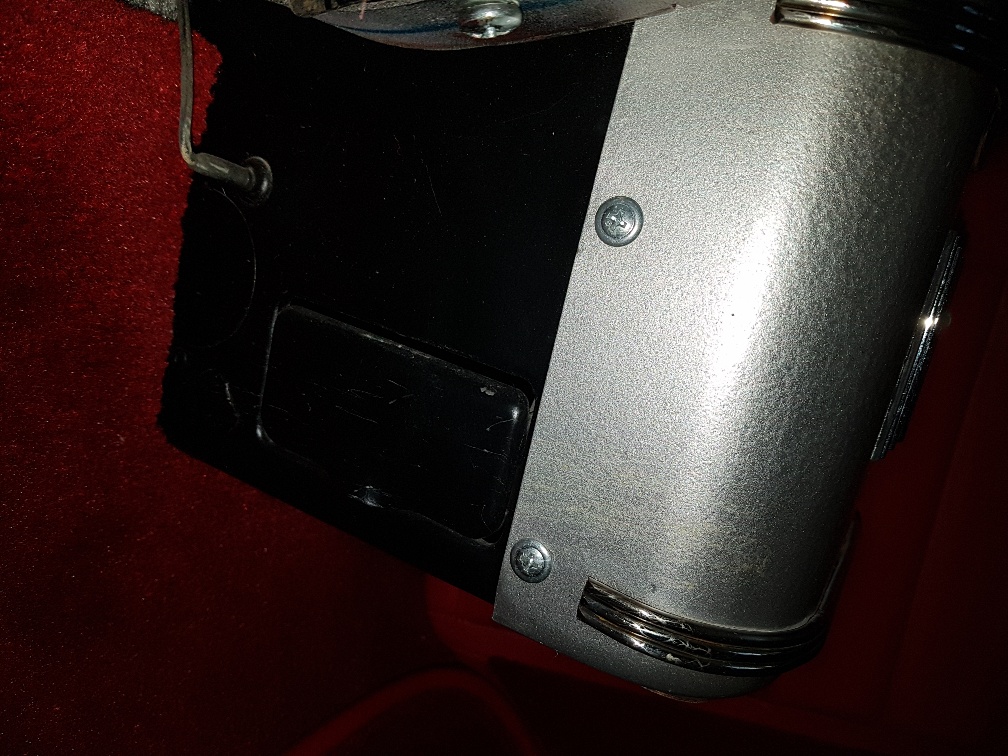

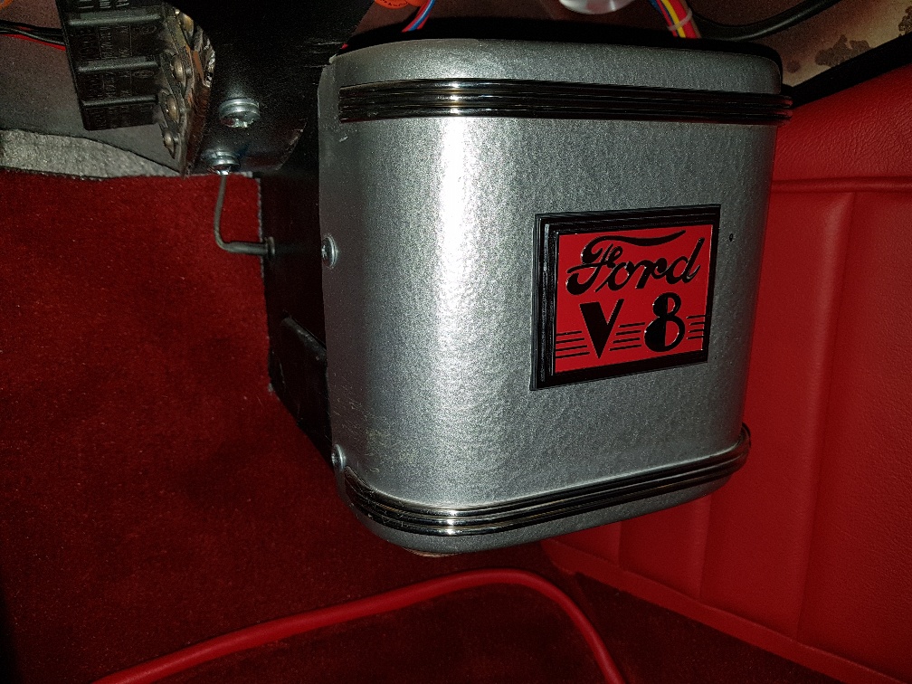

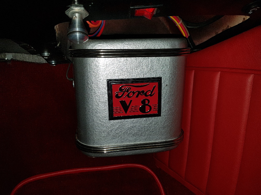

  7. In my roadster, I took one of those modern square box style auxiliary heaters (I think they were designed for use in the back of suburban type trucks in the '70-80's) that looked completely uninteresting (like it came out of the 70-80's) and made a couple simple changes to bring it into the era. I made a new front cover out of sheet metal...with rounded edges and corners, I added a trap door to the bottom of the new face (and used the original side vents that came on the heater), I painted the new front cover with rattle can hammertone grey, I added some art deco era type trim (made using 3 strips of stainless steel bars welded together with studs on the backside (I scavanged from old oven racks that I found at the dump)), and then added a reproduction trunk badge from a '40 ford trunk.
    The plus side of this heater was it was cheap, 12 volt, came with a new heater core and fan. Works great.

    That looks terriffic!
    Could you show a pic of the heater you started with, or if it's too off topic, shoot me a pic in a PM?

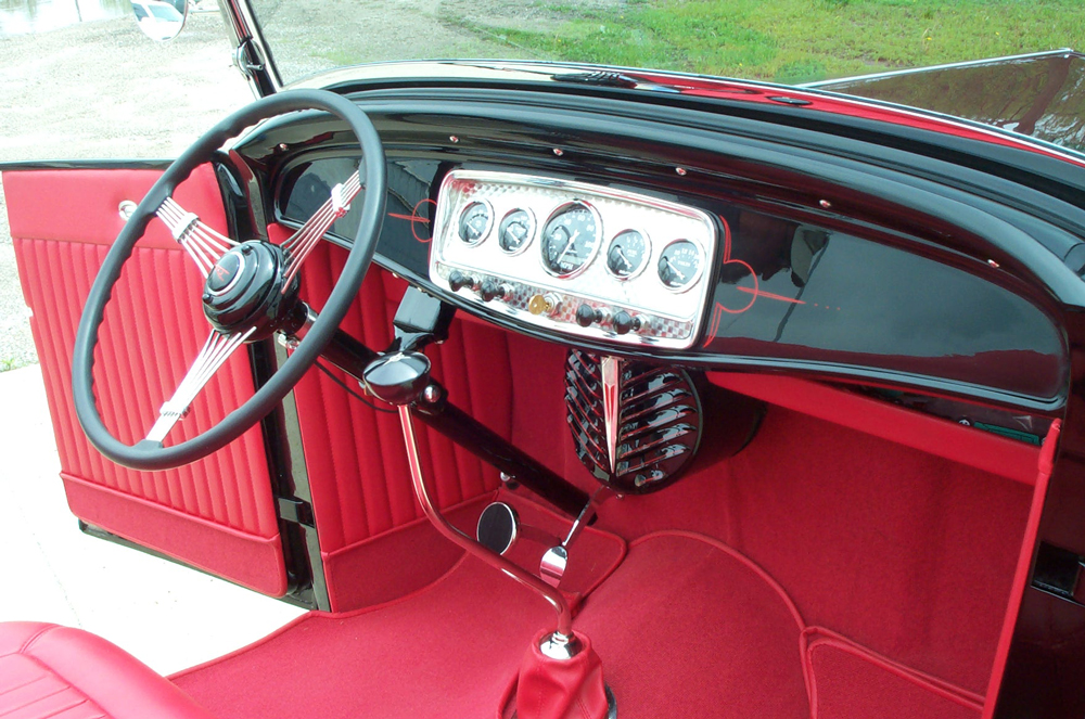

    My favorite is the Harrison. I have two of them set aside for both '32 projects. 32road_bright6.jpg

    I second this. Great job!!!

  13. Thanks guys...I started with something that looked very similar to this:
    https://www.millsupply.com/auxiliar...y-12-btu-m503012v.php?p=97236&cs=1+5393+5394#
    It may not have been this exact unit. The one I used was a swap meet score a number of years ago (it was unused and still in the original box). You get the idea though....and within context. 20181104_110917_resized.jpg

  15. Dang, that is neat! A factory one would not look as good.

    Very nice job. VERY cleaver.

    That's a sweet piece of work.:)

    Nice job.

    I have my original in my '41 but after seeing some of these heaters no doubt there are folks who collect vintage heaters exclusively. That Harrison heater is very unique, never seen that model.

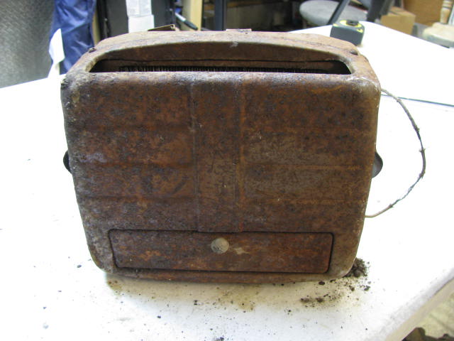

    I have an old one I found in the trunk of a parts car. I don't know if it leaks or not. Might try it some day but I really don't have any use for it as of now. It could probably be made to look decent. IMG_7004.JPG

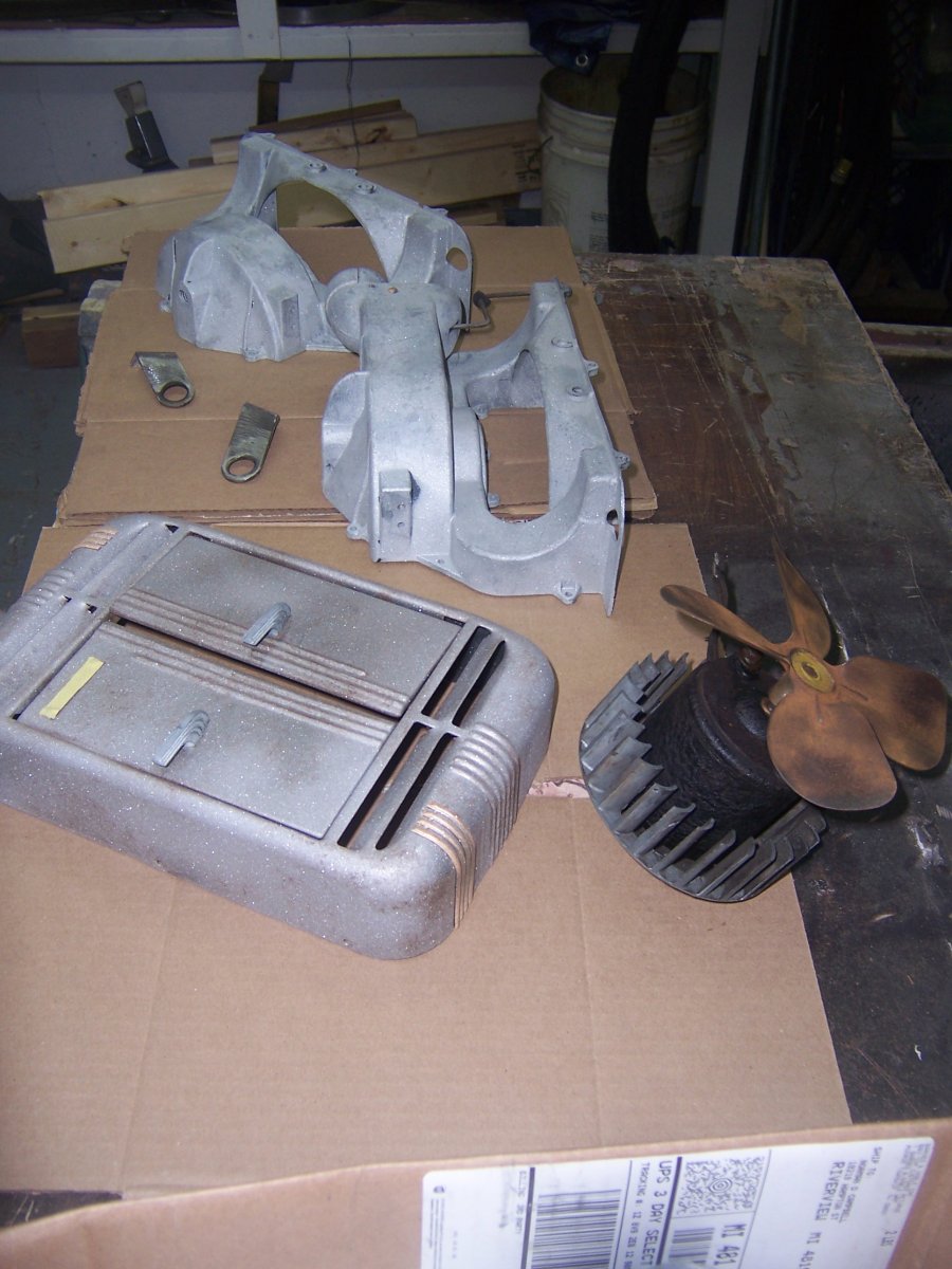

    A lot of those vintage heaters are cute but will cost far more to get working right than just buying a good heater. I full and understand the why and have several small under dash heaters in the shed but outside of one rig that having "correct" is a must I probably won't use any of them because of the expense to fix them.

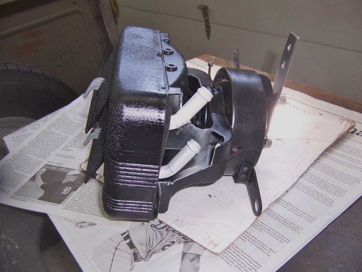

  26. Traded an old Sun tach for this Hudson heater...put a new heater core in it from a Ford F150 100_8961.JPG and a 12v converter...
    I have used the box heaters from Yogi's and Speedway, Vintage air...they work fine but are a bit expensive...enjoyed scrounging an old one back to life for some time and 40 bucks...
