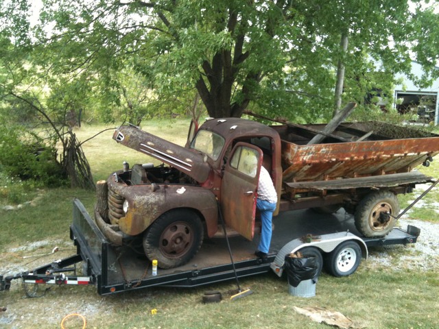

    I can share two methods that have worked for us recently.
    After everything else failed, we freed the motor in this F6 by using a greease gun and hydraulic pressure. We pulled the spark plugs, and used compressed air to identify which cylinder had closed valves and the piston at the top. Then we screwed the grease gun into the spark plug hole and pumped til she moved. I think this method will always work to free it, but could bend a rod if stuck really hard.
    A more gentle method that has worked for us it to let the vehicle half-way off of the trailer and use a winch to rock the vehicle back and forth in high gear.
    Both of these methods have worked when dragging the vehicle in gear just slid the tires.
    If these don't work, it may be time to start disconnecting rods and working cylinders individually.
