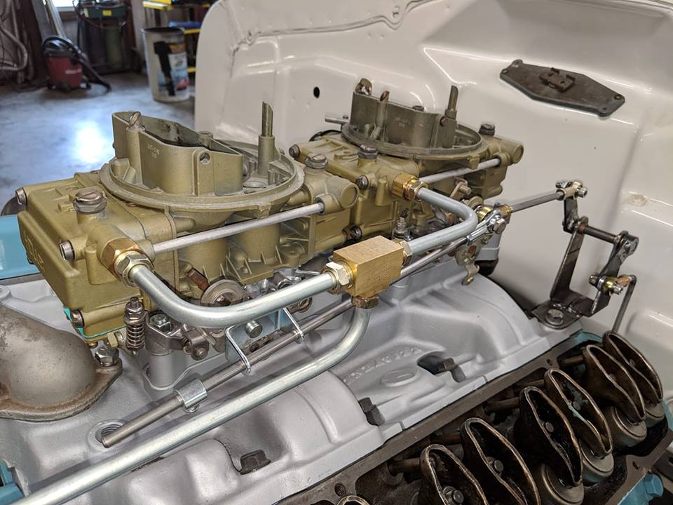

    I just have a small cheap one. I wish I had a before pic. These carbs had sat for years. Probably over 20 easily. They were black. I cleaned them with a cheap Harbor Freight ultrasonic. Used straight Simple Green.
    It took multiple cycles and the liquid had to get hot before it worked very well.

  3. Yep, that was my results too. One nice thing about these is you can clean rubber or other 'soft' parts without damaging them, something that doesn't work too well in regular carb cleaner.
    DO rinse any parts THOROUGHLY in clean hot water immediately after using simple green, as it's very corrosive (particularly on aluminum) if allowed to dry on parts.

    Right. Always rinse after no matter what you use.
