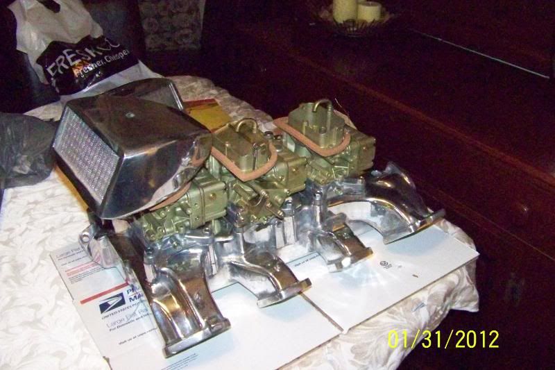

  11. Here is a pic of the tripower... still have to machine some risers/spacers for the Nicson flame arrestors...

    I know this isn't the topic of your thread, but man I love those Nicson spark/flame arrestors! I'm actually looking for a set of three exactly like you have, with the Ford/Holley 2-barrel "D" opening.

  13. I found two from someone in San Diego, and one from a guy in Michigan... Yeah, they're super cool. I have to offset the two outside ones ... so sideways and up if you get my drift. The center one with get a riser... probably about 2 inches or so.
    Mine are not the D shape, they are round, so it will be a little bit of fabrication to get everything set up properly. I think they make a multi carb set up look beefier than a regular breather, and in this case, they are coast guard approved. To find nice ones, they ain't cheap, altho I bought all three for 300 bucks... which is a fair price I think
    They come up now and then, but you have to keep your eyes open wide... For this build I have been a kijiji/ebay/craigslist junkie and more...
