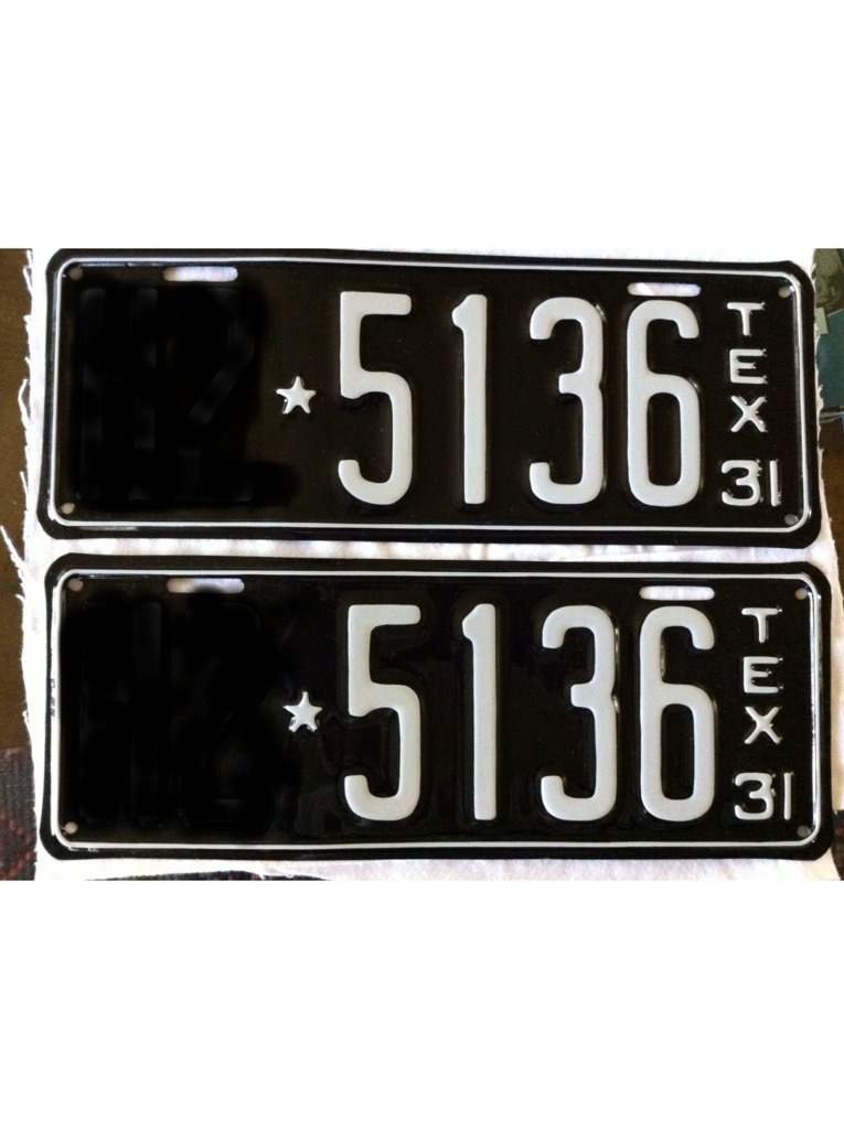

    I'm running 31 year YOM plates on my 31 roadster
    It depends on the year the title says so if maybe you can take a picture of the engine block if it's from the 50's then you can maybe title it in the fifties then once you have the title you can register it with the fifties plate remember you might need 2 plates too register .
    They didn't need the plates there just a picture of them and mine where reconditioned which is a plus.
