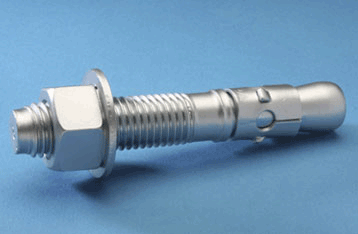

    Anyone had any experience installing a two post lift. I bought a Dannamar 10AC and am at the point of anchoring the post to the concrete. I am not sure how well the anchor bolts work, but it has a sleeve that eventually spreads over a flared end of the bolt and jam it in the hole. It looks to me like the bolt would rise up out of the hole a good bit before the washer pressed the sleeve down enough to jam it, unlass I am not understanding how it works.
    Any guidence?:confused:

    Did you get Red Head bolts? Those things are awesome. You're probably looking at what, 1/2" or 9/16 for those posts? I'll tell you what, if you drill the right sized hole, you'll end up cutting the bolt down before you ever get it out of the concrete. Make sure they're where you wanted them in the first place.

    Use a hammer drill to drill the size hole needed for the anchors through the concrete, I went 5" into my slab. Back the nut off to near the top of the anchor so you have the max amount of the bolt going into the slab, then hammer it into the hole. Tighten the nut and the wedge will catch and anchor the bolt, then tighten down the nut. Those wedge bolts work great, super strong, I used them when I installed my rotary 2 post lift.

    No the bolts don't have a redhead and they require a 3/4 bit. Thanks for the help, I'm going to give it a shoot this Saturday.

  7. If they're this type, do as instructed in post #4. If you are pre installing the bolts before you install the lift, be sure to put an appropriate sized spacer on the bolt before pounding it into the hole. You only get one chance with these cinch anchors. Set it too deep and you're SOL

    Yes, drill the required depth hole, then tap the bolt into it til it bottoms out, smack sharply with a hammer to "set" it, and now put on washer, nut and tighten

    When ever I have installed these type of anchors I have always made sure to drill clear through the slab or at least an inch or so deeper then the slab. That way if you want to remove them you can just bang them down through the floor and patch. To avoid mounting them too deep just put the lift in place and put them in through the lift with the nut and washer already on. You shouldn't hit then without the nut on anyway because if you mess up the threads its time for a new fastener.
  10. I would avoid drilling through the slab as this could eventually cause the bolt to rust and possibly fail. Granted, it would take a long time, but it why invite disaster. The depth of the hole in unimportant as long as it is enough to allow the bolt to go in far enough to leave enough threads showing to get the nut, washer and the part being bolted onto the bolt. I always wrap a piece of tape on the drill bit at a height equal to the length of the bolt

    Drill a test hole to measure the depth of the concrete. It is very important that you do not punch through the concrete. The bolts need to be in correct to anchor right. Also use the appropriate epoxy, mix as directed, squirt into the hole and place fastener.
