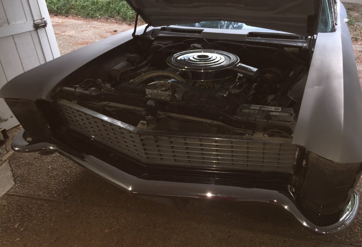

    We got horn!!
    IMG_5198.JPG There have always been some issues with the horn according to Jack and it completely quit on me.
    After finding the relay, I began chasing the wires. Found this loose connection on the relay plug but think it was connected before I unplugged the relay. The horn wire coming from the steering column fails to get from the column through the EZ wiring to the relay... don't know why.:eek: Also could not find a ground on the old relay.:confused: I decided to cut my losses and removed the old relay and replaced it with BWD R132 from Advance... the old standard horn relay that was used for many years. It has three wires. 12 volts in all the time; a wire to the horn; and the wire coming from the horn button.
    I got all that hooked up and still no word from the horn.:eek::mad:
    The old horn was mounted under the engine mount on the driver's side and was nicely tucked mostly out of sight but it has been on the car for some time and also managed to get covered in oil and other road grime. I took it off the car and could not get it to work. I bought a replacement horn and installed it in the same location.
    IMG_5203.JPG We got horn!:)
    One gremlin remains: If the ignition switch is off and the column lock is engaged; the horn might blow!:eek: If move the steering wheel slightly, no horn.;):)
    This doesn't happen when the ignition lock is not on.
    I'm gonna try to live with what I have for now. Of course, I haven't test driven it yet so who knows what might happen?!!:D:D
    Opportunities!:D:D

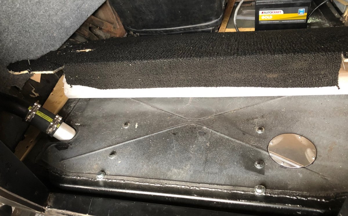

    Not exactly a Cabriolet update, but just finished " roughing in" The spare tire carrier conversion to a locking tool box. I didn't plan to carry a spare tire in it...so why waste the space.:D
    The hardest part of the whole project was getting that diamond tuft upholstery & contact cement off it...wire brush and 3 quarts of lacquer thinner later....:eek: tir1.jpg tir2.jpg tir3.jpg tir4.jpg

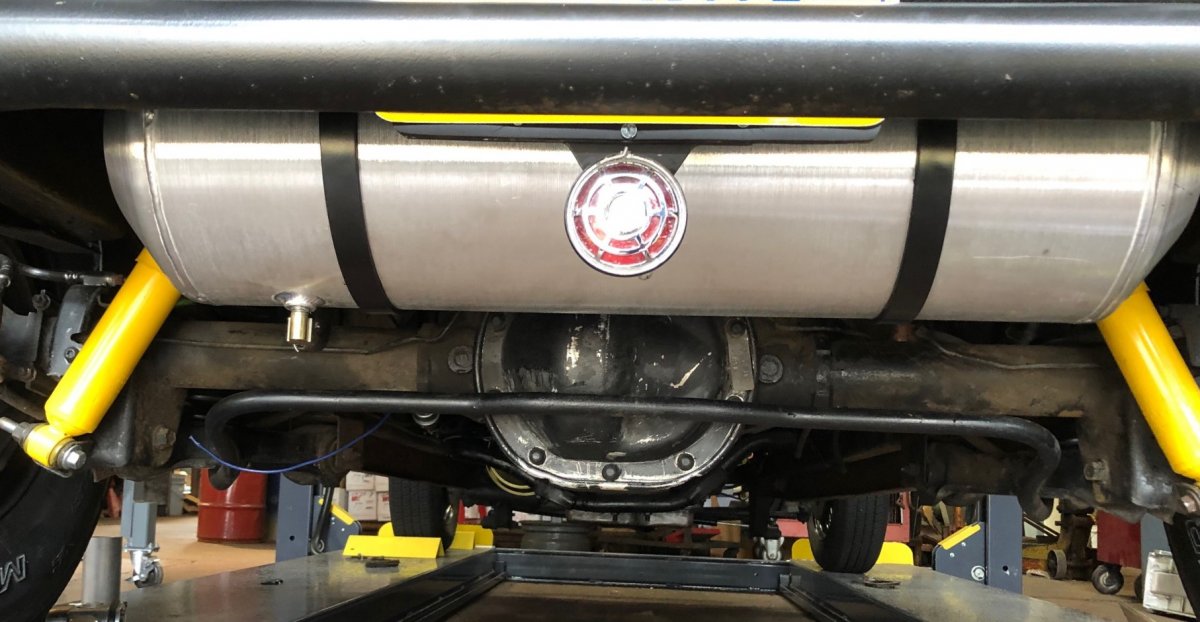

    IMG_5252 a.jpeg IMG_5252b.jpeg Got an update today from the pipe magician saying the fuel system was completed and the car runs!:) He says he is now moving on to the other "opportunities.":D:D
    I can't believe he used that word!:eek:
    When I said I was surprised that he used that word he said he learned it from me!:eek:
    Surprised me! I didn't think anybody really listened to me.:D:D

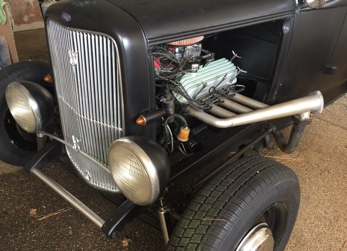

    Went by yesterday to check on the progress and the pipes were done! The pipes are under the taillights if you don't see them.;):eek: I should have gotten a shot of the 2.5" stainless pipe going from the headers to the mufflers. I think the pipes shown above are 2.5", too! Pretty good trick to run 2.5" pipes under such a tight area but I don't call him a magician for nothing!:D:D
    He is still at work fixing up a few other "opportunities":)D) I asked him to address.:)

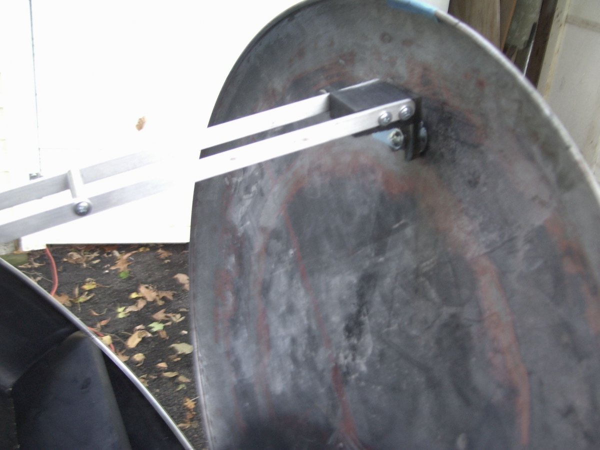

    New Lokar TV adjustable cable for the AOD (Rogers work)
    And of course, the modified spare tire carrier into a locking tool box tir2.jpg
      154.3 KB
      110
      191.9 KB
      109
      111.5 KB
      107
