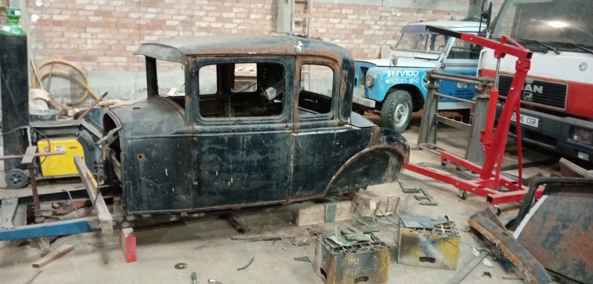

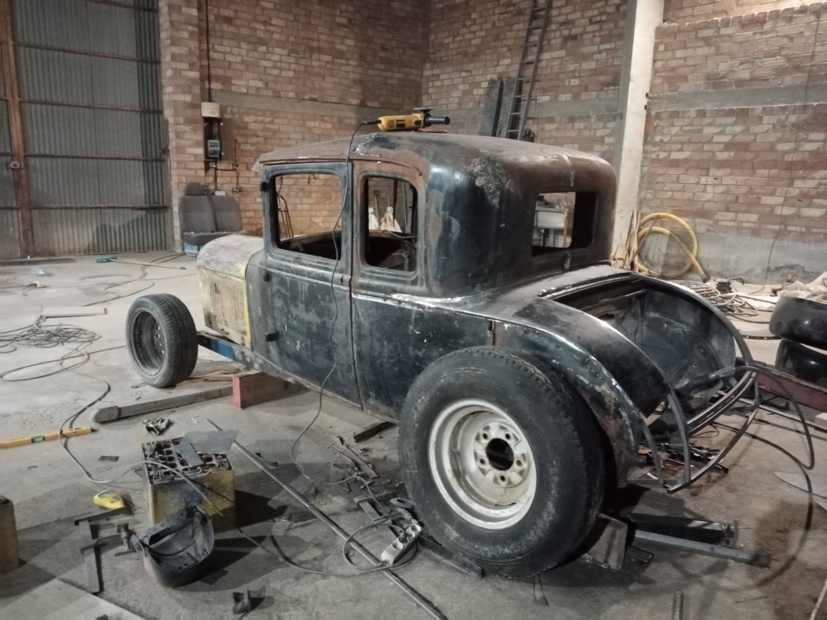

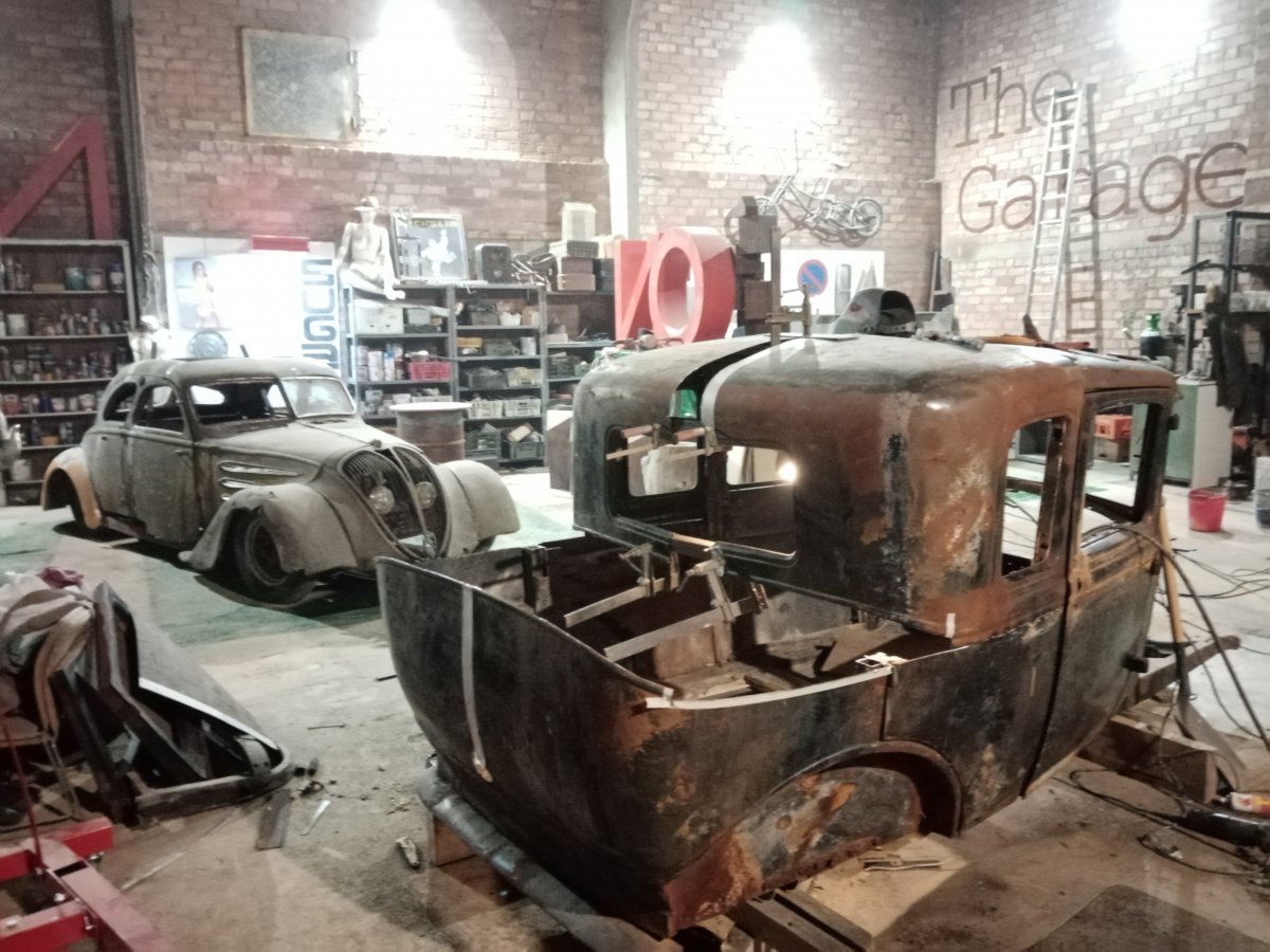

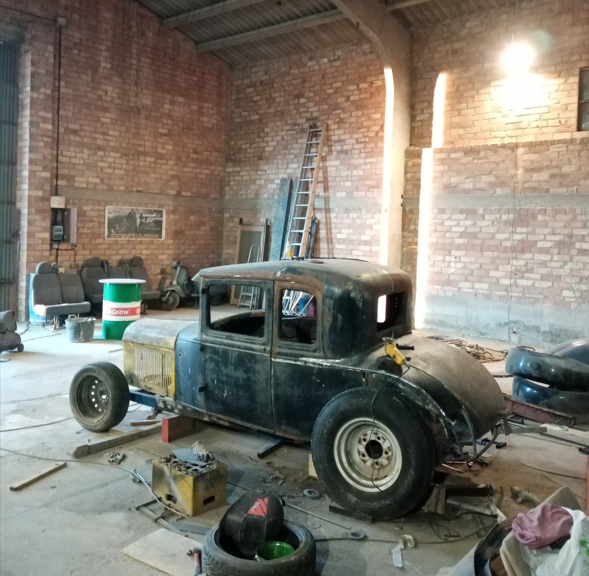

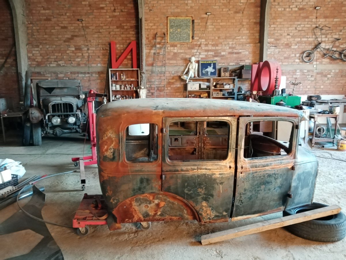

    hi..I thought I´d post a couple of pics of the job I´m on at the moment. First of all a bit of background. I´m in spain..near Barcelona..Ive been playing with cars for ages now along with the steel furniture but this year especially I´ve been busy with a client who pays the bills and makes building a car easier!!. so after finishing the rot on his patina caddy (1950 convertible), he pestered me to build him a rod. now the raw materials for a decent rod are difficult to find in spain, but after looking at various old citroen in france and other local wrecks we stumbled across a solid sedan shell..it was quickly bought and a chassis and wings were found.(miraculously )last week. now I´m a fan of a good sedan but the client only wants a coupe (dream car etc)..so had to get the grinder out.

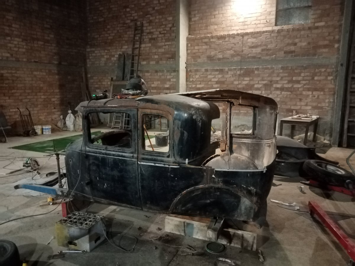

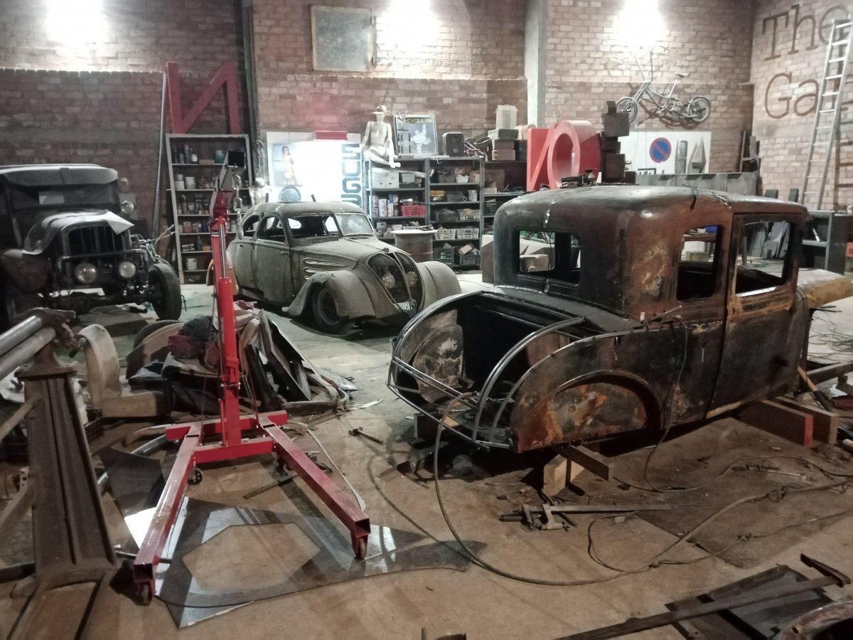

    so i realise that there are loads of subtle differences between the sedan and the coupe (window moldings, rear side window shape etc) but we´ll have to live with those at the moment as the major problem i have is creating the rear quarters out of nothing.
    started with a frame work to get the curved looking ok, and then cladding the parts in (where i can) the old henry J steel. at present this is as far as I´ve got, one side is starting to look passable. the engine is going to be a big old caddy v8 (from the other car) so later I´ll be asking all sorts of advice about positioning of it , reinforcement etc. I hope this is not considered too much as "Heracy" ..as literally all i´m trying to do is keep the client happy and the bills low (mostly the importation taxes from the states..which are a big wedge here)..heres some more pix..cheers sig

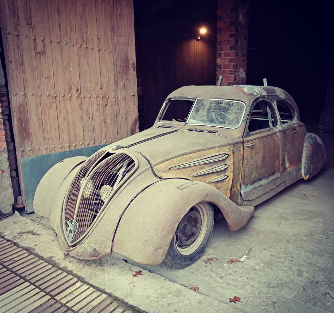

    peugeot 402..also was a sedan..but there was no rear on it barely so was turned into a coupe with the help of the roof of a beetle..heheh IMG_20201128_114031_135.jpg

    That's coming out surprisingly well. I'd work a little more on that roof line, try to eliminate that peak that sits between the two sections. Good job man! Keep us posted on your progress please.
    Stogy and sigfurniture like this.
  12. sigfurniture
    Joined: Sep 28, 2013
    Posts: 132
    sigfurniture
    yep its only spotted together as yet..sometimes it helps to sleep on it after a batch of stitching..i noticed it in the fotos too..cheers

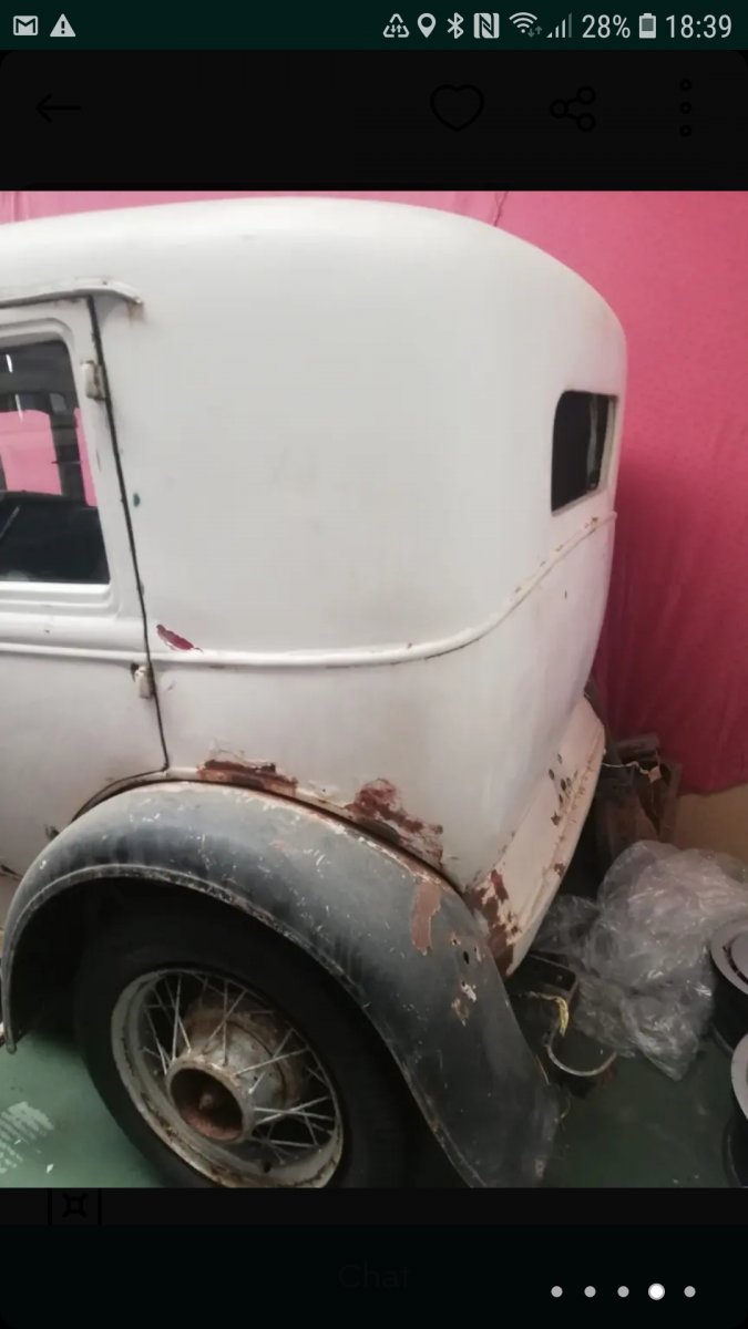

    the second choice was a blind 4 foor..down south..but the seller was a bit of a pirate so we decided no to...but i researched them then and it said they were rarer....the one we´ve got has sharper angles on the windows for sure..and wooden structure inside yes..also a big gap at the b pillar ...also the top horizontal at the side windows is slightly arched..does that mean anything to you?..very cool info boss xx

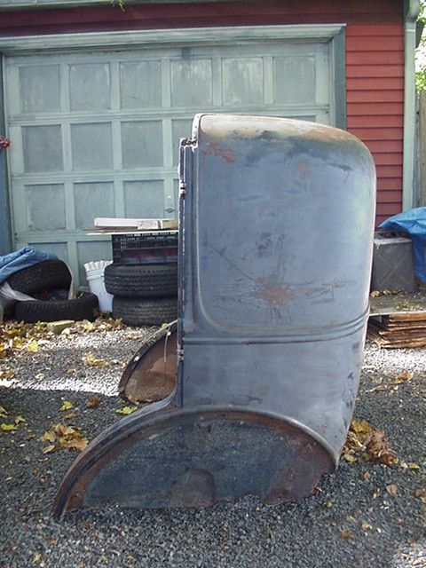

    i see a stock '28-'29 hood...
    the only one that fits is murray, not sure about briggs ?
    Yes Murray's had an arch front to rear top edge of the door... otherwise they would fit a '30 coupe...
    they had a beefy B pillar,
    i have a pair in good condition,
    but i would make mine from rectangular tube steel... if building a Fordor i would use the pillars... otherwise no... pic doesn't show it but both front and rear edges are the same... DSCN6353.JPG DSCN6349.JPG

    this is that blind fordor that i was talking about..from the windows i´m guessing a murray also?..and i assume this is the correct hood?..yes the one thats on at the mo is a left over from the other rod I did Screenshot_20200927-183855_Wallapop.jpg Screenshot_20200927-183904_Wallapop.jpg

    door tops look flat, might be a briggs body...

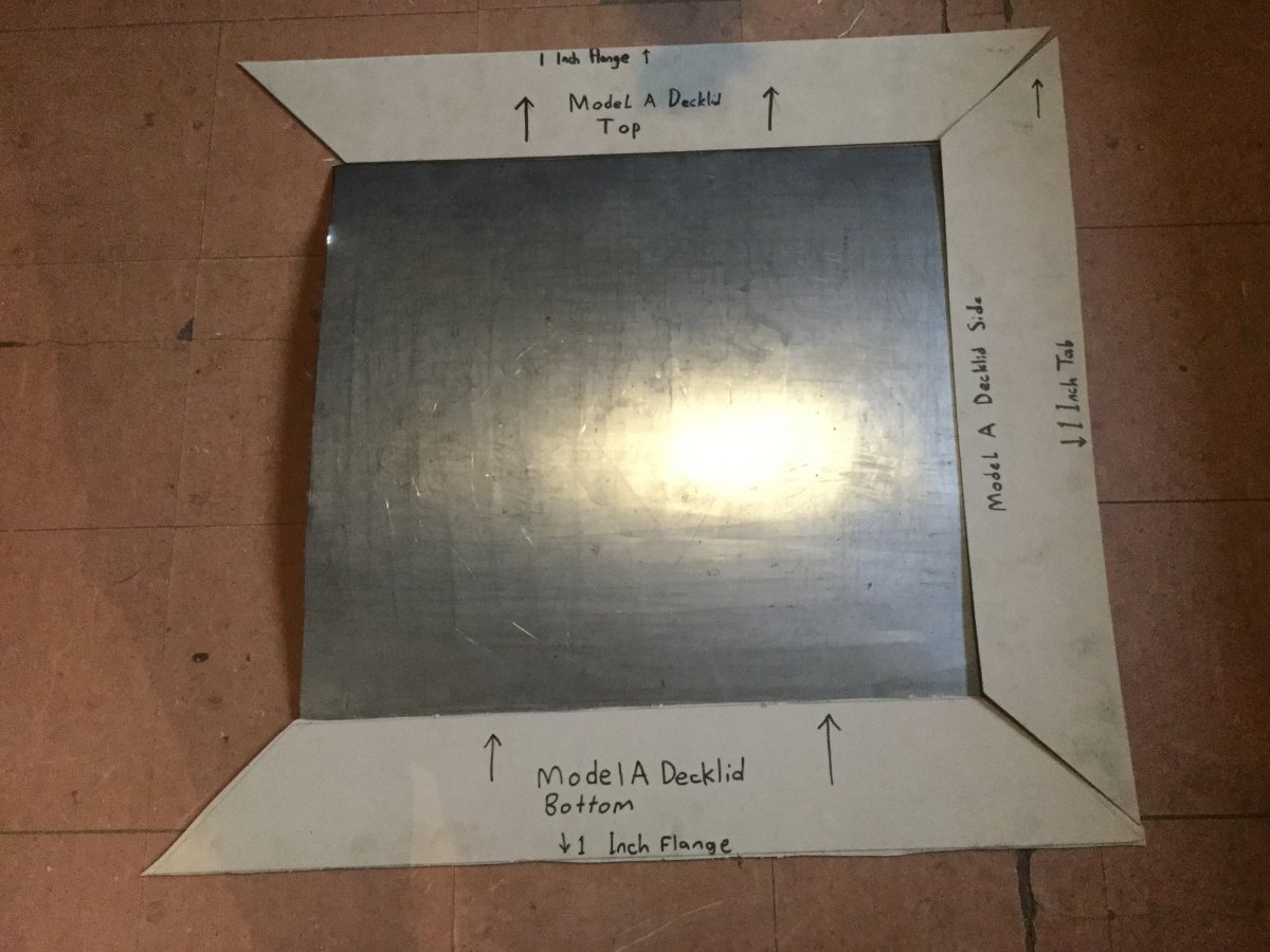

    I am not sure how much help this is but I have been making my own deck lid out of sheet steel. There are four sides and a centre. I used MDF as templates to trace around the sheet metal. The idea is to weld the four sides together, flip it upside down over the center section and trace around it, cut it out and weld it in. 17131D3E-B30D-4880-BC6C-847E9BF8D22D.jpeg

    That Peugeot is a super slippery vehicle looking very much like the Mopar airflows, like the front, hood, widow lines etc. I would surmise that rounds up a total like overall even without a rear view, rally on!
