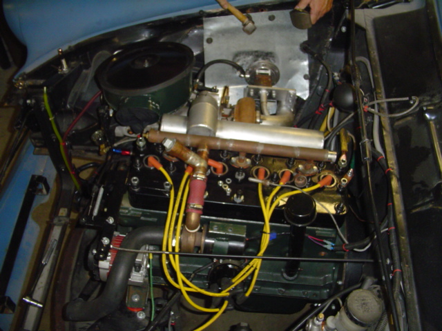

    With the high boost will come head problems and blown head gaskets. I talked to some flathead guys on the salt running Hudsons and they had tried making girdles and long studs to clamp the heads down with some improvement. I decided to design my own. I also spoke with the guys at uncommon engineering in Indy and the late Dick Landy. First study combustion chambers for flattys and decide what appeals to you . I had 9 different Stude heads. I put clay in the one closest to what I liked to modify the shape. I made a plaster mold of that. I took it to a machinist who carefully measured it, as well as the spacing of cylinders, valves etc. in an original head. Then, it was roughly machined into a 1/2 inch thick slab. Then, EDM was used to ease the transitions. Then, 21 spools were machined, each with a ferrule to locate it in the slab, centered over the hole where an ARP stud would go thru. These were furnace brazed into place. Then, a top plate was drilled to sit on the perimeters of the spools, off the "squeezing" surfaces The spools were one inch, so the holes sat on edge grooves on the spools, the holes being about 13/16". So the top piece would bear no loads. Then a piece of strap was fashioned around the sides to close it all off. So the top and side plates were there only to containg the coolant. I made the space large enough to hold 3 times the amount of coolant and put 3 outlets in it, front middle and back to draw the coolant evenly out of the head. Plugs had their own tubes frenched down to the base plate. Everything furnace brazed together. NO more head problems

    When you say furnace brazed I take it the head is made of steel?

    Yup. Steel. Aluminum and flatheads and high boost I think, is asking for leaks. Maybe I'm wrong. I wanted something that would expand closer to what the block was doing.

    If you check out the picture showing the homemade head, you might also notice the reverse flow cooling I did. That will help a little with detonation too. Water/Methanol injection can be done pretty easily with a windshield washer pump and a Hobbs switch. You could also wire a fuel injector to a Hobbs switch that would squirt into the intake under the carb at a given boost level.
