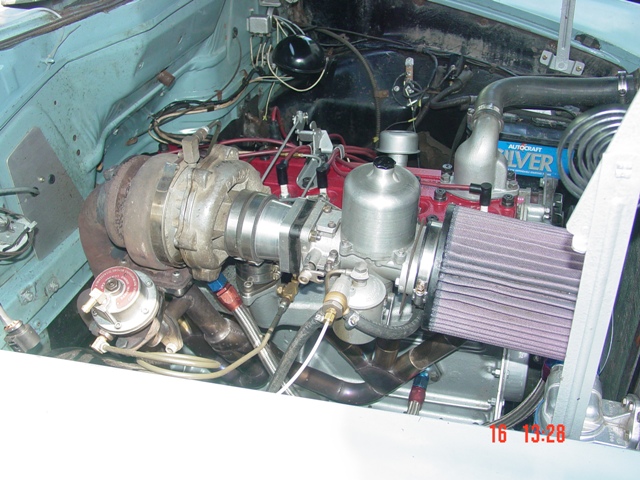

    There are a couple threads on here about this. I just did a search and the one started by KB88 has old pictures of my setup before it was finished on the first page and some more recent pics on the third page. There are also pics of other turbo charged flatheads throughout the thread.

    Greenracer,, Like your setup..

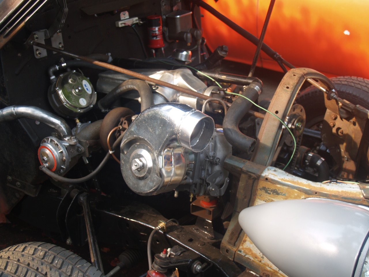

    Here is a 62 Olds turbo on a stock 40 Ford flathead. The idea was that you didn't need high compression or a radical cam. big valves etc. Plus the turbo was a $20 swap meet find.

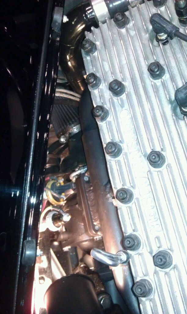

    Use A Caddy flathead, as the exhaust already exits out the top. Yes, the exhaust run right next to the intakes, so use an intercooler. More cubic inches than a Ford, stronger, and they handle HP and boost well.
    The FlatCad will get turbos next year, when we move to a lakester-I'll let you know how it turns out.
