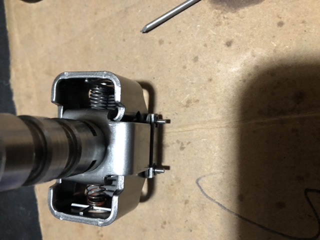

    Brought a new project 1966 c10 home. Has 350/turbo 400 in it. Needed brakework so I salvaged a booster out of 84 k10 and put together to drive. During the drive it would shift from 1st to second fine but wants to down shift back to first . I checked vacuum to the modulator and its good, the modulator appears to have been changed at some point so I pulled the governor. I noticed the valve would move up but sometimes would stick up and not fall down. So I pulled it apart to clean it and noticed the weights and springs are different on either side. Looks like someone used what they had left in a kit. I weighed the wings with weights/springs and they are only a gram different. My question is with different style weights and different springs will this cause shift problems even though they weigh similar?

    probably was built that way originally. if you post close up pics of the crimp on the pins, we can probably tell whether or not it's been worked on.
    I expect your problem is somewhere else. Usually the only thing wrong with a governor on a GM trans is that the plastic gear will break, and it won't upshift at all.

    The pins are not crimped at all. They have indents with clips, which leads me to believe the governor was worked on. I thought all pins were crimped from the factory, I could be wrong though.

    Like Squirrel said, the different springs are probably stock. The light spring gives you some pressure at lower speed and the heavier spring controls the pressure at higher vehicle speed.

    Peelout, I see the weights from the Superior or Coan governor kit in it. It will shift higher at WOT than it would with stock weights. The springs, like others said, will affect the low speed, light throttle shifts.

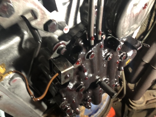

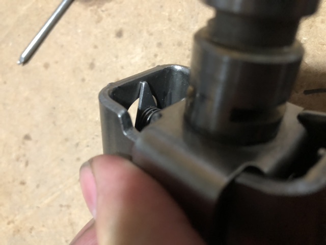

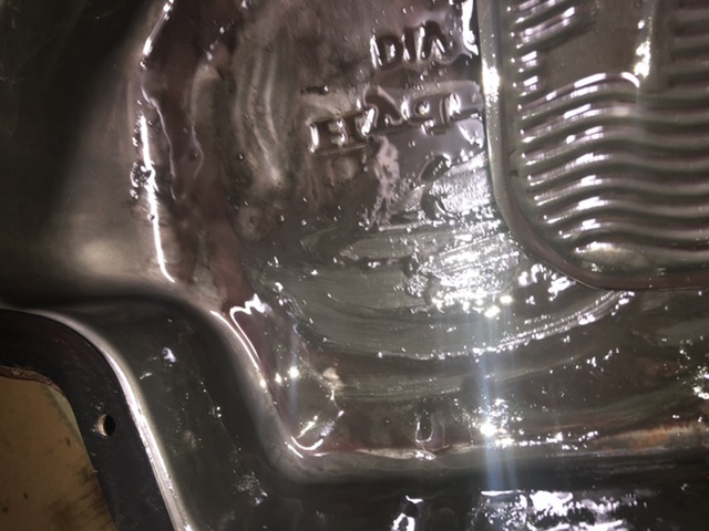

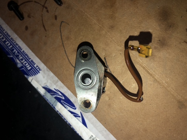

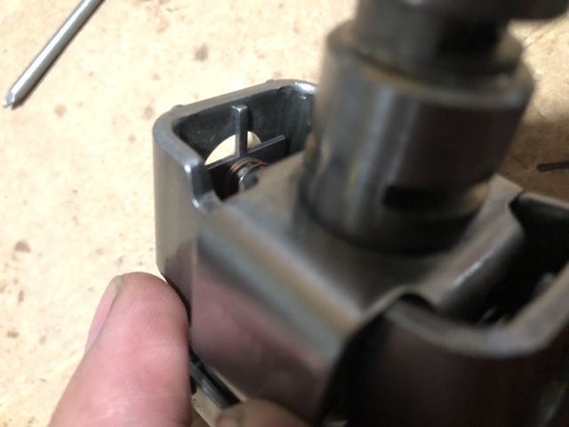

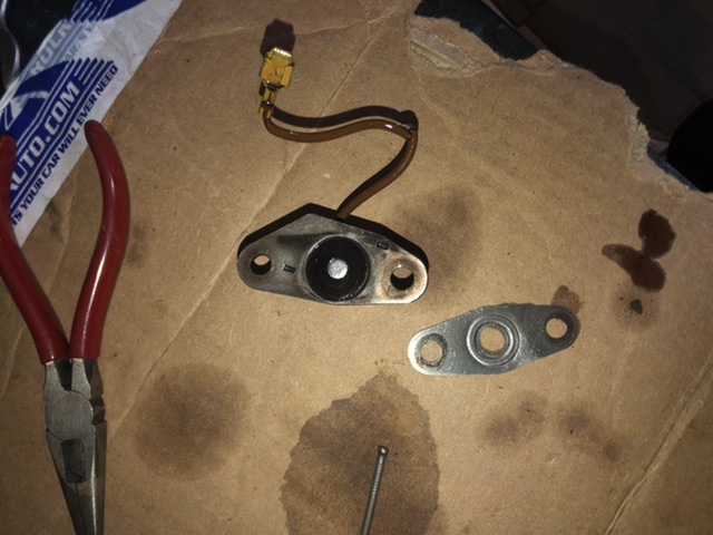

    Ok, here is what I found. Aftermarket solenoid with pinched wire, also when I removed it the shim fell out. I watched a guy on YouTube (YouTube.... I know, I know) say not to use the shim with aftermarket. When I got the solenoid on the bench the shim does not line up correctly with the top of solenoid, will this cause problems? I also attached a pic of the pan had sludge in the bottom and filter not sure what amount of sludge is ok. Thanks again
    Elcohaulic likes this.
  17. squirrel
    Joined: Sep 23, 2004
    Posts: 49,479
    squirrel
    that is the later style solenoid, with a rubber seal built in, it should not have the metal gasket. Make sure there's no dirt in the orifice in the solenoid, keeping the needle from closing all the way.
    If the sludge is fine powdery stuff, it's probably normal wear. If there are strange chunks of metal or fiber, then things are coming apart.

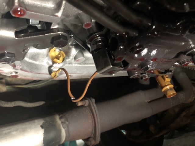

    Want to thank everyone again for their help. Not sure exactly what did it, but I dropped the pan replaced the kick down solenoid, vacuum modulator , filter and had a good drive. :)
