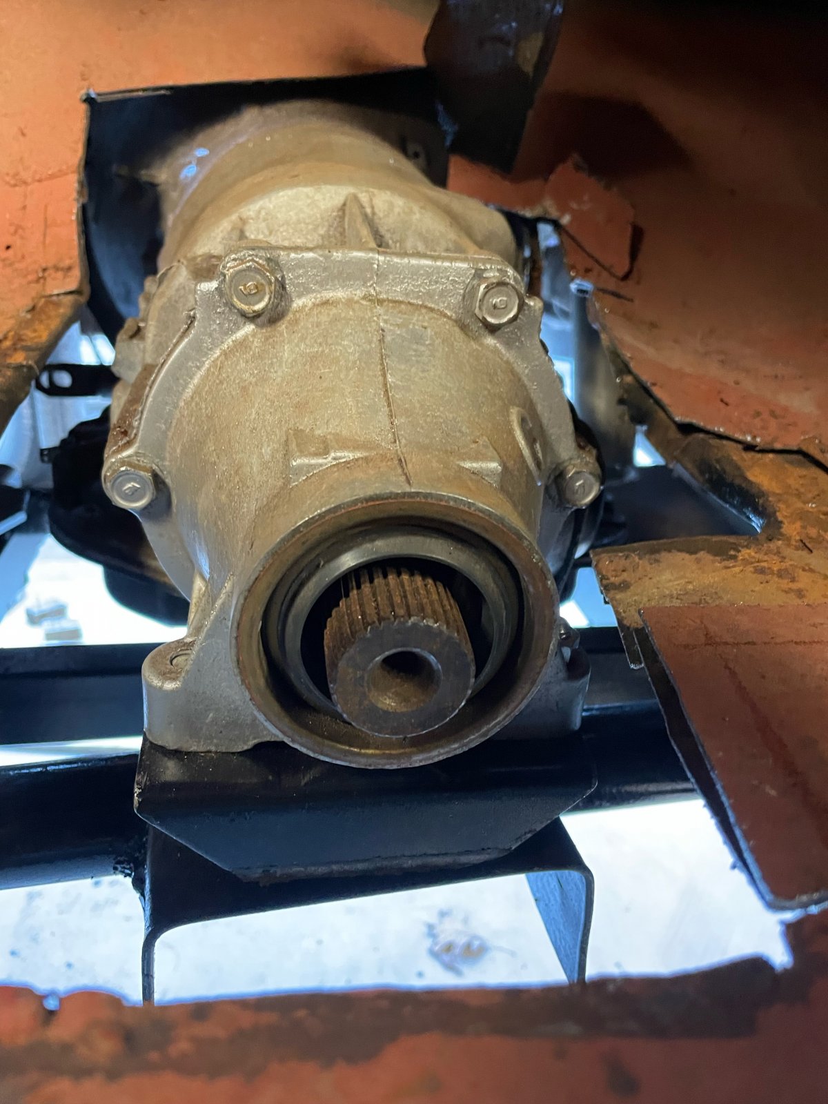

    I have a TH400 out of a Buick and it has a larger output shaft with more splines. It also has the short tail housing. IMG_1309.JPG When I had my driveshaft made I specified that the trans was out of a Buick. Instead of checking the driveshaft guy found there were 2 slip yokes available and ordered the one that most applications used. Of course it was the smaller one and wouldn't fit.

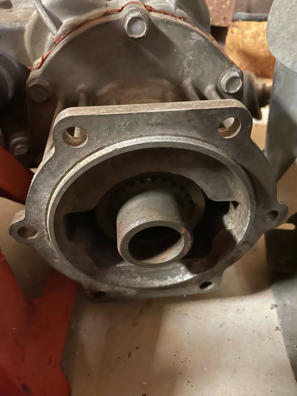

    May just have to drive a dual quad 455 with 4:11 gears image0.jpeg image1.jpeg

    I'd start by taking the adapter off the overdrive, and see what the coupler looks like.

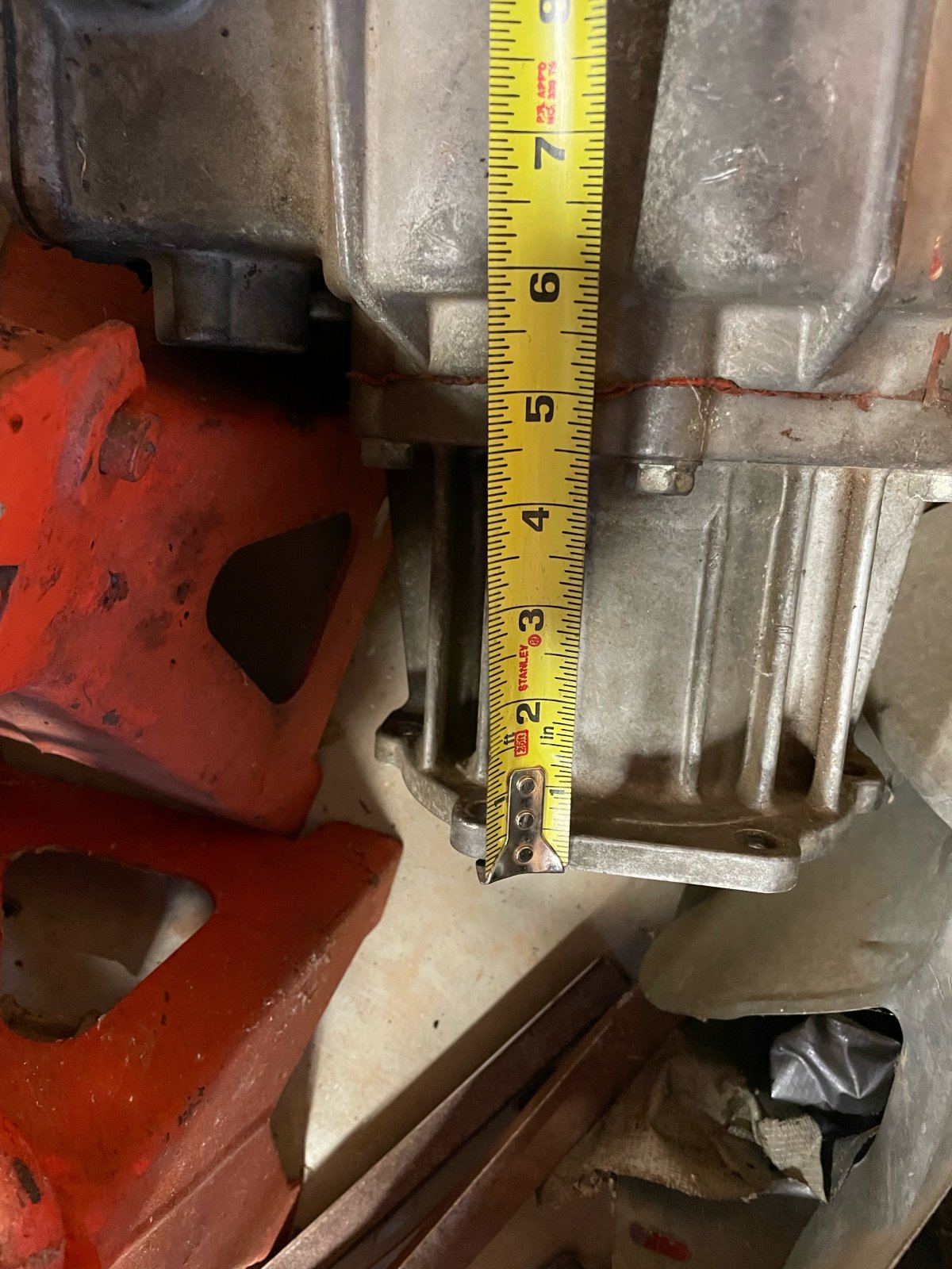

    Can you post a side shot that shows the adapter housing that couples the transmission and dual range box together?
    I want to compare it to the TH400 one, to see if it is different in length.
  24. 34Phil
    Joined: Sep 12, 2016
    Posts: 558
    34Phil
    adapter is 5 image11.jpeg image9.jpeg " long
  25. gimpyshotrods
    Joined: May 20, 2009
    Posts: 23,330
    gimpyshotrods
    5-inches is the correct length for a TH400, without a Cadillac output shaft.
    It would appear that your input gear is incorrect for the dual-range box.

    Inside of an Doug Nash 4+3, found in the Corvette, there is also an input sun gear.
    Not sure if that would inadvertently fit the sun-side of the dual-range box, or what spline it is.
    There was a T-10, which was the 4 ahead of the +3 in the 4+3 arrangement, and there did exist T10's with a 27-spline output. That would make for a 27-spline input sun gear there. The gear you pictured might be a 4+3 part.
    Are you sure that you counted to 28 correctly? On female splines, you would want to count the valleys, not the peaks, to get the spline count for the shaft that goes into it.
  28. gimpyshotrods
    Posts: 23,330
    gimpyshotrods
    Sorry, my coffee just kicked in:
    That input spline shell is just randomly stuck in the housing. That is not where it goes.
    Take the adapter housing off, and you will (should) see the proper one sticking out of the dual-range case.
    This is the stick out of the typical TH400 shaft:
    Contrast that to where that splined part is, in your picture. That splined part, whatever it is, would be hitting the speedometer drive gear, and would be past the TH400 splines.
    The end of the TH400 output shaft would go directly into the input sun gear on the dual-range box, roughly 5-inches past where it attaches to the TH400.
