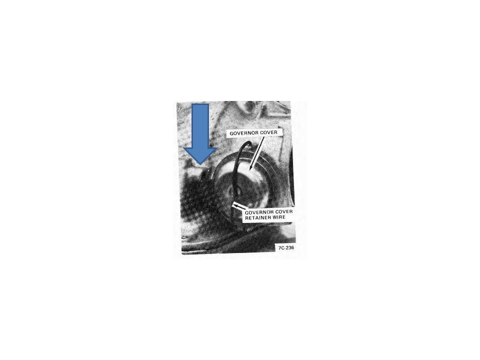

  4. awd_maine
    Joined: Sep 6, 2008
    Posts: 29
    awd_maine
    from maine
    from back to front it's the speedo cable the governor and this hole. i saw a pic this morning, let me go find it and post it in a few
  5. awd_maine
    Joined: Sep 6, 2008
    Posts: 29
    awd_maine
    from maine
  6. I've never seen one leak there.....TTT
  7. squirrel
    Joined: Sep 23, 2004
    Posts: 56,077
    squirrel
    that's the pivot for the parking pawl
    I think it has a cup plug there and on the other end of the shaft.
    That'll be fun to fix. Might see if you can clean it up completely, and put some JB weld in the hole...

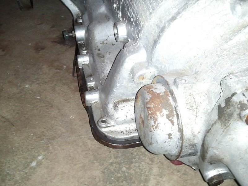

  10. Don's Hot Rods
    Joined: Oct 7, 2005
    Posts: 8,319
    Don's Hot Rods
    from florida
    If no one comes up with the info before tonight, I have two th350s at the shop and can look at them and take a picture. I will be over there after 6 pm.
    Don

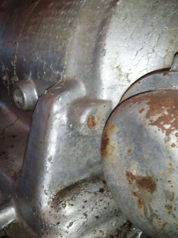

  12. mattraff
    Joined: Dec 16, 2011
    Posts: 11
    mattraff
    From the one on my garage floor - If this is the hole you are thinking of, it looks solid, or at least plugged to me...
    Nothing was connected here when it was in the truck & running.
  13. squirrel
    Posts: 56,077
    squirrel
    The hole is 3/8" and has a cup plug in it, staked to retain it. You might want to clean it and inspect carefully to see where the oil is coming out. It's possible the case is cracked. If the case is not cracked, you can fix it...but it's going to be fun to try to remove the plug. Might be able to drill it and screw a sheet metal screw into the hole to pull the plug, but you probably want to remove the staking first. And you need to pull the gove cover to get a straight shot at it.
    I think I'd do the epoxy trick if I was working on it.
