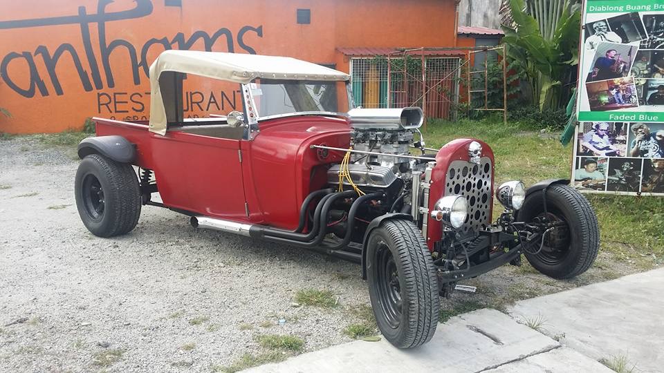

    I put a Weiand tunnel ram and twin 600 Holleys on my RPU. No advice to give really as I never ran it to the max at all, or set it up too well to run max power, roads were too screwed up where I lived.
    Couple of car guys, engine builders, I knew were a little surprised I had it idling so smoothly at 700rpm.
    It sure looked the part and ran well enough when I stood on it a bit occasionally.

    I was told to expect zero low end power, no pull below 3000rpm, flat spots etc, but mine revved and took off far better than it ever did with a stock Chevy corvette manifold and a single 600 Edelbrock carb. Instant power as soon as I hit the throttle.
    The Edelbrock would just make it fall flat on its face if you stepped on it hard at low rpm.
    I only fitted the tunnel ram for the ‘bling’ factor, but I was very pleasantly surprised just how well it did run. :cool::D

    Yes, mine would take off like a scalded cat from crawling along at idle, to spinning rubber and howling tires, just by stamping on the throttle. The rumours about no power below 3k are just rumours.
