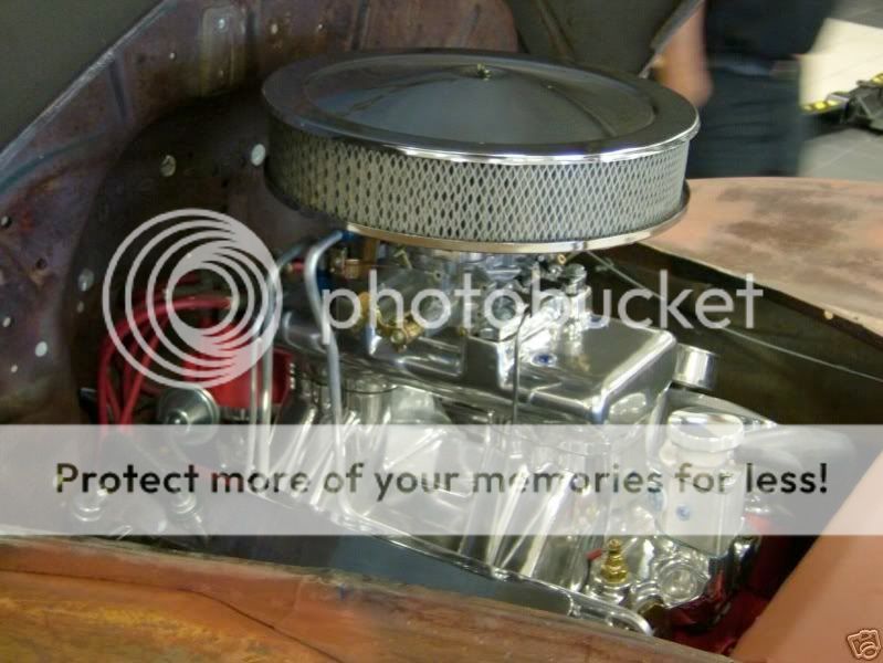

    I recently fitted a Weiand tunnel ram with dual Holley 450cfm carbs to replace the single top and Edelbrock 1406 600cfm carb that was originally on the Willys gasser engine. Engine is a pro built 350 SBC with ca 420hp. Trans is a TCI 350 - don't know torque converter stall but guessing 2400 rpm. Ignition is MSD pro billet distributor running manifold vacuum with MSD 6200AL and MSD coil. The Holleys have been completely rebuilt and baseline settings set as per recommendation with Holley. Fuel pressure is set at 4 psi. The engine fires on contact with one pump of gas pedal and is set to idle at 1300 rpm, however it will stall repeatedly until warm and as soon as a gear is engaged it stalls out - even when the coolant is fully warm showing 180˚. I have to rev it to 2500 rpm to get it to move and if I drop below that it will stall out.
    Previously with the single Edelbrock 1406 on the same tunnel ram with exactly the same ingnition engine/trans etc. the car ran fine - started right up, ran and did not stall with a 1200 rpm idle speed in neutral - 900 rpm in gear. Visually it looks far better with the dual Holleys and before i revert to the Edsingle edelbrock, is anyone here running dual Edelbrock 1403 - 500 cfm carbs on a tunnel ram on, and if so what are your experiences? I admit to being a mechanical moron but I have never been a fan of Holleys for the street and this saga is only reinforcing my doubts. Any insights or help would be much appreciated....

    Not surprising, you're going from a single carb with an air valve in the secondary, to a pair of carbs with what is probably direct acting secondaries, but they are not double pumpers.
    When you open the throttle, lots of air enters, but it's not moving fast enough to make fuel start flowing. Lean bog.
    Show us a picture of the other side of the carbs, please.

    Here's the other side - mechanical fuel pump was spraying fuel out of the base of the carburetors before the fuel pressure regulator went on - never had that problem with the Edelbrock without a regulator though....
