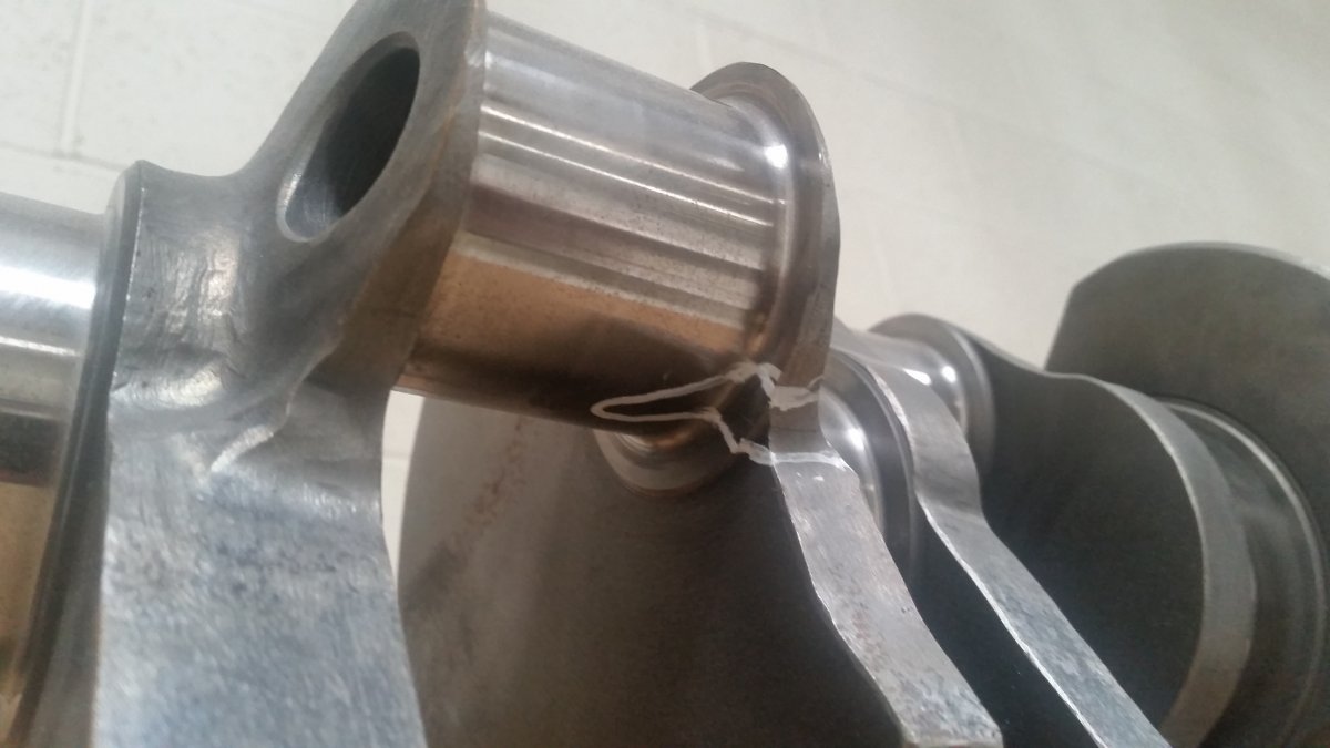

    It looks like the journal lightening holes on the cracked crank are quite a bit larger than FORD used to do it, and the contours of the crank throw has been fussed with a bit and left sharp, too. I wonder how long ago it was magnafluxed. That crack was tiny several thousand cycles ago.
    Like others said, the quality of the grind can cause a good crank to die young. Good radiuses/fillets but full of grinding/heat "checks" ( CRACKS!) can really get the party started.
    http://www.douglasmotorcycles.net/aa-files/images/doug/articles/crank_tour/cracks.jpg
