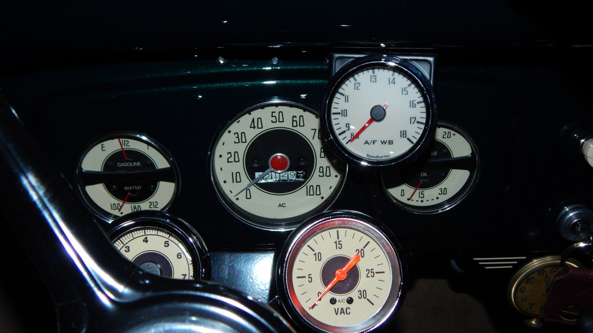

    Here you go, my Speedhut, stand-alone wideband. My setup runs better then it ever has since adding the gauge, just plan on a lot of test drives and carb work. I am running dual Carter W-1s so tuning was double the work. The real trick is knowing which way to tune and what parts to purchase. I had to shop e-bay for metering rods, I think I tried 6 different rods per carb with float adjustments in between, like I said, a bunch of test drives. You will know in a few miles which way to start tuning, it's that fast. I am running on the lean side since the 250 isn't a race engine, so I tuned for mileage and efficiency. All the raw fuel smells are gone, the exhaust smells much better, and it starts right up. The good thing about the Carters is the three step metering rods, so I could tune for each step of the rods. Your Holley will be a little tougher to tune since they only use jets.
    Speed hut makes it easy to install, with only power and ground wires, one light wire, one bung to weld in, and routing the cable into the car. They also offer lots of free options to make the gauge unique to your car, or they can match the OEM gauges for extra costs. I no long watch the vacuum or tach, but since tuning, the vacuum is much higher at road speeds.
