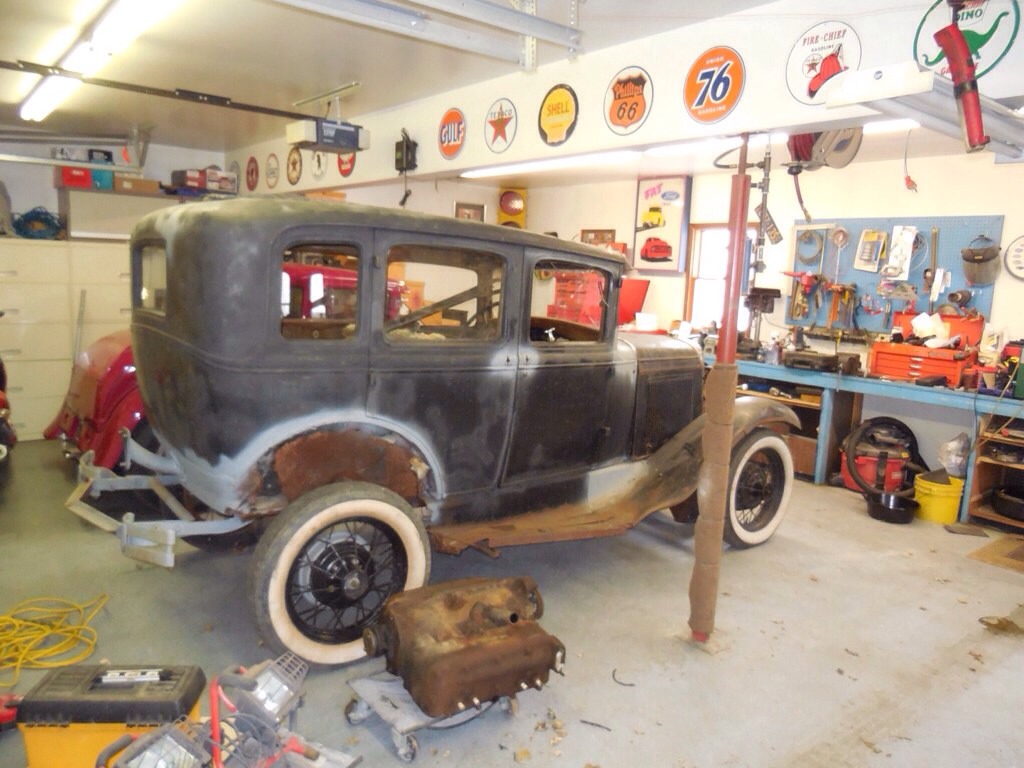

    Great build! You are really getting me pumped up to get going on my 30 4rd sedan build. I will be using a lot of your ideas on channeling the body. I am going to try to save space for the rear seat, so it will not sit quite as low as yours. Here is what I have to start with. ImageUploadedByH.A.M.B.1388325612.445472.jpg
  5. Thank you, looks like you got a nice car to start with there. I've been block sanding body filler for a few weeks now, so no good pictures to post now.
