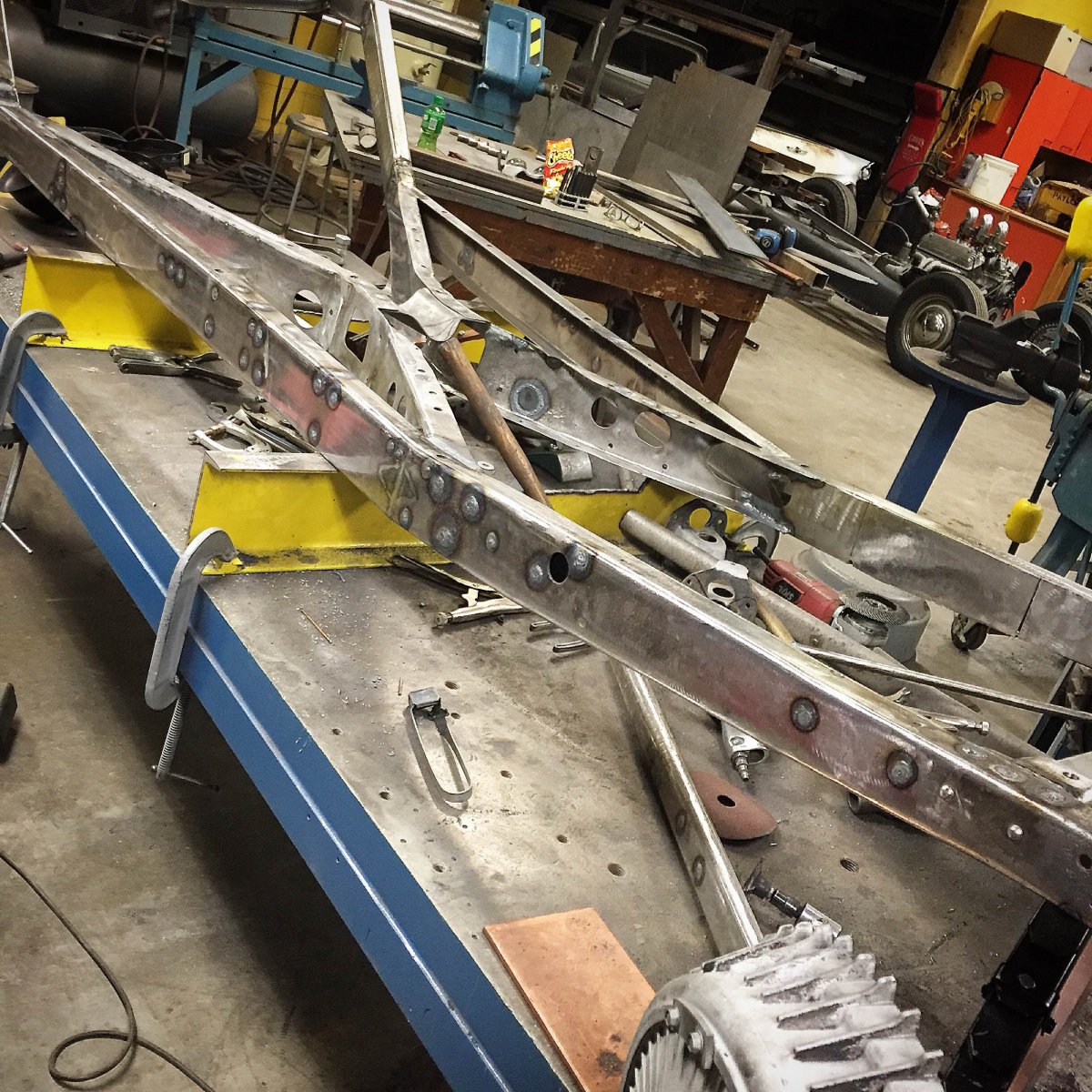

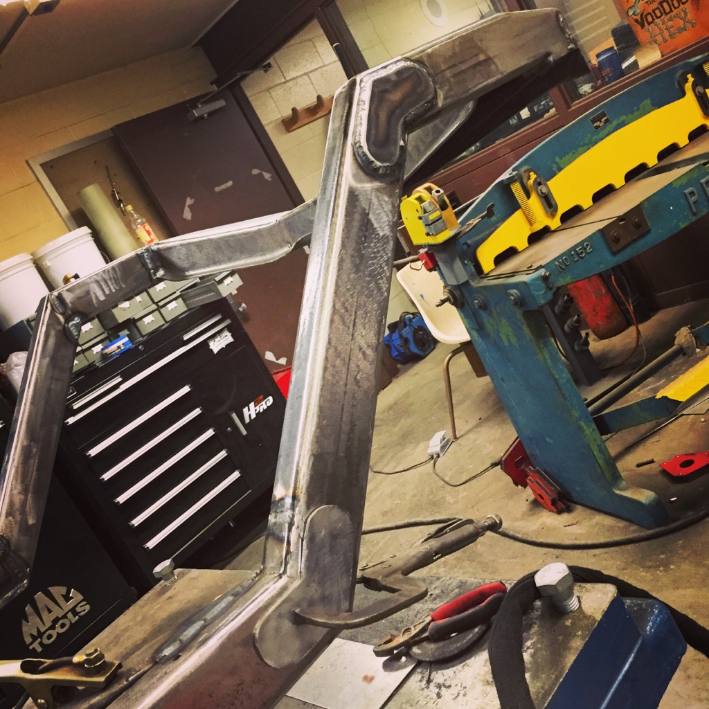

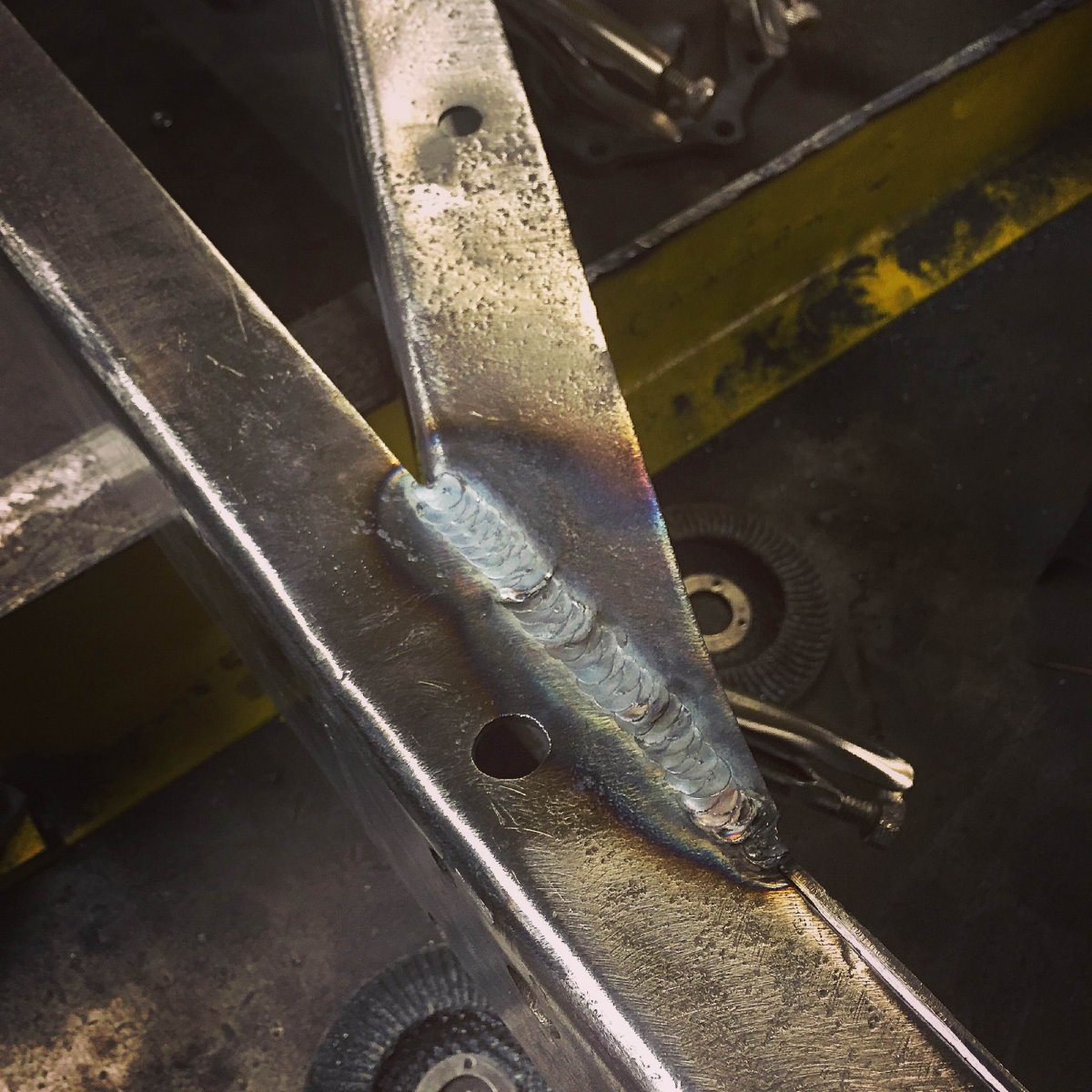

    I'm getting pretty excited to see this on all fours again. I've been coming in for a half hour to an hour whatever I get after school to weld for a little bit and then I head home. I've been trying to get the chassis welded up and all of the hundred plus holes filled. I've been tigging them shut with a copper backer and big filler rod. The big holes I make a plug and fill it. I just burn them close with a flap disk and then finish flush with a roloc and then I'll D/A them.

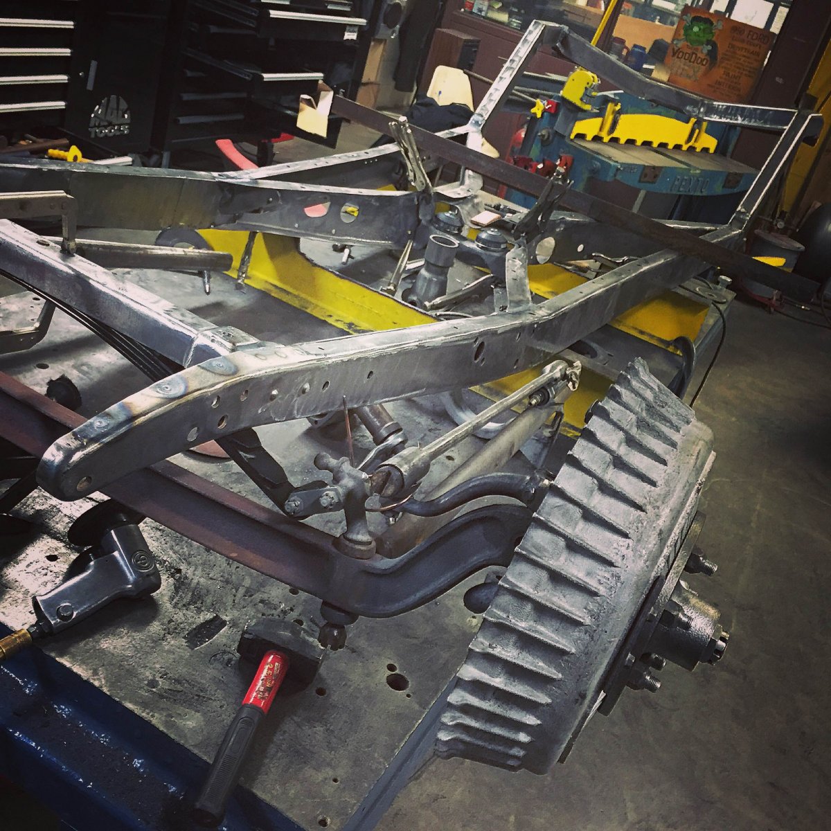

    I test fit the front and put some pressure on the spring so that I could get an idea of where the bone mounts might end up.
    The frame sure stiffened up with the X-member installed.
    The next big step is the rear end.

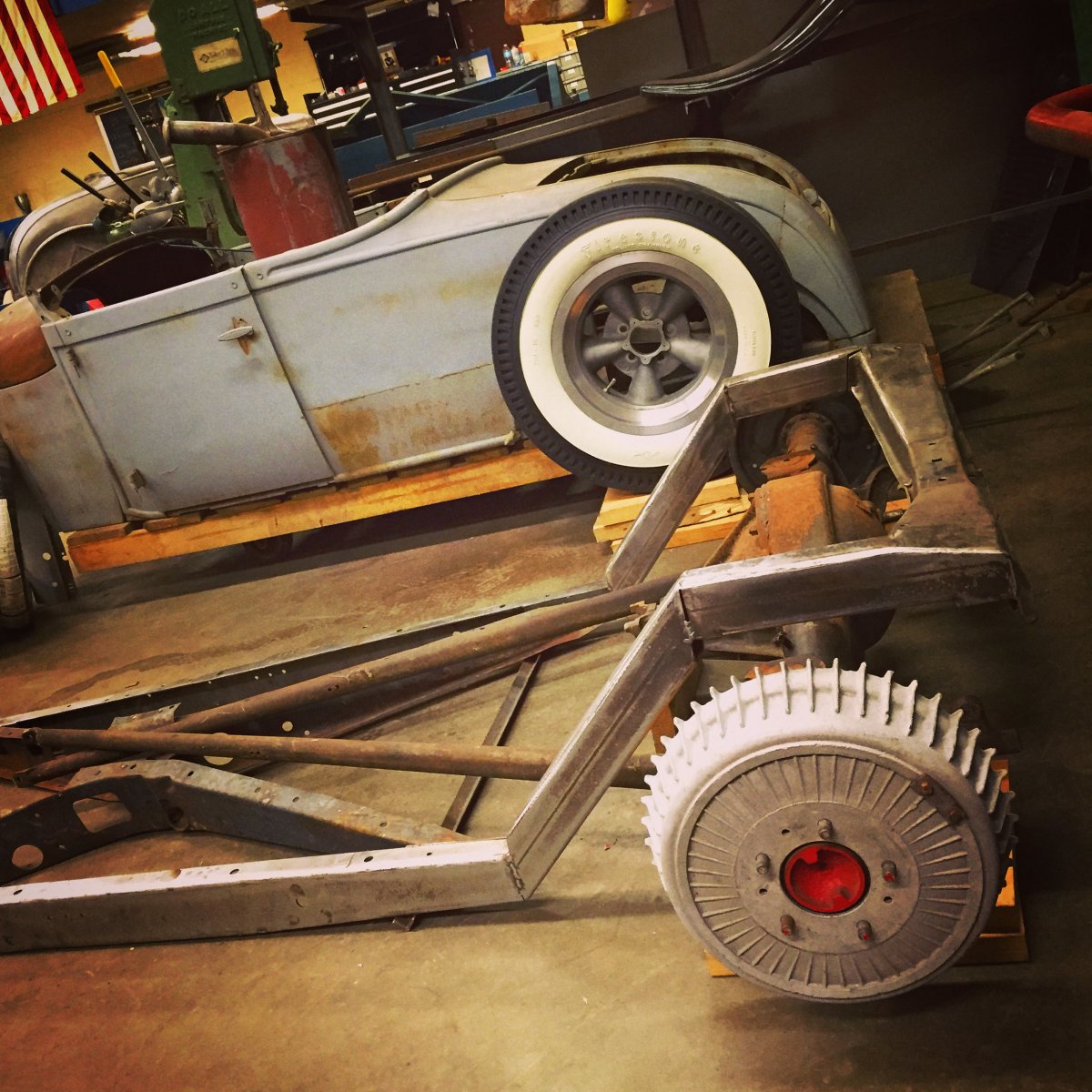

    I just bought a beautiful pair of Buick drums for the rear. I'm going to re-drill the rear bolt pattern on the olds rear to small bolt ford to match my mags... along with re-drilling the drums to the same pattern. I'm going to adapt Lincoln zephyr backing plates to the olds rear and make brackets to hang the 36 bones on it.
    This is an old pic from my album but you get the idea of how the rear end will look- the bones will mount in the center of the X right at the U-joint
    Can't wait to setup the rear end!

    Because I drilled holes for the new bolt pattern where those holes were and a file is good enough.
    @alchemy
    I used a 1/2" copper backer and did not weld them all at once- I'm pretty confident I don't have any warpage that I would warrant a lathe. If I'm wrong I'll report back.

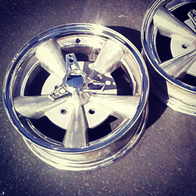

    I had to get a shouldered stud to locate the drum- they only had three at napa rest will be here tomorrow! Stoked! Getting mags back tomorrow too- so I'll be cleaning those up and mounting tires!

    are you gonna make a spacer ring for the drum to center on the axle hub? I just would trust the studs centering it. concentricity is out friend!

    I could easy enough! Didn't think of that- good idea- I'll cut one on the lathe-
    If you do decide to do it I'll have Bryan drop off some rings for the backing plates- @titus I had a few made up. I'm doing this same thing on my coupe.

  21. Ugh! Those slicks though!!
    Tuck likes this.
