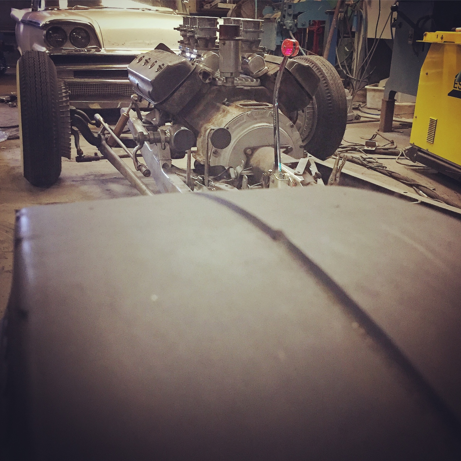

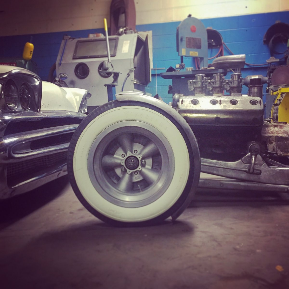

    Been obsessing over the shape of the front cycle fenders- I rounded them off, didn't Mikey likes it..., then squared them off a bit with rounded edges- making little vents on the top to crown them a bit..
    I want them to run about a full third of the wheel from the center back as close to the tire as possible-
    the rears I plan to make more squarish and will only run about a 1/5 or less of the slick- really small.

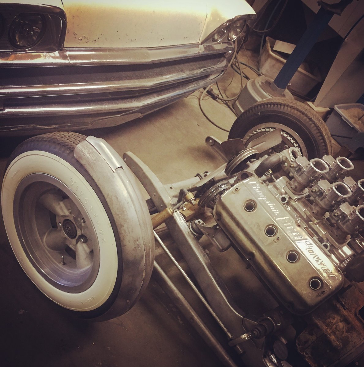

  18. Any scrub line concerns based on the last picture?

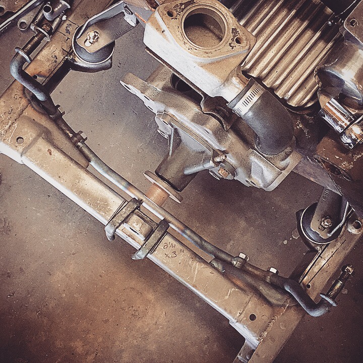

    1. Early Hemi Tech
    Going through the front end today-

    1. Early Hemi Tech
    Connected the shock mounts with a custom shaped bar that follows the crossmember- will finish and fill the gap with a lip on the back of the front crossmember-
