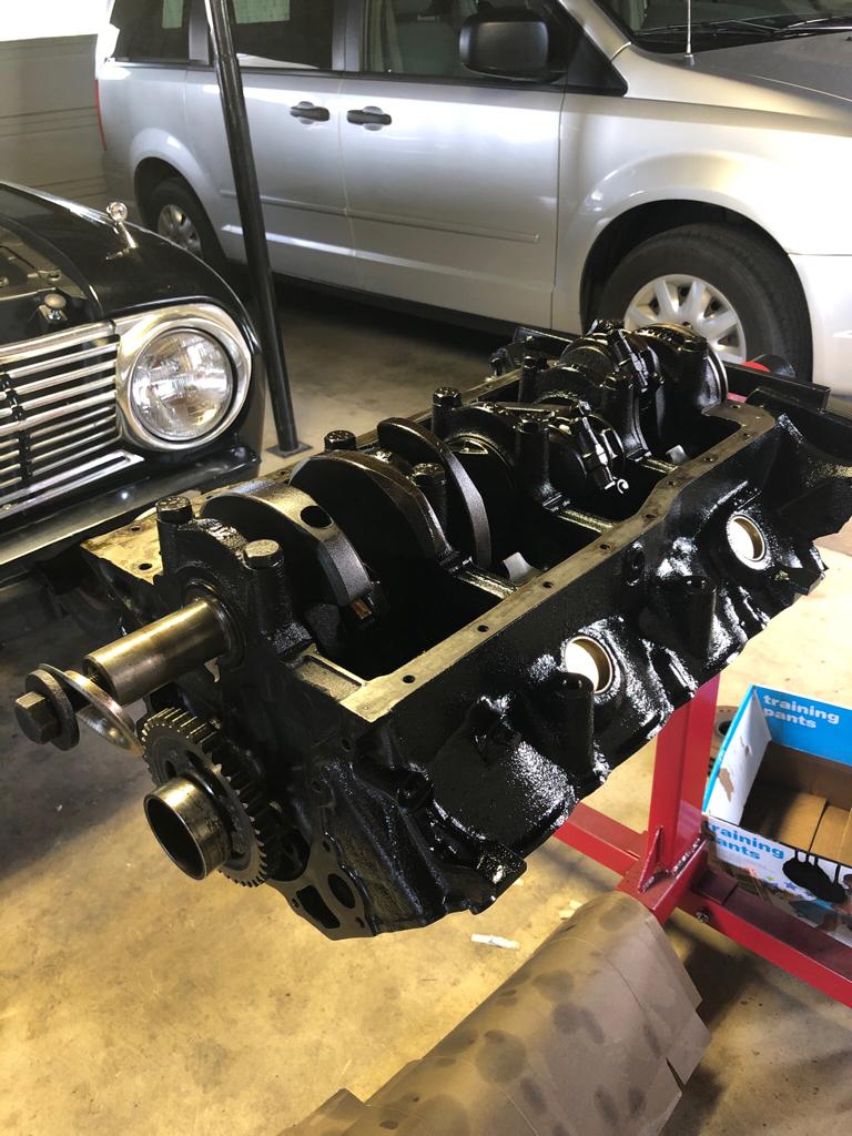

    Ok, posts are more enjoyable with pics:[​IMG]

  21. George
    Joined: Jan 1, 2005
    Posts: 7,370
    George
    If that photo is current the cam plate is still on!
  22. oldiron 440

    Fisher400
    Yup, that comes off with the timing cover
