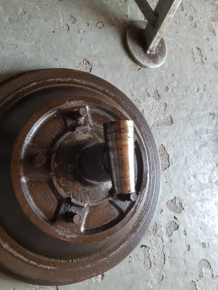

    Two of the rear lug nut studs wouldn't hold the torque and on the other side the hub went in too far, causing the drum to rub on the backing plate, so both hubs had to come off again.
    This would be really difficult without my original hub puller.
    So I replaced the two defective studs and installed a shim on the other side which did the trick. No rubbing anymore. 20180510_110049.jpg 20180510_110057.jpg

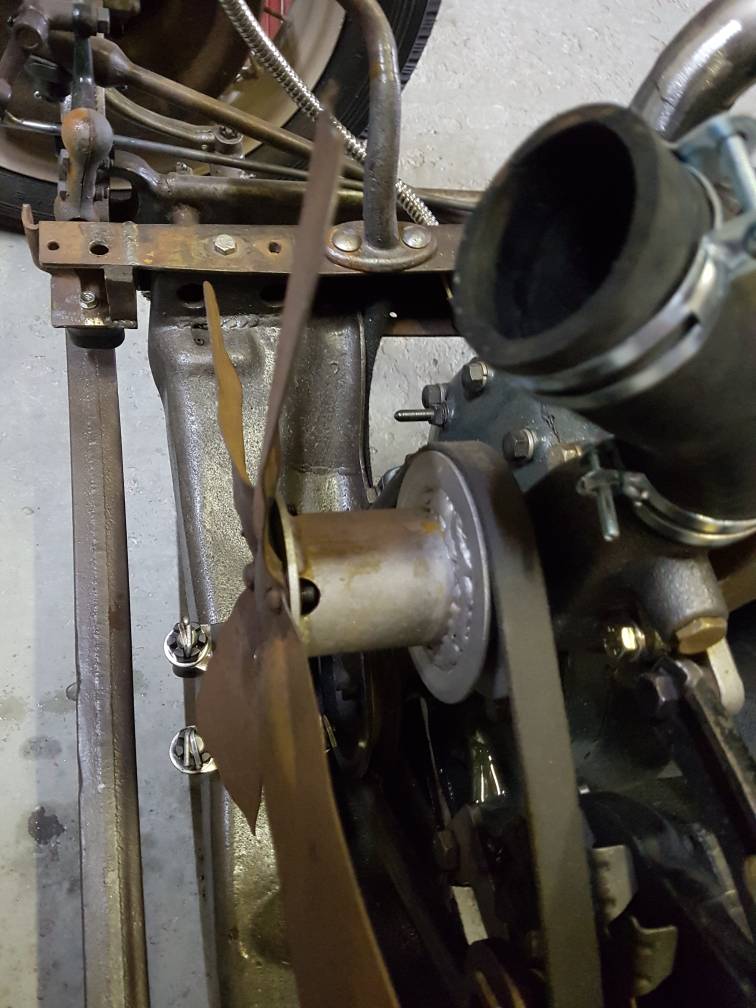

    I was over thinking the fan problem. So tried a new approach. I made up an adapter for a Model-T fan out of a section of 1934 torque tube and welded it to the water pump pulley. The pulley is cast but I think I got it welded safely.
    After that I figured I could try and start the car so I filled the cooling system with water. Unfortunately my cooling system turned out to have more holes in it than Bonnie and Clyde' s '34 Ford.
    My beautiful radiator has holes in it too. So tomorrow it's being collected by my radiator repairer.
    My water pump adapter is leaking a bit so I'll have to weld that a bit more. And the block outlet was pissin' water out so I'll have to address that too.

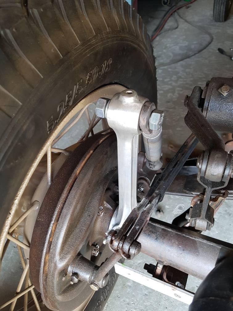

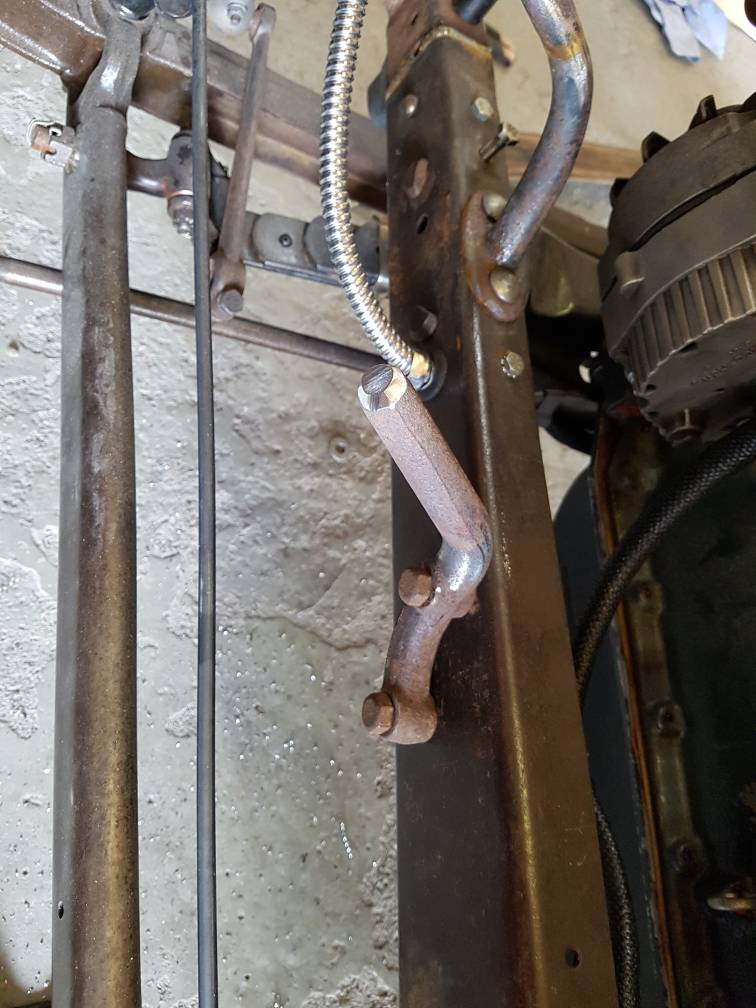

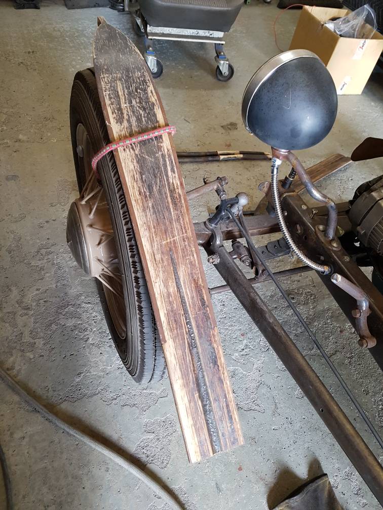

    Well. The story goes that the man who built this jalopy in the 30s kept it. By the early 50s he started to get some fender citations so he decided to fit fenders.
    He found an old pair of skis he hadn't used since the 30s.
    The rear fender brackets were attached to the rear axle. They're fabricated out of a pair of 1932 Duesenberg J Con rods triangulated to the original shock studs using a pair of cut off 1932 rear wishbones welded to a pair of cut down 1932 shock dog bones.
    The front mounts are fabricated out of s pair of F1 front shock mounts welded to cut down 1946 front stabilizer bar.
    Not finished yet but getting there.
    20180521_164946.jpg 20180521_164951.jpg 20180521_165000.jpg 20180521_165006.jpg 20180521_165020.jpg 20180521_165036.jpg
