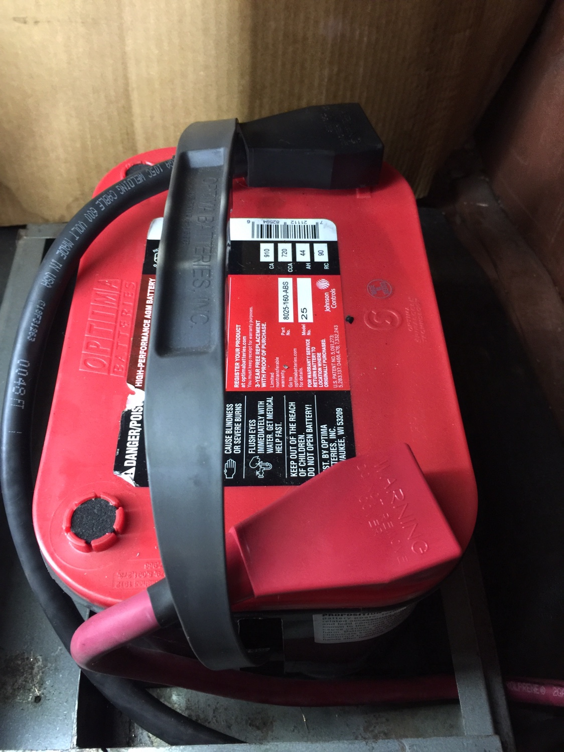

  1. Owner Bill and I came up with this slick answer to a problem. How to mount your battery in the trunk and still look cool
    Bill found this cool old Craftsman skill saw box, on eBay. With some slight mods, it was perfect.
    Ran 2 gauge stranded wire, from starter, to a HD kill switch. Then from switch into box. Engine grounded to chassis in front and battery grounded to chassis in rear.
    Naturally grommets were used, where all cables pass through metal.
    Rebel wiring harness is next for this Hemi powered ‘32.
    Previously had small gel battery under passenger floor. Not a fan
    JT

    Looks good, but a couple of suggestions. :)
    The switch really should be accessed from inside the car for the quickest battery dis-connect.
    The battery box should have some ventilation, because the Optima can out-gas if over charged.

    Could you louver the backside of the box that doesn't show?
    My brother and I were just conversing about the same cable routing as you are using. Wonder if the frame steel will carry the electrons as well as a long clean cable would? You and he will soon find out.

    might want to be vented outside the trunk, like, a hole through the floor?

    Squirrel, do battery gases rise or fall? For some reason I thought they were lighter and the vent would have to be high in the box.

    kInd of depends where you want the gasses to go. If you want hydrogen and oxygen in the trunk, then vent the battery to the trunk. Or don't put a box on it, at all.

    I agree with squirrel. I run a small hose from the bottom of the box through the floor an inch or so, with a couple holes near the top opposite side. Air flow under the car will create a small vacuum pulling trunk air through the box.
    Frame steel is not as good of a conductor as a copper cable. Always better to run the battery ground directly to the engine block.

    Venting is a good idea, but should be 'discreet': Sin to louver a classic Craftsman box!
    If you must cut something up, make it a Snap-On! :D
    Agree with @V8 Bob, switch would be more sensibly located within reach of the driver:
    1. Shut car off, reach for the switch before getting out. (thieves are watching cool rides!)
    2. In case of a 'T-Bone' or 'rear ender', fire is possible...Kill switch? Can you reach it?
    Very sanitary install: Both my wife's BMWs have batteries in that location.

    Nah, your not following me. I agree to vent the box, the question I had was if you drill a hole in the bottom of the box as a vent and the gases rise to the top it isn't venting the gases properly. If the vent tube is at the top of the box and vents to the outside it would be safer. I'm asking because I'm adding a vent currently to a box and want to do it correctly.

    If you can find a way to vent it out of the car, above the battery box, that would be best. Next best might be to vent it below the car. Least best might be to vent it into the trunk.

    Trunk/Interior Mounting- If your battery is mounted inside the passenger compartment, the battery must be vented to the outside of the vehicle. OPTIMA group DS46B24R, 27, 51, 78, 34C and 31 batteries all have ports for connecting a vent hose.
    Need to find the vent port, then use tube through floor, is what it sounds like.

  29. Hey Fellas, Thanks for all the good info.
    Guess I will run a vent tube.
    At the city garage Caprice Cop Cars have twin batteries in trunk. They both are attached to small vent tube.
    They also use the chassis as the ground path.
    This frame is an aftermarket job, so in good condition.

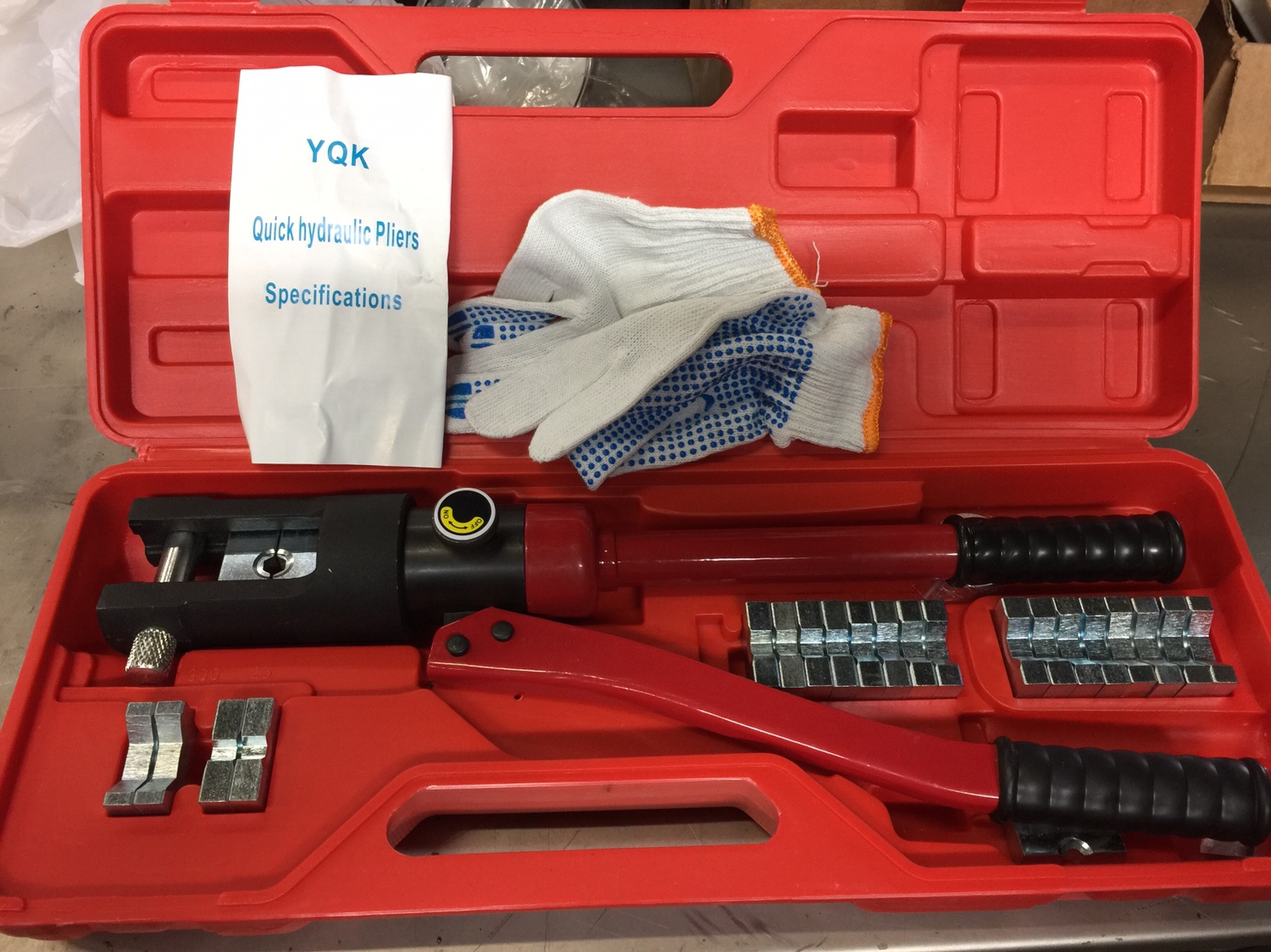

    Wire is 2/0 stranded copper. Battery terminals are these screw style and eyelets were crimped using a new tool Bill found.
    354 Hemi cranked over with mini starter. Still need to shrink tube that end and tidy up the cable, along frame rail.
