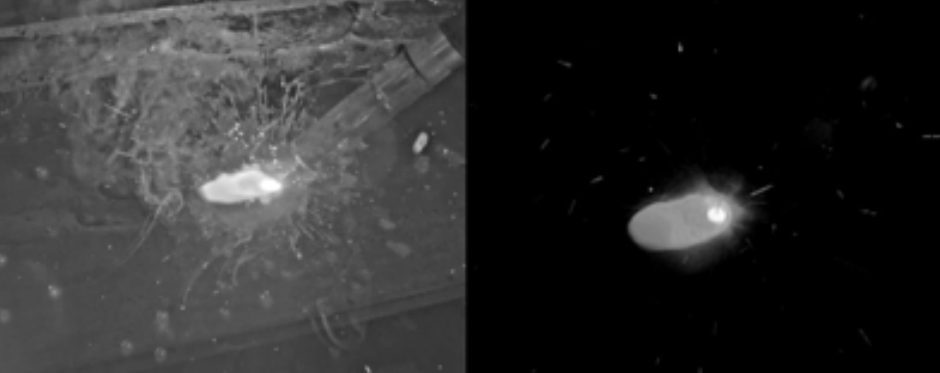

    And yes, as I suspected, there are "3D Vision" helmets which use cameras, processing and displays so you see everything except the arc flash (!)
    https://www.vision-systems.com/came...-helmet-employs-extreme-dynamic-range-imaging
    https://www.sri.com/case-study/next...for-better-productivity-accelerated-training/
    https://shopmetaltech.com/welding/weld-visualization-technology-and-3d-welding-helmet/
    Unfortunately, all the news came out in 2019. Found one mention in 2021 and it looks like Kawada is using these helmets to train welders. Clearly, this is revolutionary technology and should be kept out of the hands of the competition I suppose. Still, this is the way to go. Endoscopes used to be optical and directly viewed with eye, but now are all "robotic" using video cameras and monitors.
    And I quit holding my breath that safe water based auto paints would show up in my lifetime.
    XDR image & Conventional
