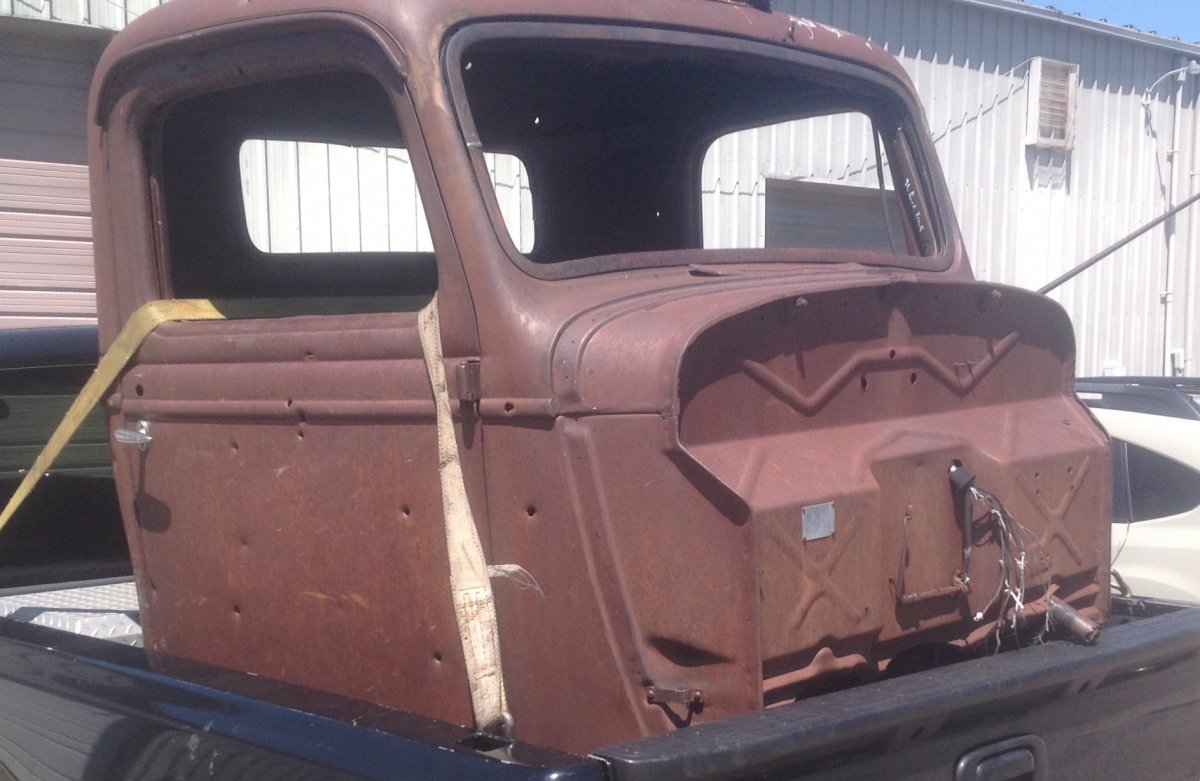

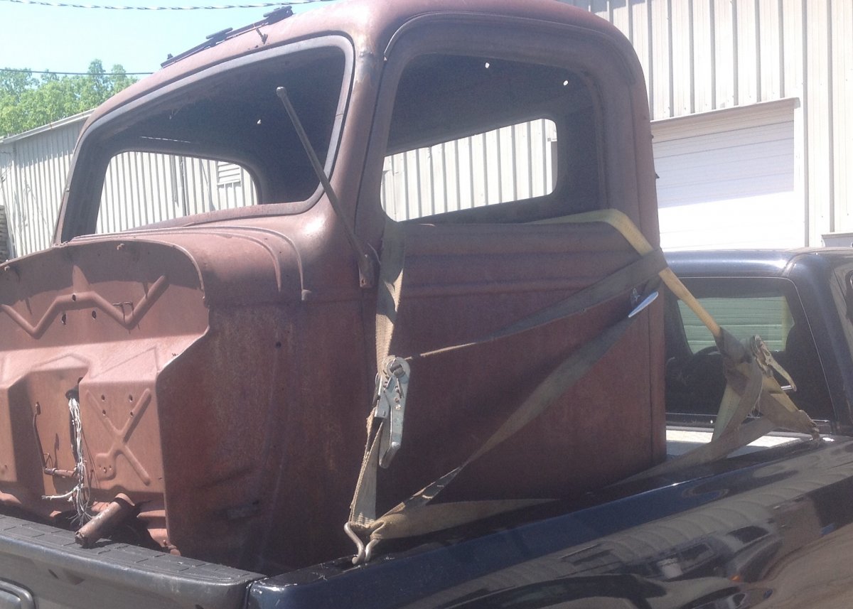

  12. Had to get the whole cab to get the doors and they are nice ones. :D
    Really nice and complete doors except for a few bullet holes in the passenger door.
    The rockers are perfect, cowl and firewall just as nice and I couldn't spot any rust in the windshield frame.
    I'm going to feel real bad about cutting the door jambs out.
    This is significant progress and a big hurdle has been cleared.

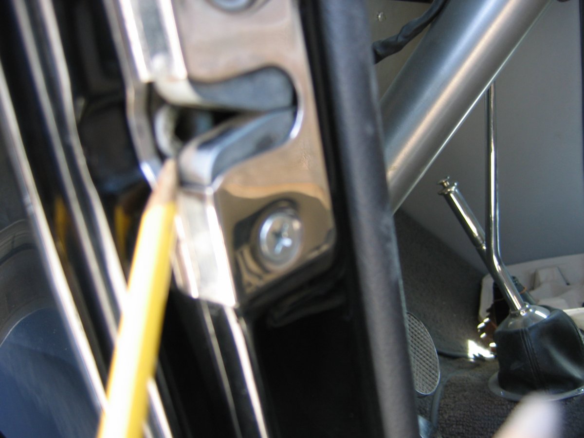

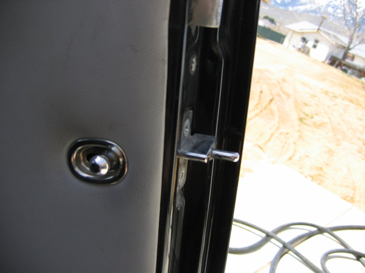

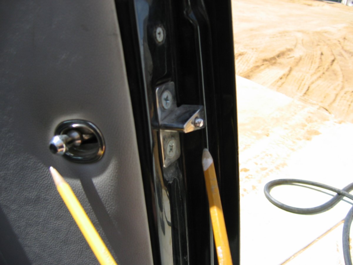

    And anyone following this should think really hard and it all the way thru on installing bear claw style latches.
  20. Are you referencing Mike’s story? Or do you have your own chapter to add?
  21. It should be in here all ready but here's the thing.
    First, there is no question that a bear claw style latch is far superior than the old style stuff, that's not even up for discussion.
    However, when installing the bear claw latch in these old style doors it causes a complete redesign of the both interior door mechanics - involving the Window channels, the exterior door handles and the interior door handles. The results are less than favorable in every aspect, no where near as good as the well thought out factory design. Plus the required time to reconfigure the mechanisms is atrocious when all results are less than favorable. Doing all of this inside a of a door is like building a ship in a bottle. The easy way is full electrizical doors and that is beyond stupid.
    A simple lock pin requires some time and effort but it's minimal. It creates a secure and positive lock that does a better job than the bear claw, it doesn't bother anything else inside the door and could be easily removed.
