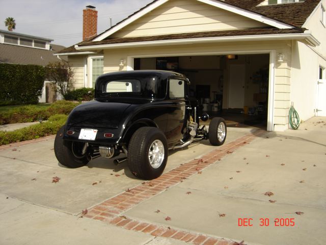

  2. Dave has used this set up under his 32 pickup. HRP

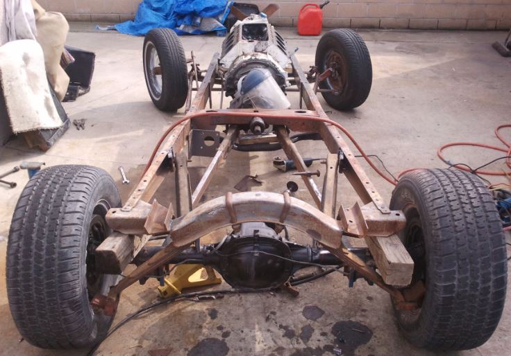

  4. Deuce Roadsters set up. HRP

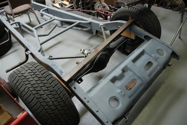

    It's pretty stout. I like, at least the lower ones, to extend & connect to the trans crossmember for better weight transfer.
    This is how to do it cheap$$$ I still got a couple brackets to add at the frame connections

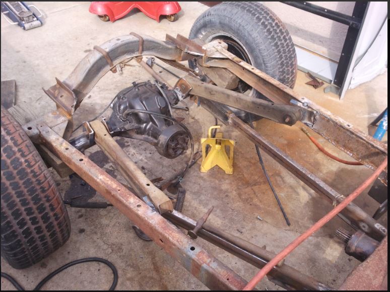

  26. I built my own under my '53 F100
    [​IMG][/IMG]
