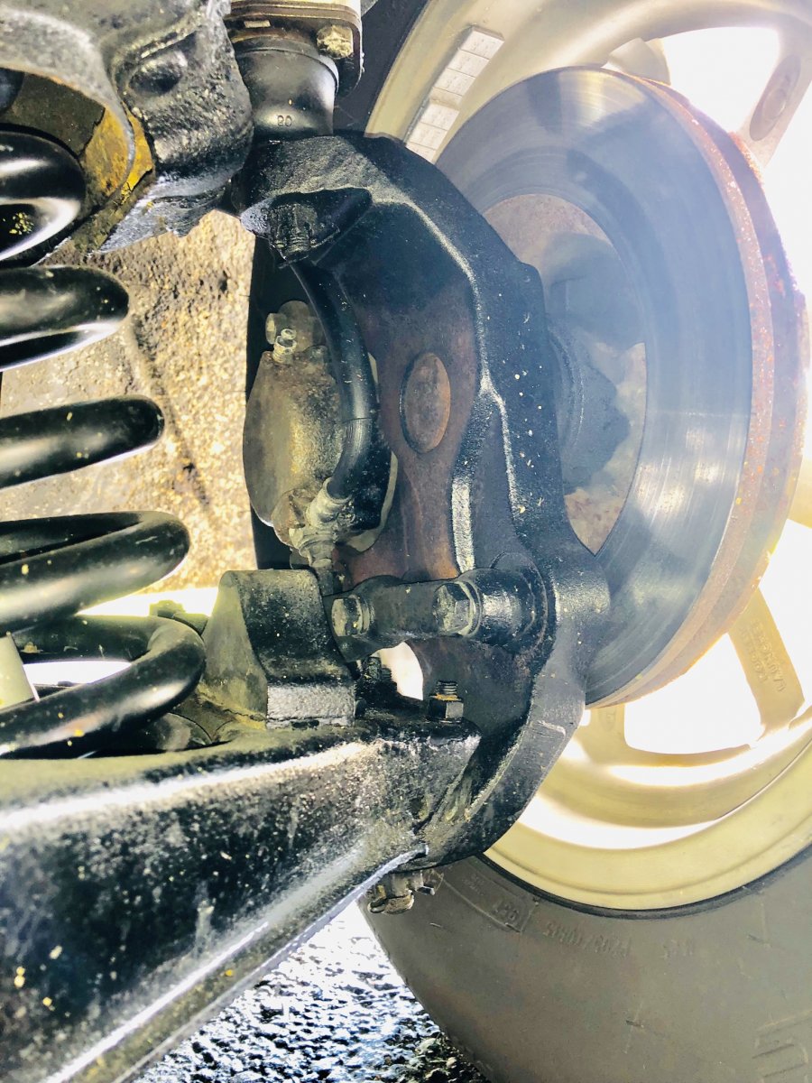

    Hey guys, these are the spindles that came on my 55 when I bought it 13 years ago. I have raised the entire car with new rear leafs and overload spring shocks, and threw a set of 57 HD springs up front with ball joint spacers for clearance. Looking at these spindles, they appear to be offset towards the top. Do they look like drop spindles to you? If they are, they’re getting replaced with stock height pieces to lift the nose. Thanks in advance.

    stock spindles are forged, skinny, and don't have a caliper bracket built in. Yeah, they're dropped, as well as being aftermarket.

    Thanks. Looks like I’m getting new spindles then!! I was wondering why I didn’t get more lift out of those springs.
