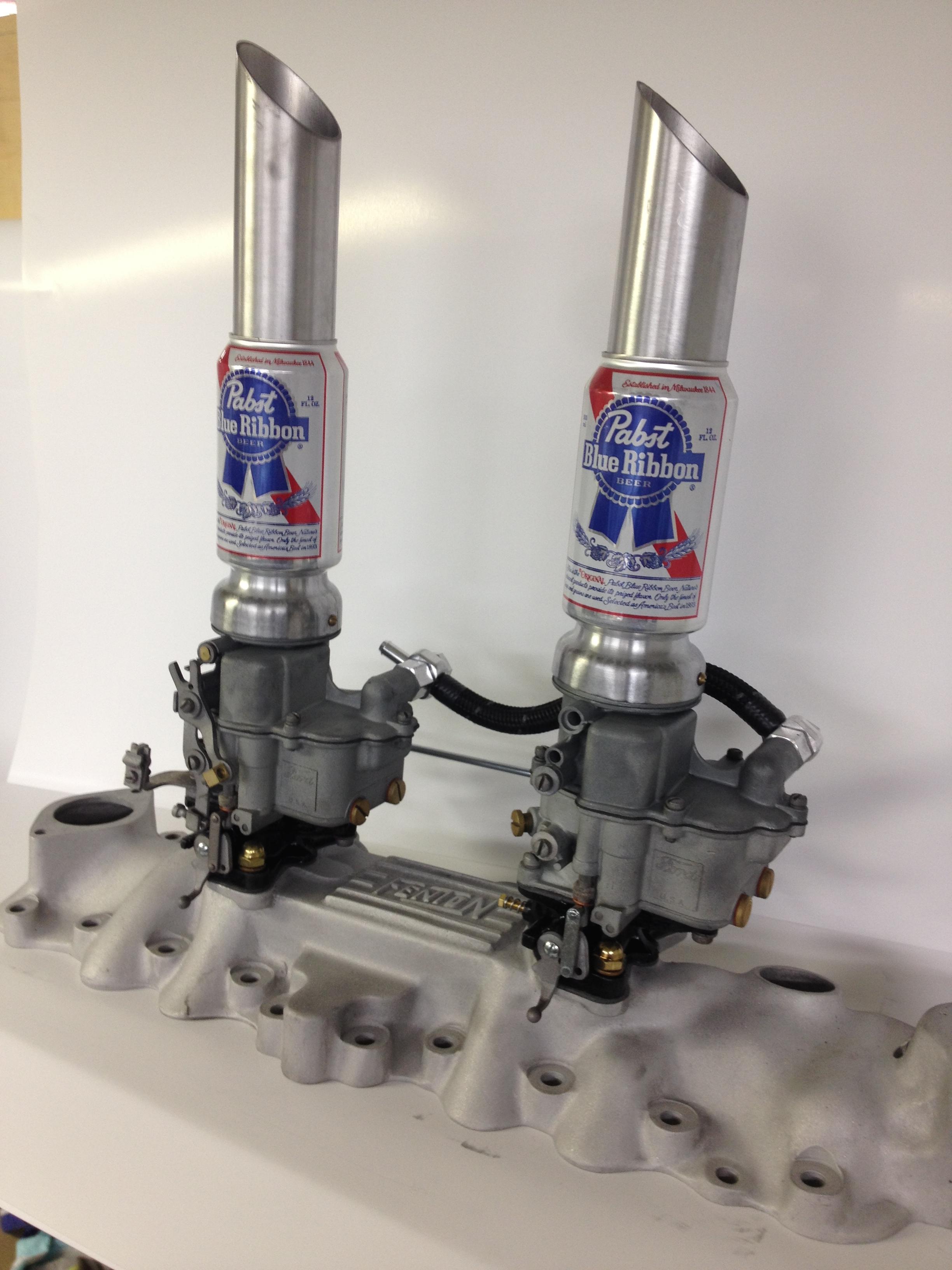

    I ended up getting a vintage fenton 2x2 from ebay and set it up with vintage speed bases and linkage.
    Sold the whole thing back on ebay for $850
  16. Well that's a m nice setup. The beer cans are a little lame but other then that its a nice setup.
    Automotive Stud likes this.

    no one likes the pabst cans...lol
