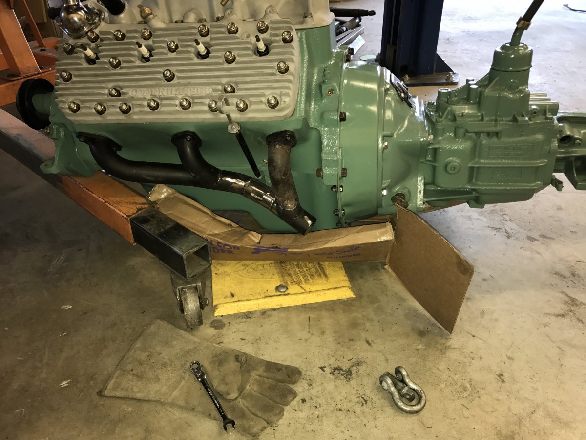

    Looks almost stock! I see you've "blurred" out the adapter logo?? Can you tell us the brand and if the bolt pattern is within 1/8" of a GM T5 pattern?

    I got my adapter yesterday. Tonight I went out to see how well it fit the motor/transmission. I'm telling you guys right now, it fits like Henry Ford himself had it cast and machined! The alignment pins on the bellhousing fit so well, they nearly snap into the holes. The transmission bolts and bellhousing bolts are directly on center. There were ZERO issues. Gene provides an oilite bronze bushing to adapt the bearing retainer OD to the larger ID of the throwout bearing. I'm not sure if he wants his prices posted online so I'll only say he is cheaper than any other vendor. Shipping takes a little longer than most big box supplier's but the hand written receipt and thank you note from the guy that made it was well worth the extra couple days. I would like to extend a huge thank you to Gene Sanders with MEC. For any Flathead Ford adapters......Gene is your guy!!
