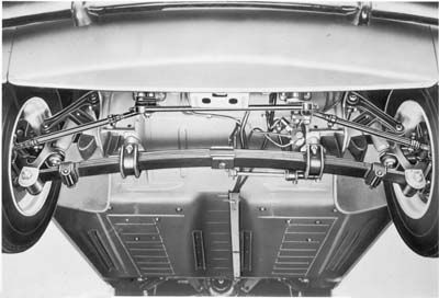

  26. Ned Ludd
    Joined: May 15, 2009
    Posts: 3,790
    Ned Ludd
    I think the trick is to see a transverse leaf spring as if it were two completely separate quarter-elliptic springs, mounted heel to heel, as it were. If we then consider one of these quarter-elliptics in isolation, it's a simple cantilever beam problem. You have a beam with two supports close together and a load at its cantilever end. The greater the distance between the supports, the less the stresses at those points.
    The first problem with a single central bolt alone is that the effective distance between the supports is effectively halved – in so far as the distance can be determined at all. It could work if we introduce ribs or frets on the underside of the crossmember to form positive fulcra for the spring to bear on. But now, what we're doing when we ultimately morph our two separate quarter-elliptics into a single siamesed spring is that we're making the springs share one support, so that each half will need its own second support, which at any given level of stress doubles the width of the support arrangement, making us need either a longer or a softer spring. Using two U-bolts means that our siamesed quarter-elliptics share both supports, but in reverse order: the end support of one quarter-elliptic is also the middle support of the other, and vice versa, and we don't need a ribbed mounting. It's simpler, more elegant, and doubtless considerably cheaper.
    Not being able to see those siamesed but conceptually separate quarter-elliptics leads to all kinds of misconceptions about the geometry of transverse leaf springs. The suspension does not roll about the point where the spring bolts to the frame. If anything moves relative to anything else at that point, your suspension is at the point of failure. How the suspension does rotate in roll is somewhat more complicated than you'd think. I've explained it a few times in that past, e.g. here: https://www.jalopyjournal.com/forum/threads/anti-roll-bars-on-the-front-end.746645/#post-8307931 and here: https://www.jalopyjournal.com/forum/threads/i-beam-vs-ifs-pros-cons.470069/page-2#post-5250366. Going back through those threads I'm reminded that it's not only complex but also controversial.
    But the point which comes out of that is that the importance of the angle of the spring shackles is that the shackles constitute a lateral-locating device. The minute you have another lateral-locating device, you really want to eliminate the lateral-locating action of the shackles as far as you can. The minute you have a Panhard bar (and a dead perch turns half the spring into a Panhard bar) or something less common like a Watts, WOB, or Mumford linkage, or even a triangulated 4-bar, you'll want the shackles as close as possible to tangential to the spring action, i.e. just off vertical, or the closest you can get to that without the spring eyes colliding with the perches etc.
    I just had a thought. If the vertical distance between the roll centre defined by the lateral-locating device and the instant centre defined by the shackles is large, lateral forces can only be resolved by flexing the spring. In that case it might in theory be possible to use the spring as an anti-roll device, or even to induce positive banking. I know what's going to keep me awake tonight ...
    King ford and Jet96 like this.
  27. Ned Ludd
    Posts: 3,790
    Ned Ludd
    Fiat 600 IFS, 1955-1969:
    Note that the centre of the spring is bolted together but not bolted to anything else. This makes the spring deflect in a soft U in bump but in a much tighter S in roll, resulting in effective anti-roll action. Pretty much all the small rear-engined Fiats used this arrangement, and Fiat later adapted it to the rear of the front-wheel-drive 128.
    Many subsequent transverse-leaf independent systems have used this dual-fulcrum principle. It's quite clear in the Corvette pics above.
    Jet96 and brEad like this.

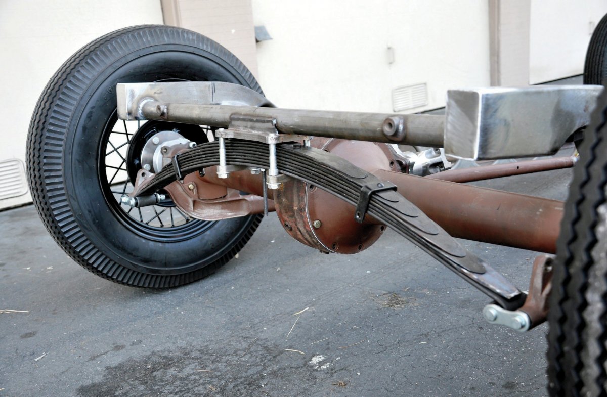

    Is there a right or not so right way of compressing a spring at its point of attachment to the chassis???
    Is it better to use a one piece compression plate compared to what you see in the pic below?
