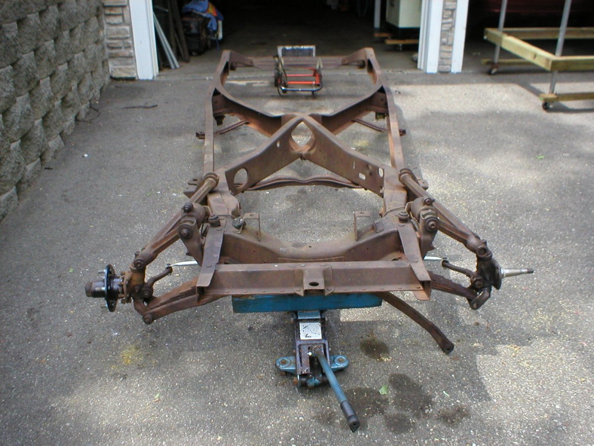

    IMAG0925.jpg Had to do some hunting,but did find rear photo,I took on last restore a few years back. In 1959,I had a 1950 Olds rear an made custom brackets,after replacing that rear some years ago with 64/5 Mustang rear,made brackets a little smoother but nearly the sameway. The WB ended up at 97in. , 1928 "A" {but boxed} frame is stock other then front cross/spring mount is about 2in.s ahead of stock "A"
    alanp561 and brEad like this.

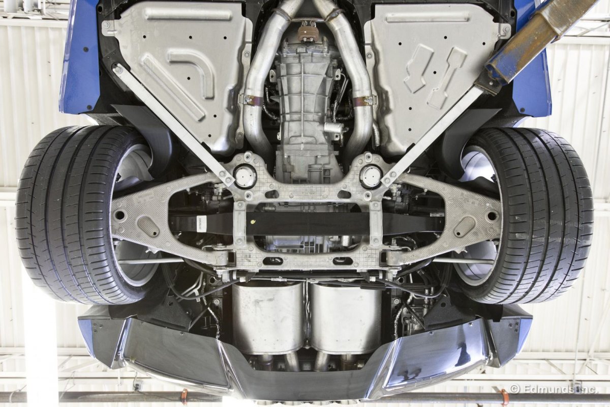

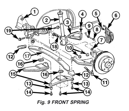

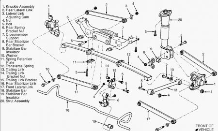

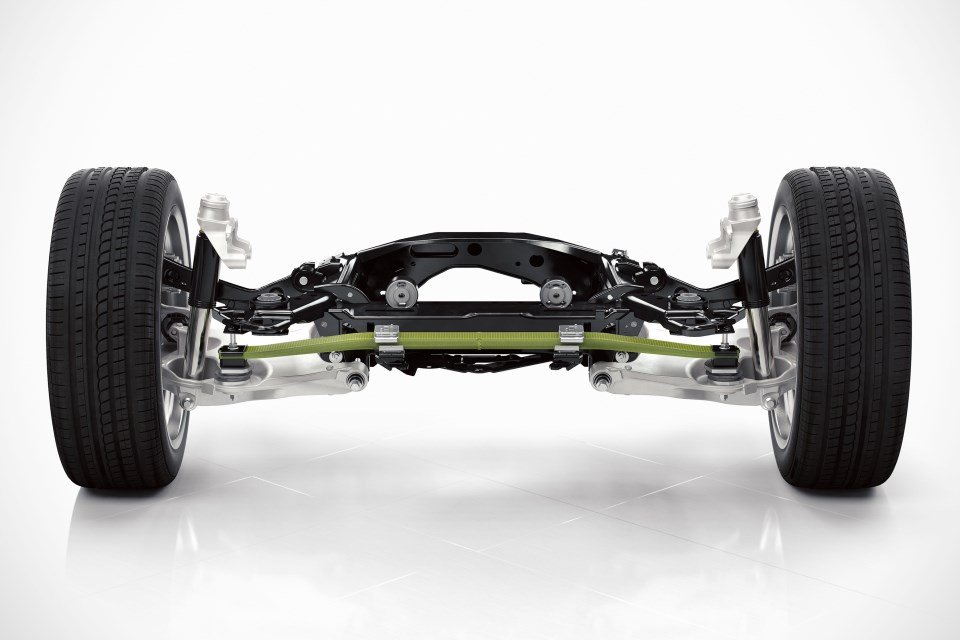

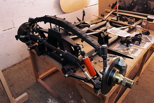

  8. Transverse springs found In many vehicles and not just solid axles
    Studebakers
    Corvettes
    GM W body
    Iveco
    Volvo
    Mercedes

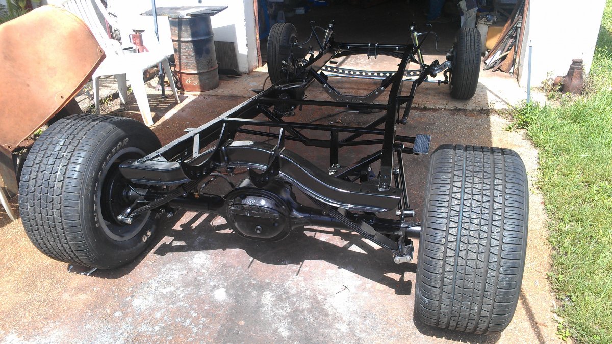

    brEad likes this.

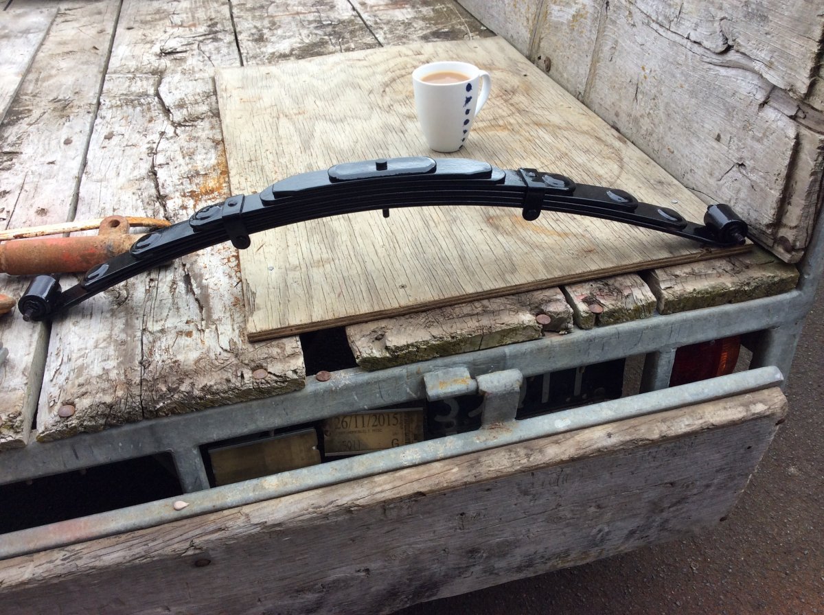

  11. My mind works overtime,,, I think way too much. The transverse spring seems to pull up on unsprung weight.

    A transverse spring is a great use of a single component that provides simple but effective suspension for a multitude of uses. It certainly has passed the test of time and such simplicity has been seen on drag strips and salt lakes at speeds that never could have been predicted by the original innovators of such suspension, but besides that, it also lends itself to doing real well during its time of conception by riding all kinds of terrain thru the early days of motoring on many continents around the world.
    Not a bad effort for a old buggy spring...

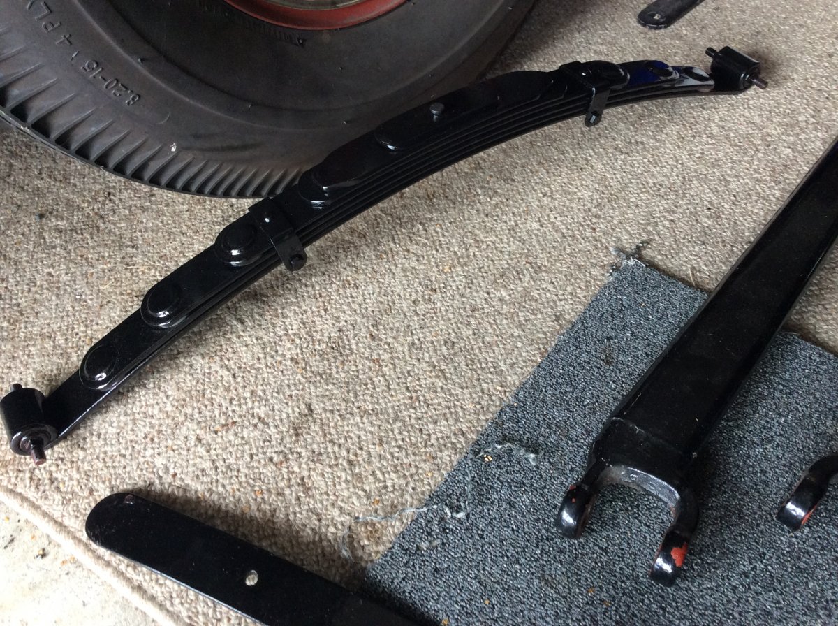

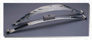

  15. You migh really like a factory spring then.
    The main leaf has eyes, the second leaf has a safety catch
    The next leafs are hollow ground with almost knife edge tapers
    And they are made to take grease.
    The aftermarket springs are no where near as nice in appearance or design.
    The use flat profiles, Teflon slip stuff, sometimes an ugly ass button and bulges no second leaf safety.
    fiftyv8 likes this.
