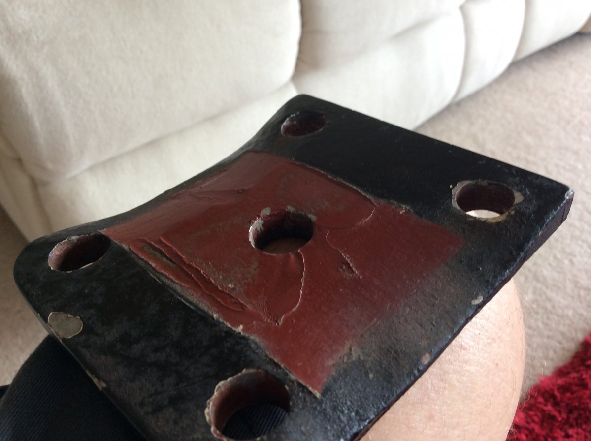

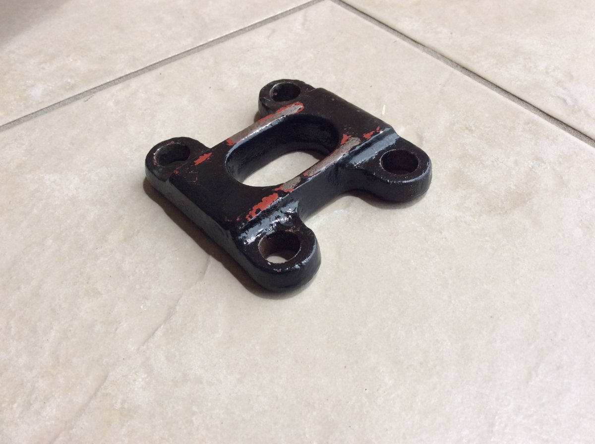

  12. clem
    Joined: Dec 20, 2006
    Posts: 2,013
    clem
    7682F18B-963E-4CBA-925F-6DAF56F332AA.jpeg ECD8191B-BABB-406D-B680-3ADDEA073FBE.jpeg This is the plate that I made for under my spring.
    I don’t believe that a flat plate is ideal under an arched spring, although that is exactly how all the others in the world are done !
    Also shown, ford original.

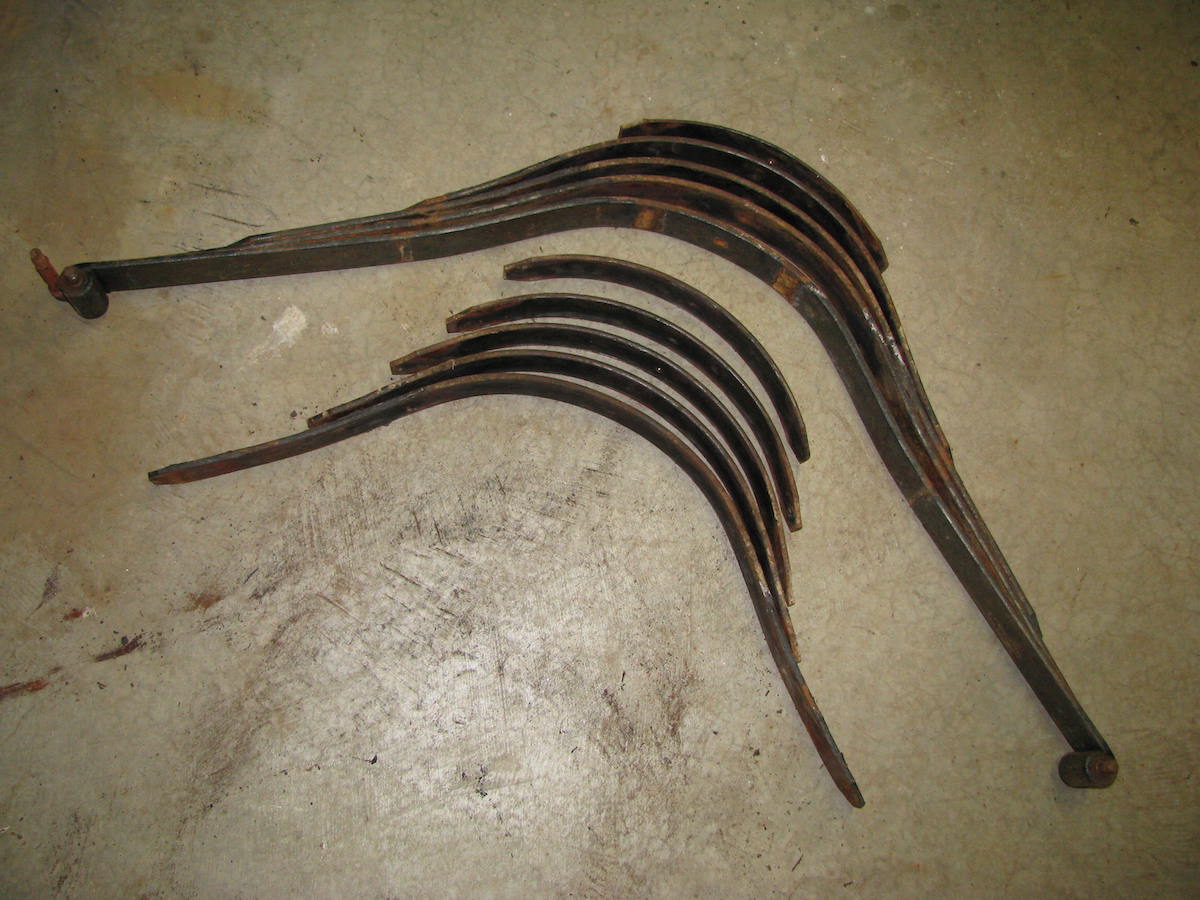

  17. fiftyv8
    Joined: Mar 11, 2007
    Posts: 4,580
    fiftyv8
    from CO & WA
    I guess you can't have a transverse spring thread without having a couple of pic's of transverse springs, can you!!!

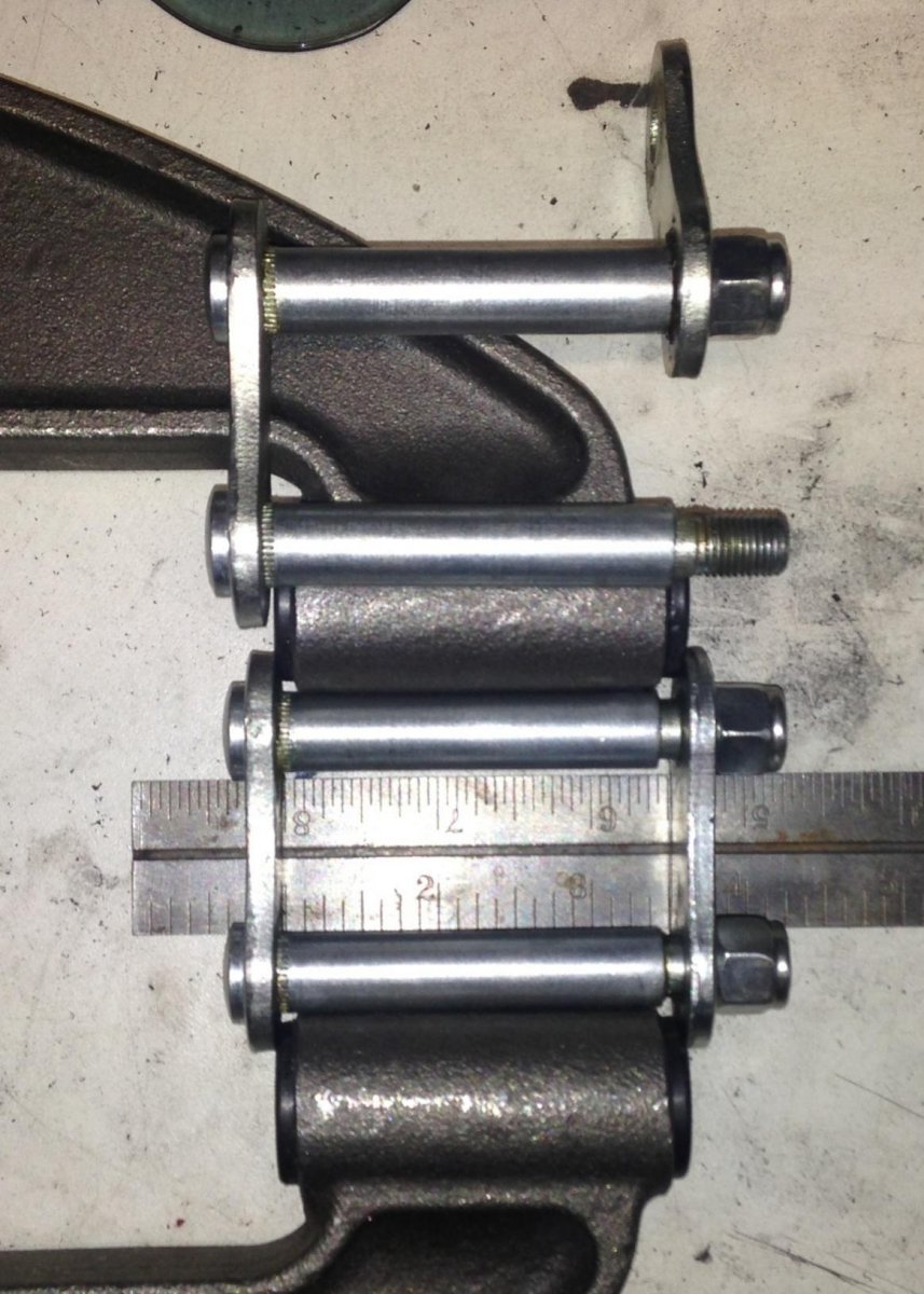

  22. Also there are some shackles out there that are manufactured incorrectly.
    The shoulders on some are too short. Tightening the shackles crushes the bushings shoulders. It can also pinch and bind the shackles. The length of the shoulder should/must be slightly longer than width of the installed bushings.
    Here's what I mean.
    Below is a perfect example of crap that is NFG
    Notice that the threads can't protrude past the face of the nuts, can't even engage the nylock
  23. And if the shackel pin is not welded to the shackel plate, if can be a bitch to get the other shackel plate installed.

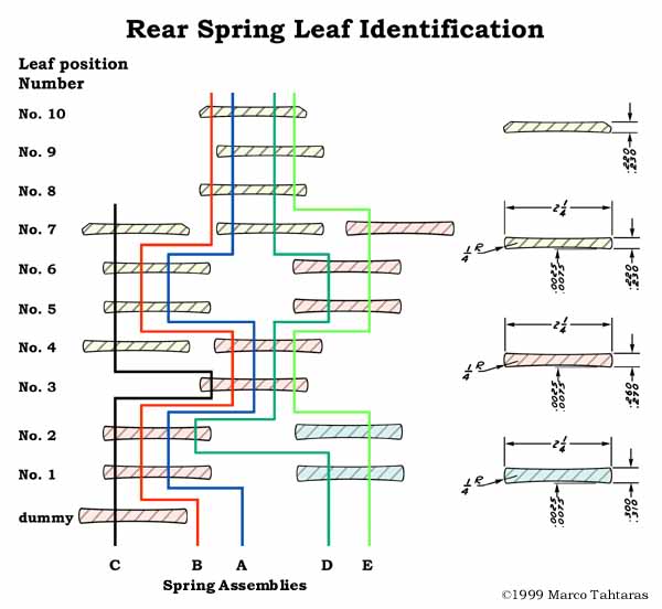

  29. BigEd
    Joined: Aug 12, 2005
    Posts: 236
    BigEd
    Here's a chart I found several years ago, possibly from FordBarn, by someone named Marco.
    brEad likes this.
