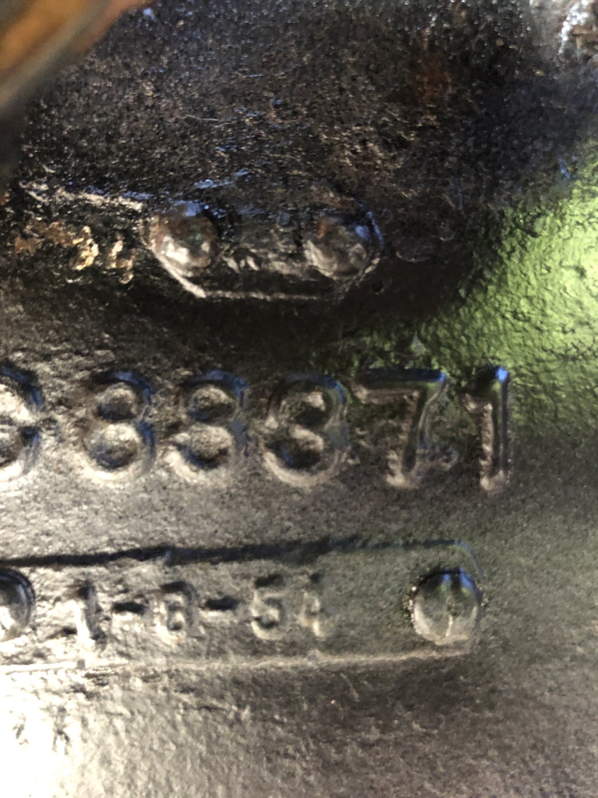

    Ok. On my C1H8 truck the tranny has me kind of baffled. Without moving, I swear I can hit 5 forward gears. When driving I only find 4. There is a lot of slip in the shift lever, but the Rpm’s just seem too high driving down the road, like there should be another gear. Does anyone have a reference for dodge tranny numbers from the 50s?
