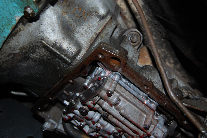

    the photo of the transmission apart is quite impressive!! ther is all that stuff in? how does it fit? ah ah... thanx again...

    hey, I just took the pan off but apparently it's not a super hydro, it's not the same shifting selection system anyway! can you help me identifying this transmission please?

    I actually found out that it's a hydra matric, or may I say: high dramatic!!!
