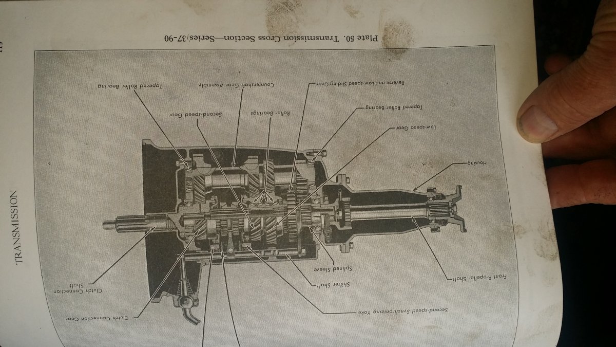

    Can anyone ID this early trans for me? Its bolted to a Cadillac Flathead that im looking to buy. It has an integral bell housing which is different from all the other Cad/LaSalle trans ive seen

    looks like a series 37-90 transmission,

  3. The engine is a 38 Cadillac. So the trans is Cad or Lasalle? The ones Ive seen have the shifter much closer to the front like the Buick trans and the gears loaded in the base

    Looks like the Series 37-90 pictures in my 1937 & 1938 shop manual.

    on line search shows the Series 37-90 cars having 8, 12 or 16 cylinders
    yes looks quite different than the typical Series 60 "Cad/Lasalle" transmissions
