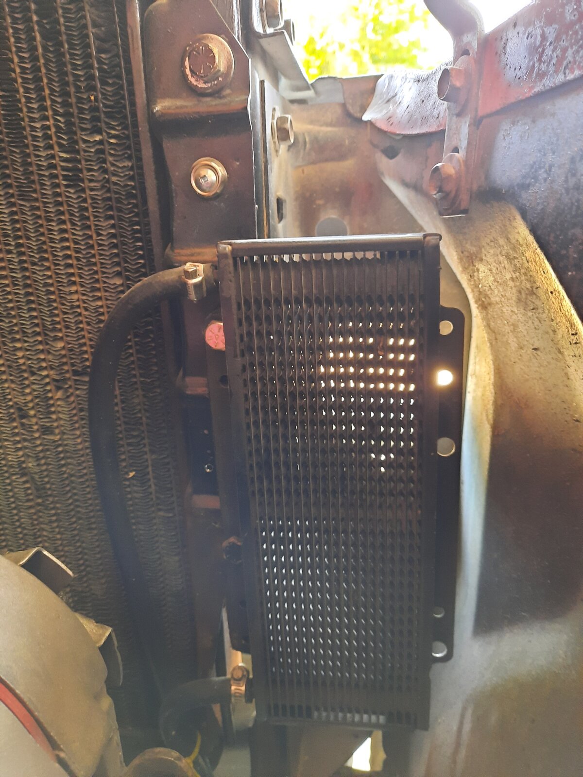

    Hey all, been using this external trans cooler in 55 Fargo.
    It's a stock 1986 318, 904 trans.
    No trailer pulling going on.
    Is this cooler big enough?
    To date not much issue.
  2. squirrel
    Joined: Sep 23, 2004
    Posts: 56,044
    squirrel
    should be big enough. But it would help to have it where air will flow through it....like in front of the radiator.
    If the transmission fluid does not get yuckky, maybe it's doing a good enough job. Discoloring, or getting a burned smell, are symptoms of overheating.

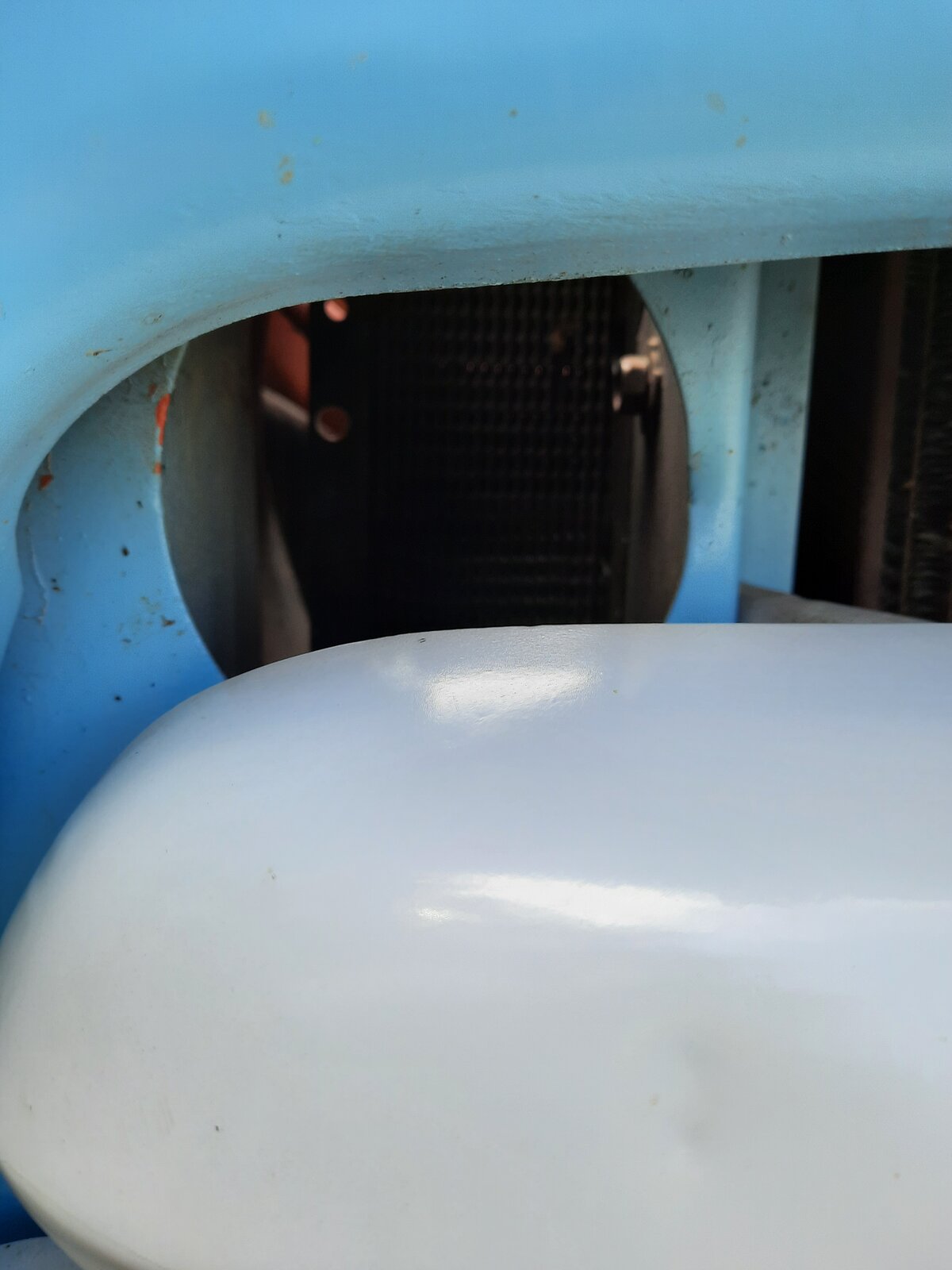

    9
    Jim, big hole open beside rad lots of airflow

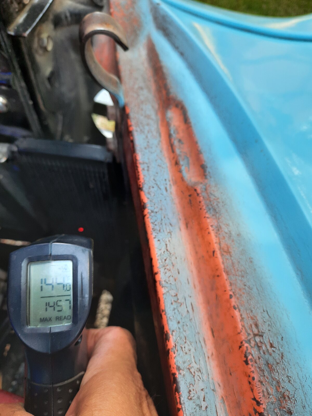

  7. Flat Six Fix
    Joined: Feb 6, 2010
    Posts: 1,270
    Flat Six Fix
    Just back from a drive, 80 outside trans cooler was 158
    loudbang and canman like this.
  8. I think you just answered your own question, it's big enough to achieve that low of temp on an 80 degree day then the transmission is happy. Sometimes the trans will get hotter during a stop and go stuck in traffic drive as the airflow becomes an issue as the torque converter has to slip a lot. That is where the most heat is generated is in the torque converter.

    That big hole that shouldn't be there means that when you are going down the road air is taking the path of least resistance and bypassing the radiator.. Put the panels that belong there back and put the cooler in front of the radiator where it belongs so the fan will pull air though it at low speeds and the panels will direct air to the radiator on the road. That will save you coming back after the first road run and asking why your car overheats on the highway.
    '28phonebooth likes this.
  18. Flat Six Fix
    Joined: Feb 6, 2010
    Posts: 1,270
    Flat Six Fix
    Not sure where you got this idea?
    And yes that hole is factory not cut out.
    My rad is got great open airflow too.
    But your hypothesis is dead wrong.
    Truck never runs too hot highway or around town.
    Actually runs at nice 185 never hard to start on hot days either....

    Hey all took truck into town to fuel her up. 15 mile round trip.
    Outdoor ambient temp near 90.
    Truck ran in Normal temp range 185 or so.
    Trans cooler around 150 or so.
    So not bad, but no mountains or hours of driving either.

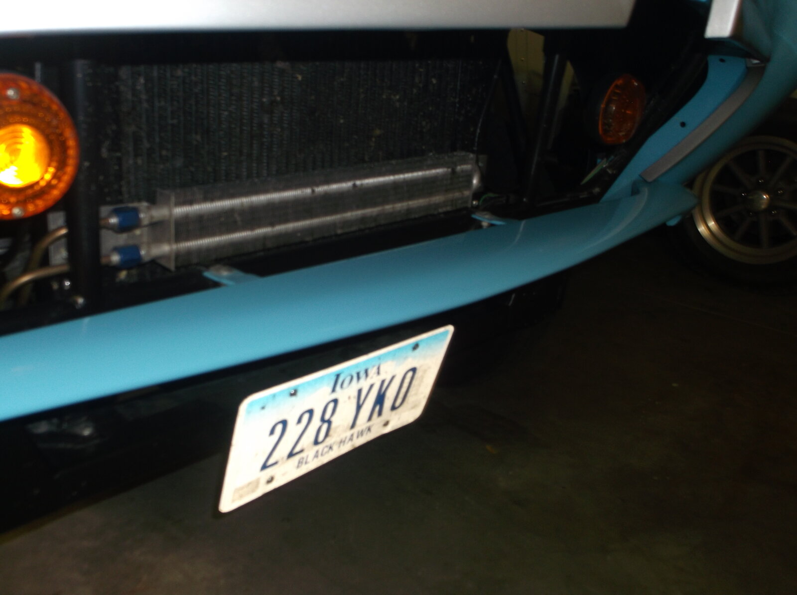

    It seems to me that way back when, I took a hydraulics class for my job and the instructor told us hydraulic fluid could be too cool. Seems like he recommended 180-200*. That was a long time ago and I may be wrong. DSCF2767.JPG
    I have this tube & fin 2 pass that is sold as a frame rail cooler, so it should work in front of the radiator just fine. It has for about 10K miles so far anyway.
