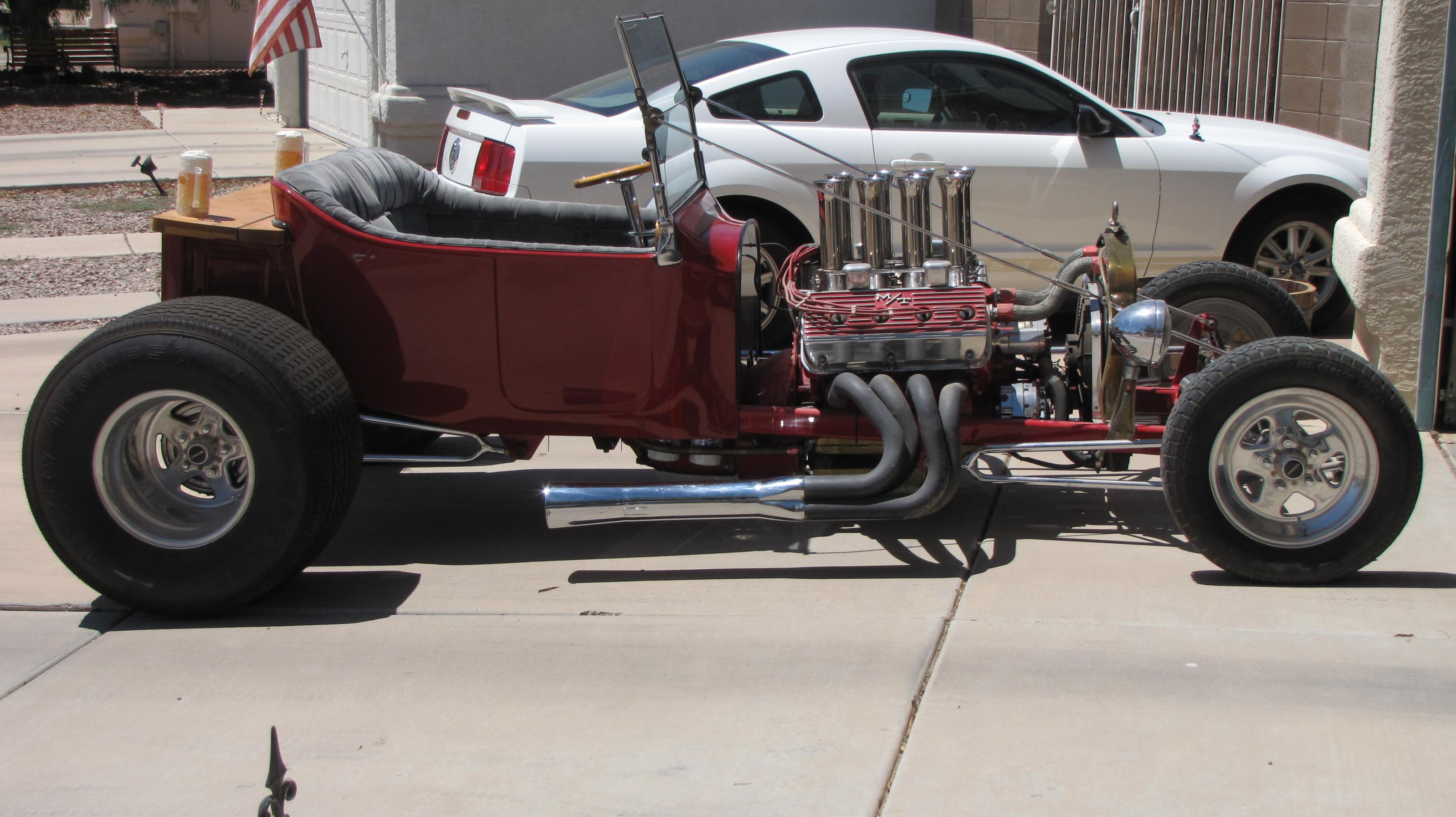

    Built this for under $5000.

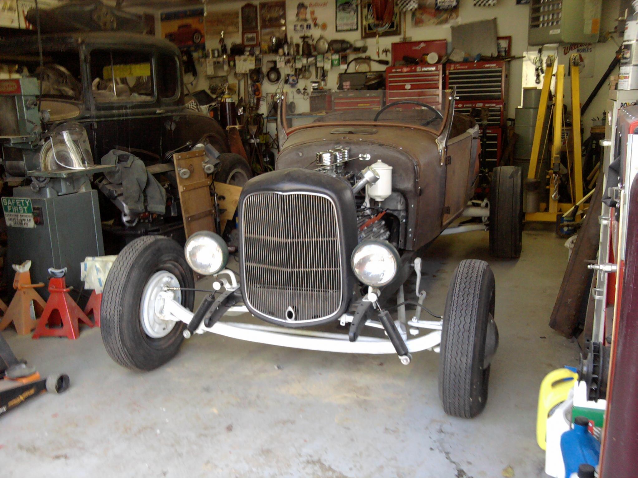

    Bought a new unused but old glass Tbucket body and a nice 2X3 steel tubing frame at the Decatur TX swap meet last February for $450. Shortened the frame and zeed it at the firewall, added turtledeck I had and now have a good basis for a nice little ride. Plan on using a 47-48 Ford front end or a 33 Dodge wavy axle up front and either 59A flattie with auto and 8" rear or 2300 Ford Banger with auto and Pinto/Bobcat wagon rear end. Already have a nice original set of 23-25 Windshield posts that are chopped and just bought a nice set of 50s Dodge/DeSoto wire wheels which would look really nice on the car. Have less than $1500 in all the above plus several steering coluns/boxes to choose from. Sometimes it is good to be hoarder.
