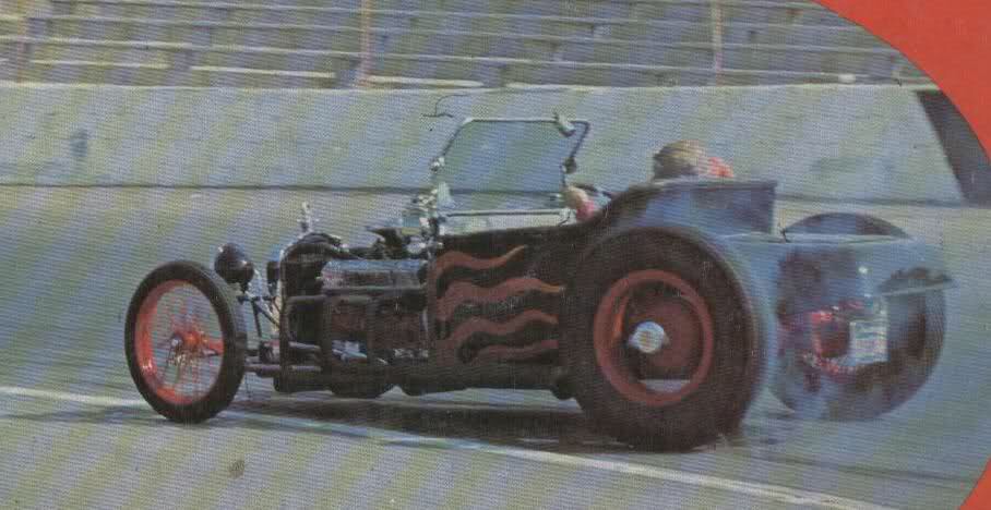

    Man that's gotta be it, or one copied from it. but I think it had way wider wheels and tires and darker color. Not sure why I love that one! That thing had to be a blast to drive. Anybody know the builder of this T or if it's still around? I love how low and wide it is.. Is trade both my shit boxes for one set up like that...

    Cotton built three or four of those chassis for guys about forty years ago. There actually is a huge picture of one on this thread back at about page 30 or so. It's black with flames and has just recently got it's Ardun after running a flathead for about forty years. That particular car was featured in American Rodder about twenty years ago wearing a set of dark centered American mags and then current radials, but I remember seeing pictures of the car from the early seventies wearing the same Americans and wider Goodyear Blue streaks. Might just be the car you are referring to.

    The black and flamed version was Bob Knaack's car.
    Heres a pic...and I'll see can I round up that thread on Cotton's car for ya...
    Ok...here it is...but most pics are gone! :(
    http://www.jalopyjournal.com/forum/showthread.php?t=53748&highlight=cotton+werksman
    BTW...Bob's car always had a sweet flatty in it and it looked fantastic. Now I'm NOT putting an ARDUN down as undesirable :D but I really did like the proportions with the flathead more!

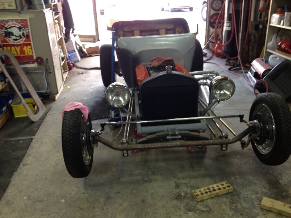

    found a detail today on my RPU that I am building. The chassis was done 20 years or so ago. I had never seen friction shocks mounted this way. The main mount is below the spring mount. The end attaches to the spring shackle frontend.jpg

    I think those friction shocks and mounts might be Total Performance. Seem to remember seeing them in their catalogue and wondering how they would fit/look.

    Mine are like that. When Fitz owned it she broke a spring hanger and he blamed it on bind from the shocks being direct mounted to the shackles. After bolting in new perches, he made some shock links from Heim joints to get rid of the bind and now the front axle moves smoothly over bumps and the stiffness is way less.

    A company on the west coast called Specialty Cars did that type of system as well. I agree 100% Hackerbuilt with needing some kind of link rather than just solid mounting them to the shackles. A male and female heim joint screwed together with a simple jamb nut would be enough.

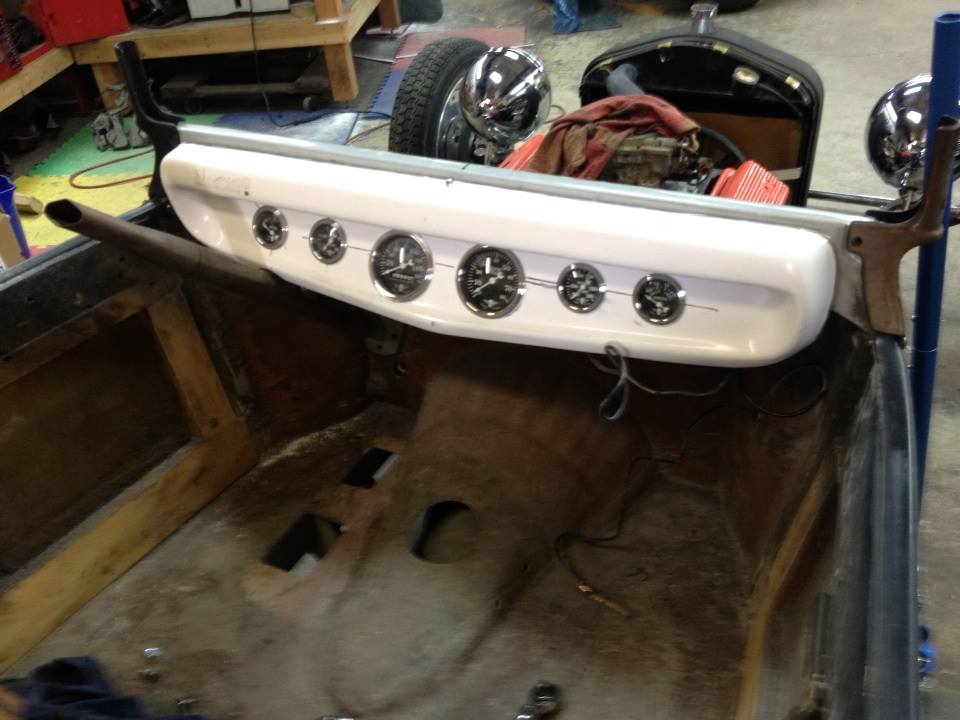

    a couple from today.........got a smoking deal on some head lights..........and I got my gauges in my tunnel dash..............moving forward
    first picture shows the front shock mounts

    Like them too! That looks like it might be an entire Specialty Cars chassis. They were on of the first to do four bars on T-Bucket frames when that was all the rage for everything else.
