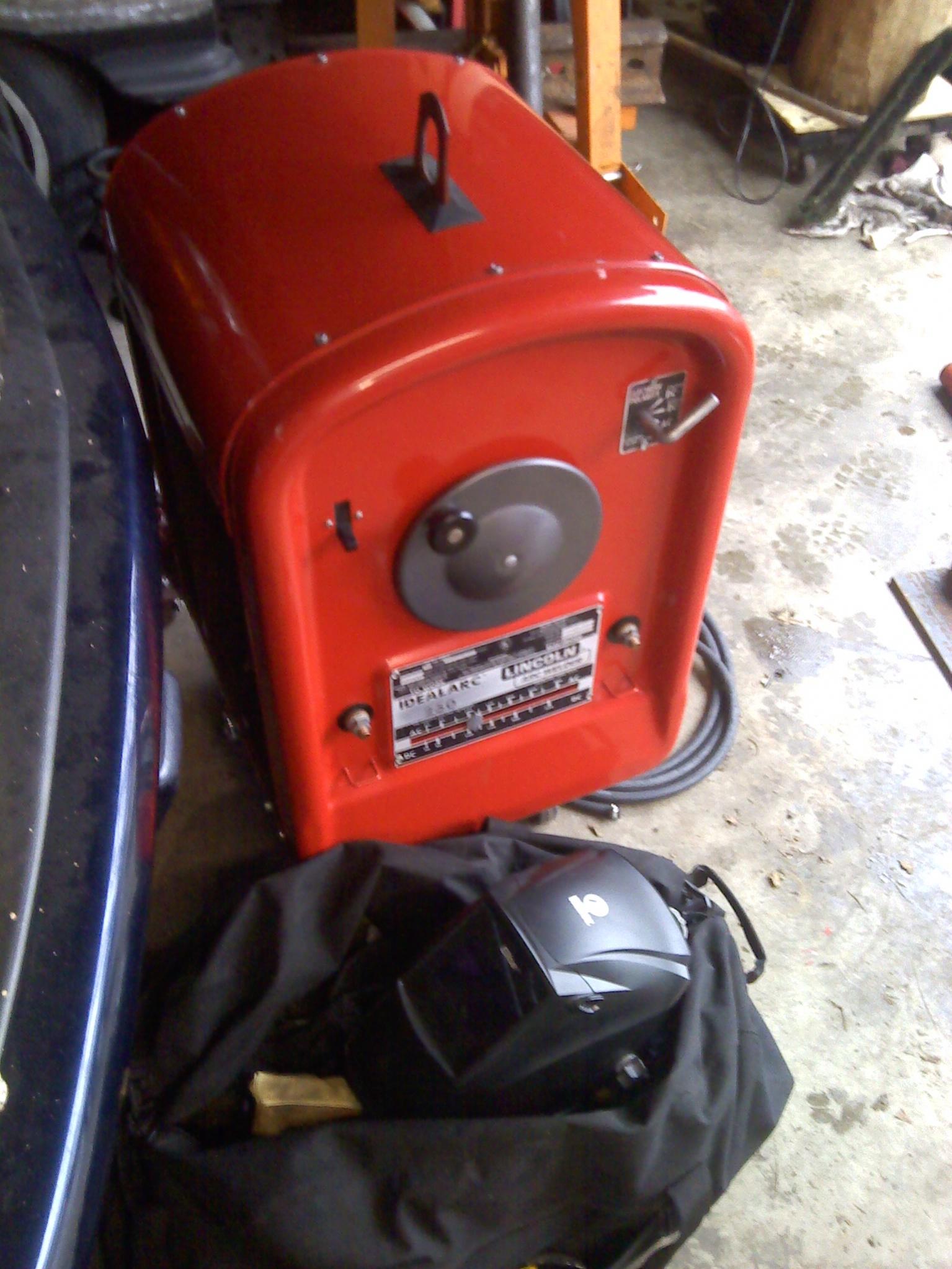

  10. DamnYankeesKustoms
    Joined: Jan 14, 2010
    Posts: 297
    DamnYankeesKustoms
    Yes..I use it on my welders...

  12. DamnYankeesKustoms
    Posts: 297
    DamnYankeesKustoms
    Make sure you get and use the hardener if you plan on spraying it on... So far it's held up nice on both welders being inside the garage... cleans off pretty easily,and even buffs out nice... Yes i have a sickness...I buff and polish my welders.. :D:D
