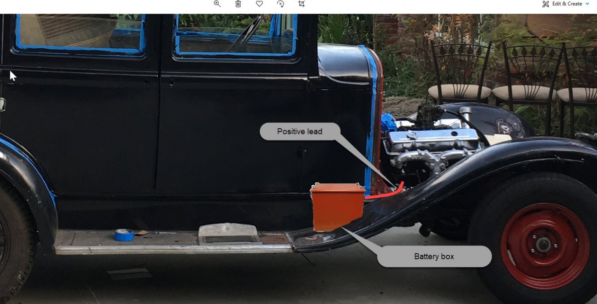

    For a small AGM battery, I would plan on mounting it on the firewall next to the motor. For the larger battery, I am considering a fender/running board mounted battery box similar to mid-20's Ford/Dodge sedans.

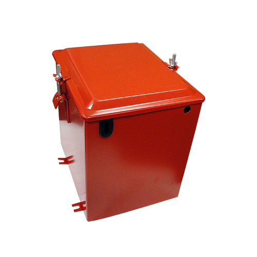

    One thing I'm finding fairly affordable are tractor battery boxes.
    https://www.completetractor.com/new...ll&gclid=CLrlkqeS3eQCFdVggQodTb0PGw&gclsrc=ds
    I think it would look pretty cool in a solid, bold color like the red that is pictured.
    Anyone care to weigh in? I'm open to opinions related to this type of car. (no trunk or truck bed to speak of, which is where I'd throw it if I had the choice). Planning on staying full fendered, but I guess the smaller AGM would allow me to remove them if I wanted to, down the line.
    chryslerfan55 and Hnstray like this.
  2. That is a Farmall battery box designed for a group 1 six volt battery. This is the same size used on my tractors, when I convert to 12volts, I use a group 29 battery and it fits perfectly.

    My honest opinion which means nothing, the photo above with the battery box mounted as is ... looks like crap.
    I would shrug my shoulders and walk on by, wondering what else may have been done wrong.
    Must be a better option, Trunk, under floor, behind the seat?

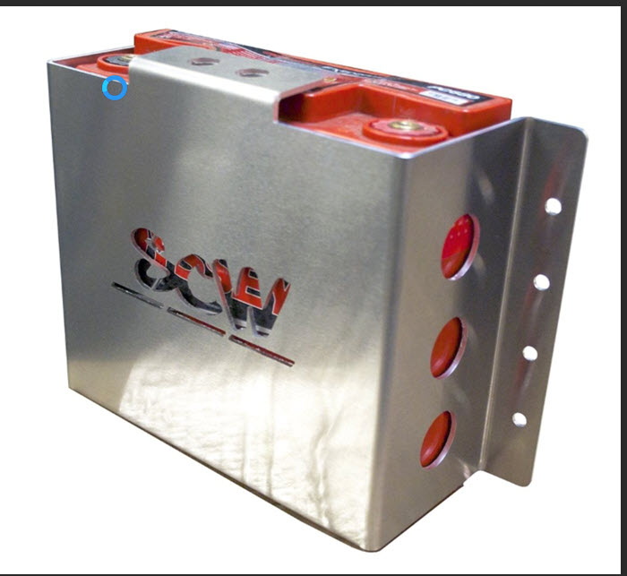

    I could also just throw a PC680 on the firewall like the pic. Probably end up being the same cost, but a lot less time investment than other options. (battery box, or the custom mount/underfloor fab.)
  10. Blues4U
    Joined: Oct 1, 2015
    Posts: 7,589
    Blues4U
    from So Cal
    But not very traditional looking, eh?

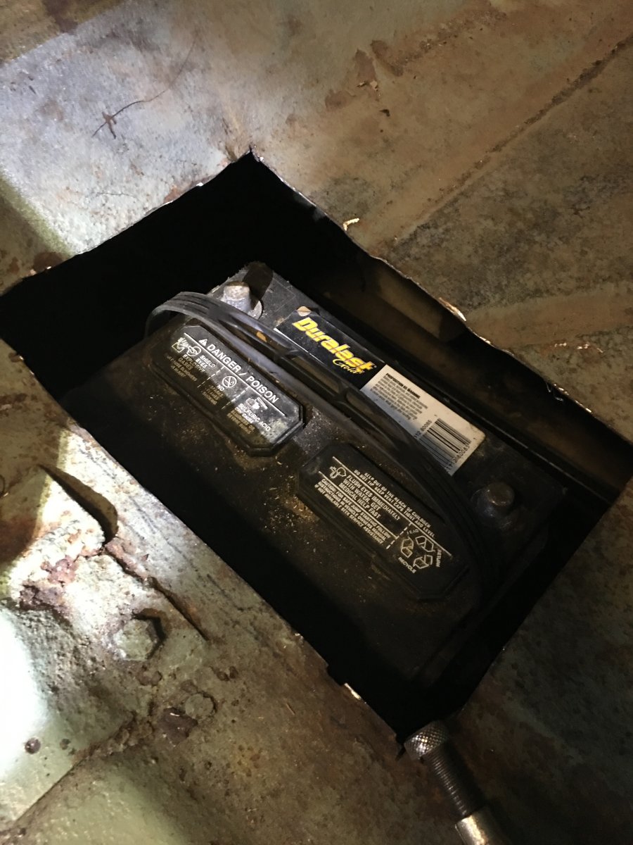

    268FFB7B-583E-48DD-826F-5571848CADB5.jpeg 76792B76-C374-42E7-8113-C710BE3152C7.jpeg 02F53B60-D206-43BD-86E0-F55B1EBEFED2.jpeg Ok, been working. This is the way i think i’m gonna go, under the rear floor. Between the spring and the pinion, in front of the axle.
    I have a crossmember and the frame rail to tie into. Going to either fab up the mount or buy one from Speedway. Then i’ll clean up the hole and fab up a gasketed cover that’ll live under a floor mat, most likely.
